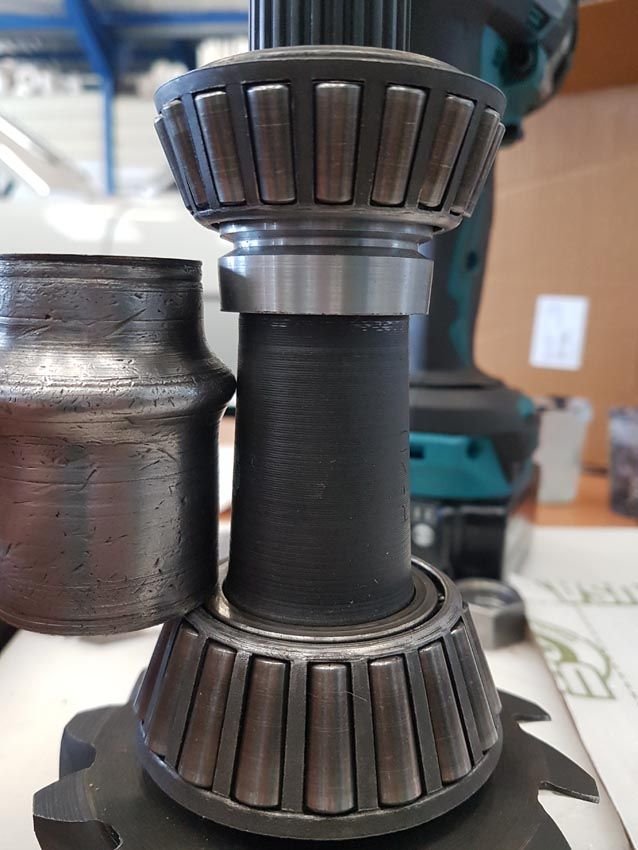

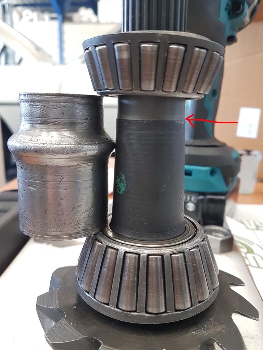

Received the bearting puller and it worked. Bearings are now modified so they slide freely to allow for testing and shim selections.
I have a concern regarding the crush sleeve.
A long one was originally on the pinion.
The kit from Yukon came with the same one and a shorter one. (3rd pic)
Now the smart sleeve from Ratech is short.
If I slide it on the pinion, it bears on a tapered section, not on a firm shoulder. (Red arrow)
So I am not sure on what to use there.
I also get a spare nut to make the testings. I removed the small dent that was punched on the threads to lock it but the nut still do not thread on the pinion. Some steel get shaved off the nut. Is it normal and part of the locking features of the nut? Both thread looks the same (16 Tpi) and didn't want to damage the pinion thread.
Asked Yukon but should not get a reply before monday now.
