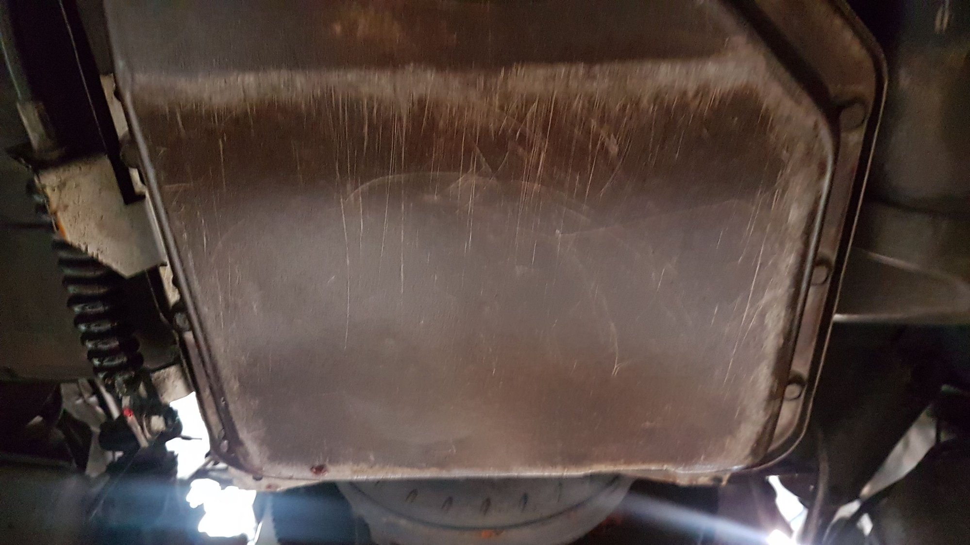

Well I guess a box filled with gears might well be a gear box. Whether it's clutch or automatically operated via a torque converter (I guess) do not change its gearbox condition.
And here is a picture of what I guess is an oil pan.
Ths leaves open my original question how do we change oil there?

You remove all the bolts around it. Pry it loose. Dump the transmission fluid out. While you are there change the filter. Get a new gasket. It probably came with the filter. Put in new transmission fluid. I don't remember offhand how much you put back in when changing the filter.
