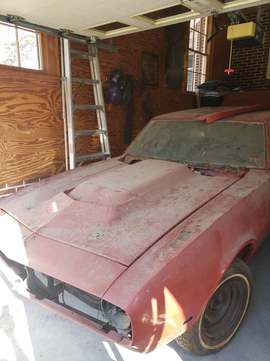

Pulled my 68 out of storage 40+ years afterand need to replace the clutch. Any guidance? Dont need anything too grand but dont want junk either. Looking at the Zoom Perfection Kit
at Rock Auto for $110? Good? Junk? Saw something on ceramic. Been out of the game so not sure about that? Thanks!
