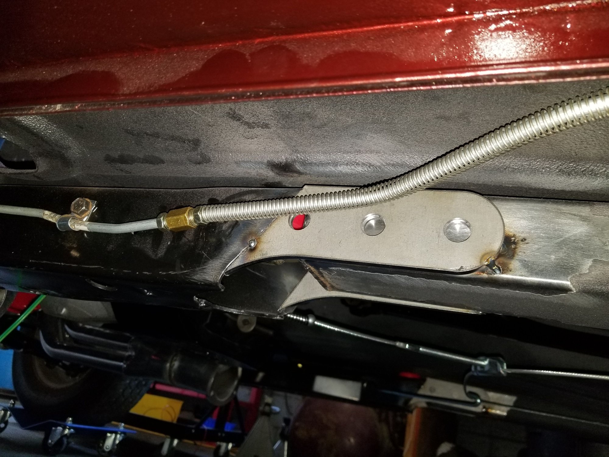

The front sub-frame was re-united with the cabin. As part of this process, frame extensions were installed, requiring a cutout of the floor pan, and welding the extensions to the rear sub-frame, the floor pan, and fish-plated to the front sub-frame. The fish plates are only tack-welded for now, as that process will not be completed until after the 100-mile break-in run has settled the chassis to a contented stance.

The final task will be to complete welding the inner and outer fish-plates. joining the frame extensions to the front sub-frame, followed by application of new finish over those bare-metal areas. Once that is done, I will provide final payment and the car will be turned over to me for an initial 1000-mile run. When I have put 1000 miles or so on Ricky, I will return for a total vehicle inspection, my feedback, and replacement of ALL liquids. And then, we fly!

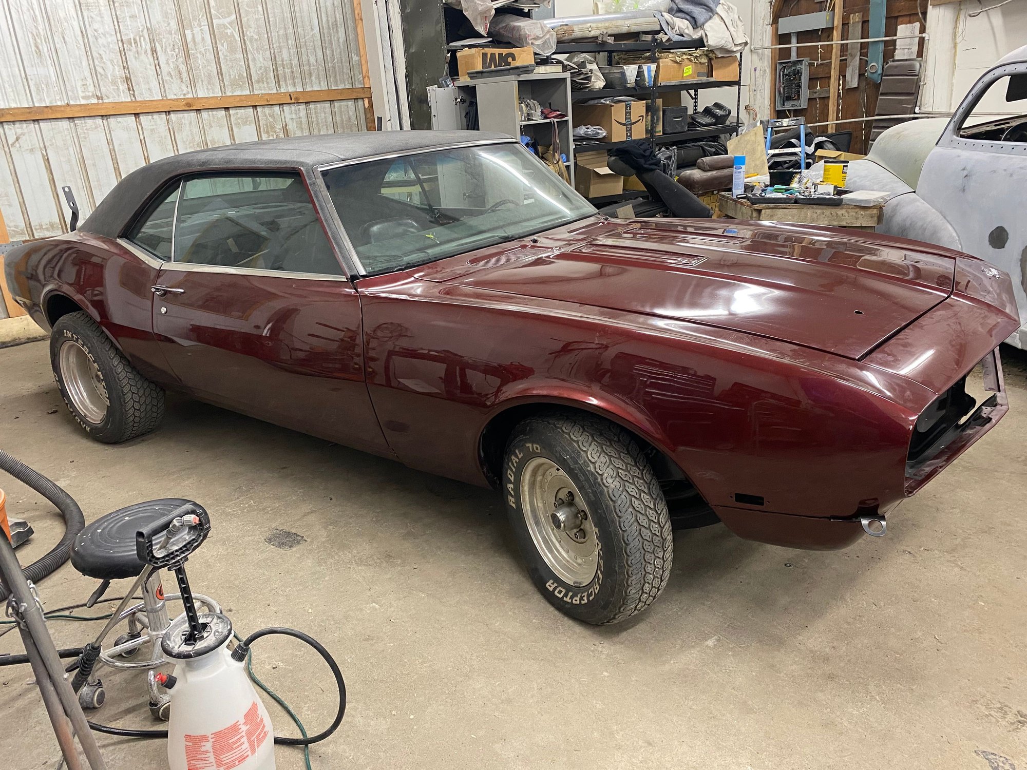

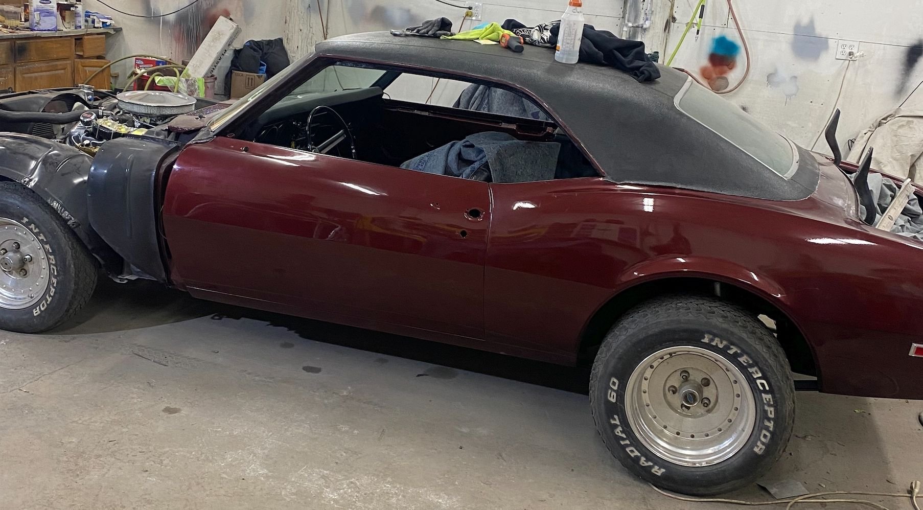

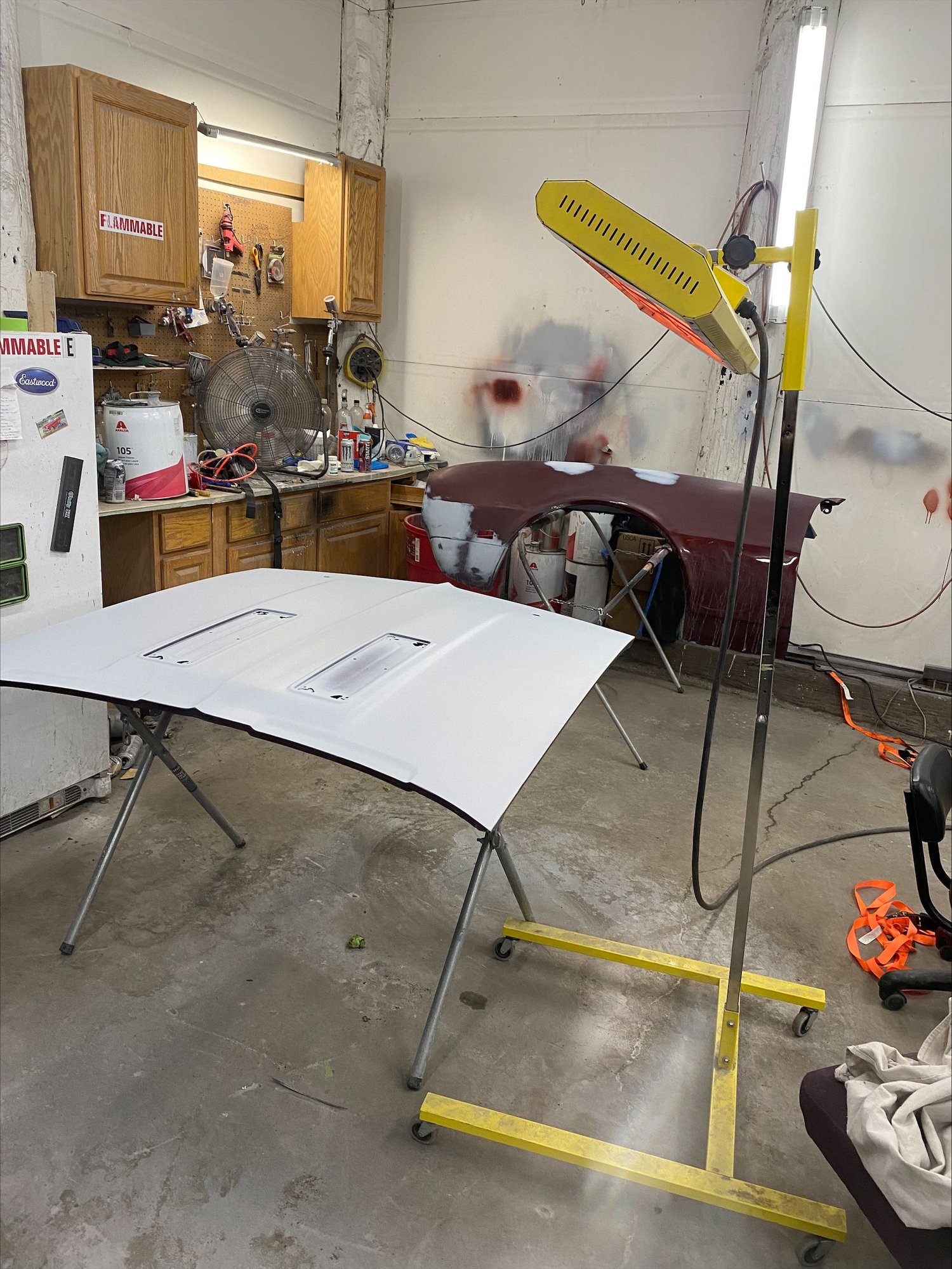

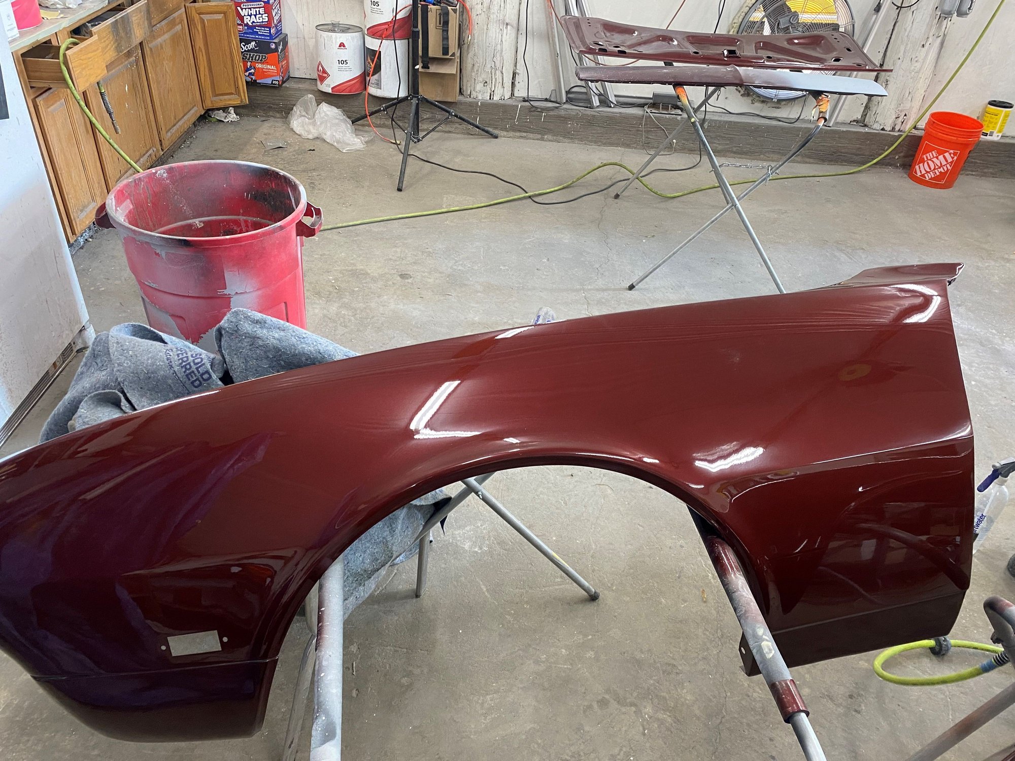

So, progress continues, but sometimes, it continues strangely. While color-sanding and buffing, Jerry determined that two small dents in the driver-side front fender needed to be fixed. Also, he determined that the hood, which was fully painted, was not sufficiently flat. Jerry stated that the hood is not only the first thing that gets viewed at shows (why he wanted the hood-to-fender gaps corrected), but is also what I view as I drive, so he wants it “perfect”. Therefore, he did a scuff on the existing new paint, sprayed a coat or more of high-solids primer with appropriate sanding, and a new application of sealer, base, and clear coat paint. Also, apparently there were issues with the spoiler. The passenger-side front fender, cowl vent grille, front grill header, and lower valence panel are now on the car, and look like this:
Meanwhile, the last pics I had of the hood and driver-side fender look like this:

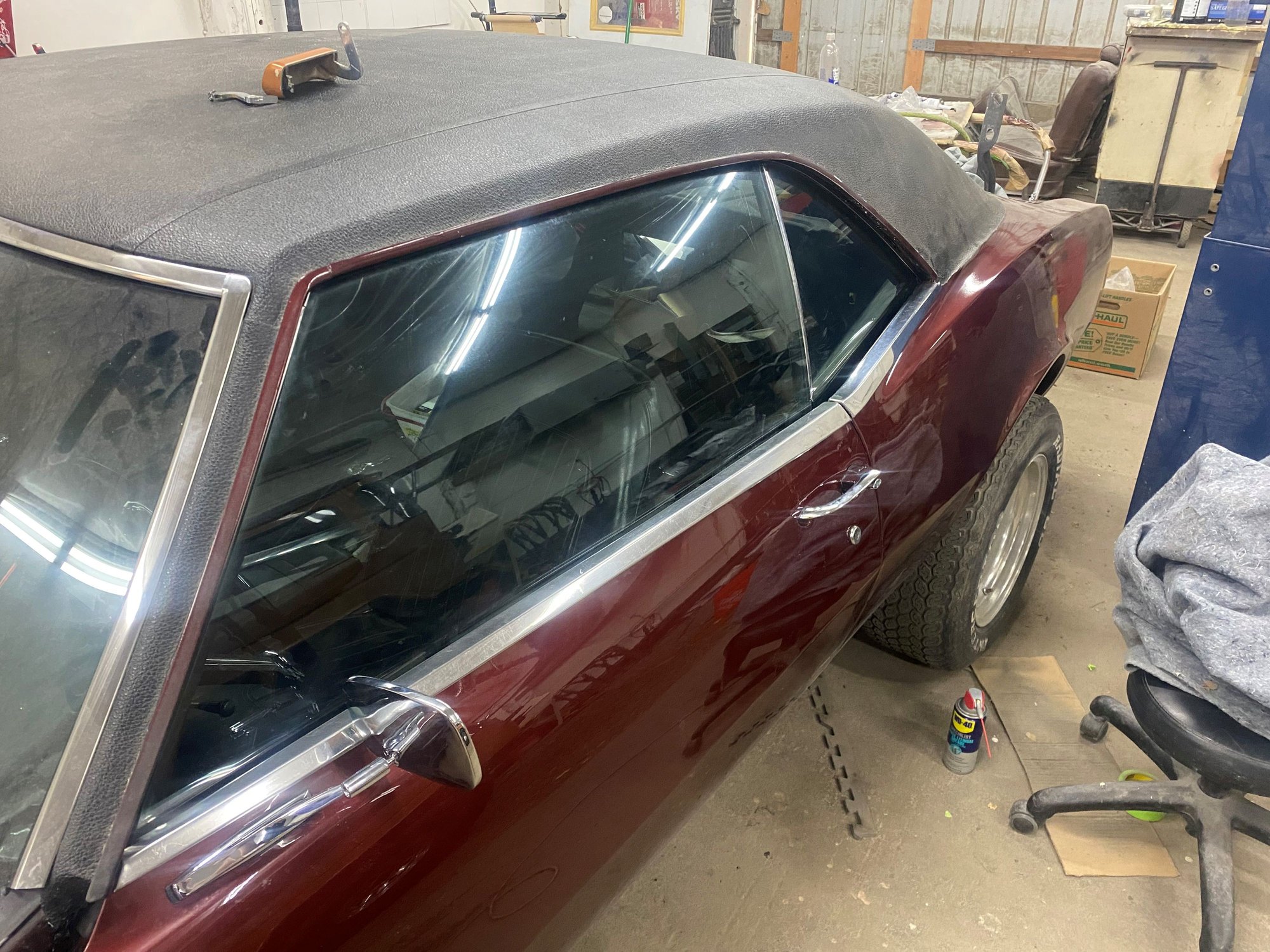

Last week, James installed all regulators and side windows (door and quarter), felts, and seals, and adjusted for proper glass to seal fit. These are the most current views I have:
So now, the only things missing on the sides are the chrome strip above the doors, and the chrome strip at the bottom of the vinyl. When we first started this project, I said I did not want the chrome strip often found beneath the door.
Hopefully, the new paint will be sufficiently cured to color-sand and buff this week, and the car can become complete for body panels. Boy, that would be a Christmas present!

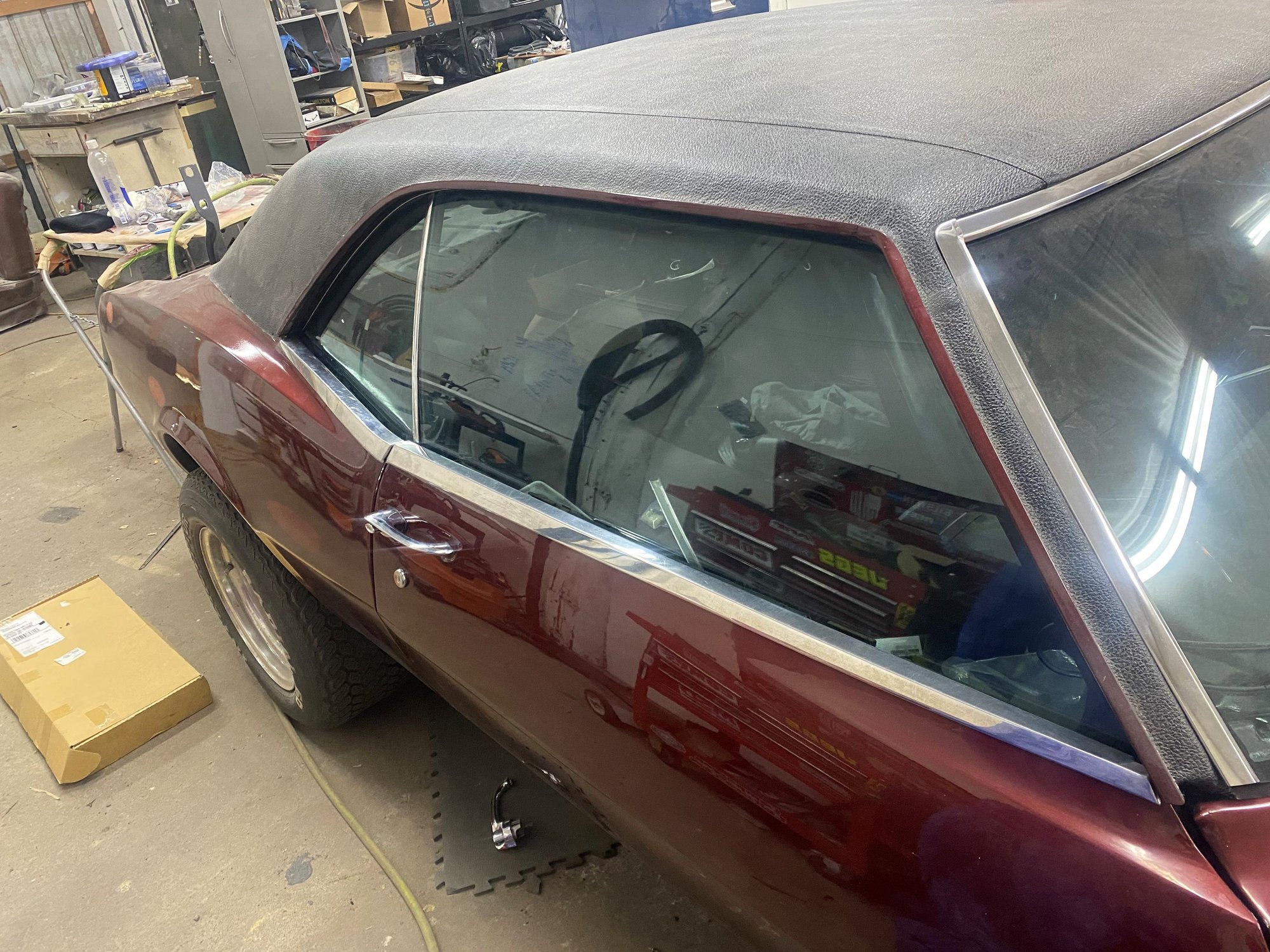

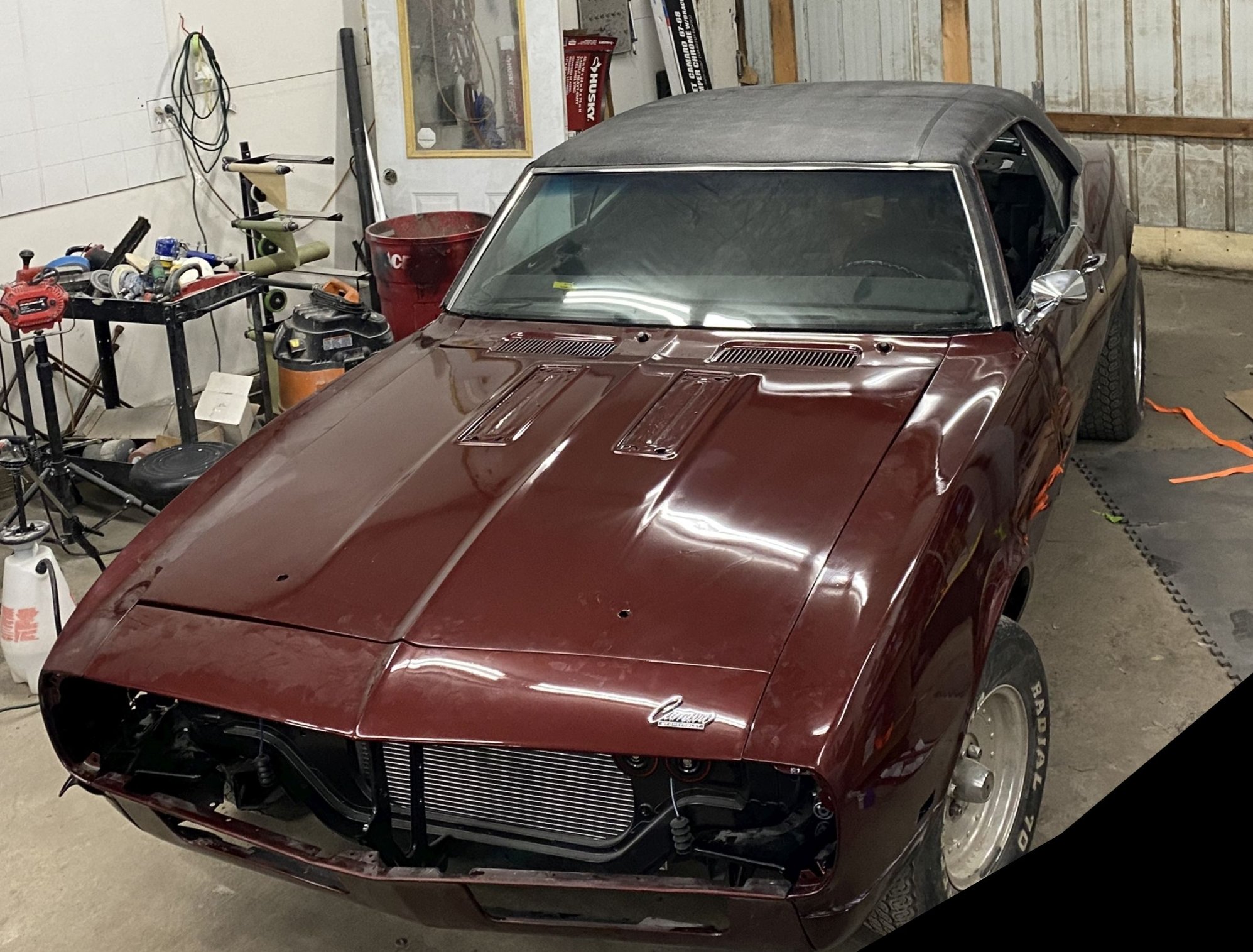

So, as we crept into the new year, extreme cold (for SW Washington) made it difficult to heat the shop enough to paint, so patience obtained, as we used to say. Finally, hood and driver’s-side fender made it through paint and color sand/buff, and found their way onto the car a couple weeks ago, leaving us here:
Note that the trunk lid is still not on at this point, and fenders and hood needed substantial tuning to get the gaps right. More time was consumed performing this dance of adjustments, but finally, this last Friday, we got there. All panels were happy and made permanent, bumpers installed, headlights and front radiator grill installed, all marker lights and running lights installed and wired, hood placed and its false vents and hood locks made permanent, and Ricky now looks like a complete auto. Friday evening, the guys sent me these two ‘art’ prints:
Oh man, too cool for school!!!
We are now working on relatively low-level tasks, such as wheel restoration, new BF Goodrich Radial TA tires, speakers, chrome strips along roofline, badging, AM/FM antenna and cable, ash tray, and glove box/door. There will then come a point where Ricky will be driven to Muffler Shop for install of 3” pipe, X or H cross-tube, Magnaflow mufflers, then to the alignment shop, and finally, the interior/upholstery sub-contractor. Once all known tasks are finished, Ricky will go through a Quality Assessment by independent and knowledgeable eyes, and any deficiencies will be corrected. Following that, the owners will put in around 100 miles of break-in, which will include calibrating speedometer. Ricky will go on a lift to finalize the fishplate connection between the front sub-frame and the frame extenders, and that area will be re-coated with bed-liner. It currently looks like this:
Jerry wants the chassis to “marry” with 100 miles of use before he makes this attachment permanent.
Once all this is done, we will settle accounts and they will hand me the keys. I will then put 500-1000 miles on Ricky and we will return for a re-torque of all critical attachment points, change-out of all fluids, and I can go play. And a good time will be had by all...

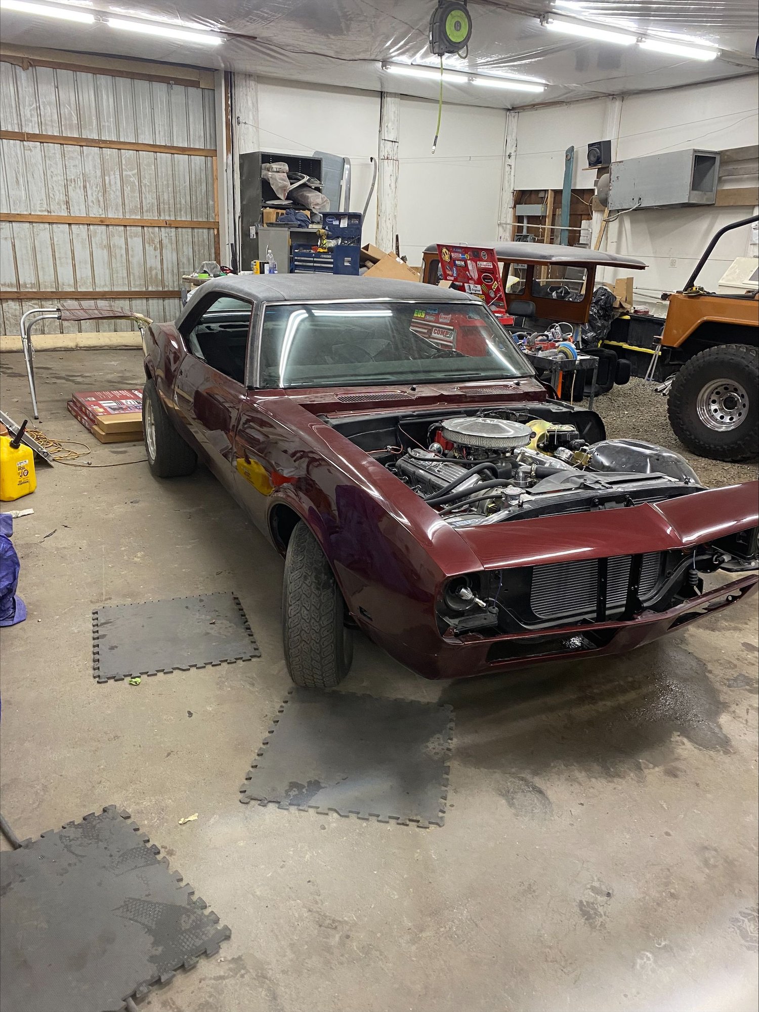

When I was younger, so much younger than today, the Beatles sang “It’s getting better all the time” and for this project, that is very true. Just don’t pay attention to John singing “It can’t get much worse” in the background.
In this last month, a lot of nuts and bolts found their home! For instance, body panels found that “perfect gap”, bumpers were added, passenger rear view mirror added, hood ornamentation and locks installed (the hood locks work perfectly!), and the list goes on and on.

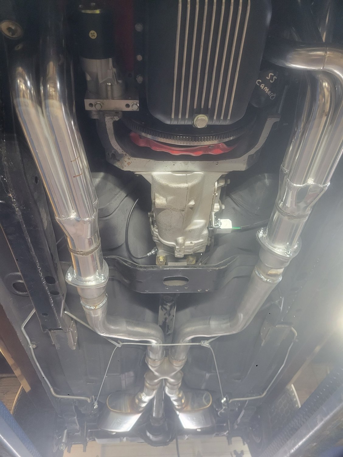

Ricky Camaro gained exhaust this week and it came out very well:
Wow, even the oil pan looks good! And oh, those steel-tube headers… The muffler-man was even able to use X-pipe cross links rather than a simple H-pipe. Way cool!
Ricky was driven to and from the muffler shop. I’m thinking on the way there, people probably noticed, with the big block’s exhaust just dumping out the collectors of the Hooker headers. Bryson reports that the clutch feels smooth and strong, and the Muncie was flawless. We unfortunately had to exit the mufflers with 2 ˝” tube, which therefore adds some impedance to full flow of exhaust. If it turns out to be noticeable, I have a plan to fix that, by fabricating 2X4 box tubing from muffler outlet, up and over the axle and down between the spring and body panel. For now, that last section looks like this:
Right now, the carburetor and distributor are undergoing adjustment to bring the engine into tune. In the immediate future, the Centerlines get buffed out, BF Goodrich TA’s installed, and wheels aligned. Somewhere in there, a hundred miles or so of driving occurs for a shakedown cruise. Then he goes to the Upholstery shop where the inside becomes as fine as the outside. Those guys did the vinyl roof some time ago, and did not want to use the plastic clips that came with the kit that hold the bottom trim, leaving the vinyl project unfinished. They ordered in stainless steel versions, so they will install the trim at that time. When Ricky comes back from interior being finalized, he will revisit the body shop where any damage to the paint will be fixed, and the frame connectors will be final-welded to the front sub-frame and coated with bedliner. Somewhere along about there, I will trade a few more dollars for a set of keys.
Man, I am getting so jazzed!!! What a great way this will once again be, to get from Point A to Point B in style…

Headers look great,look to be stainless steel? What make?
I spent large on mine (American Racing) ,they're stainless as is the whole system.
6 years later they still look like new.
