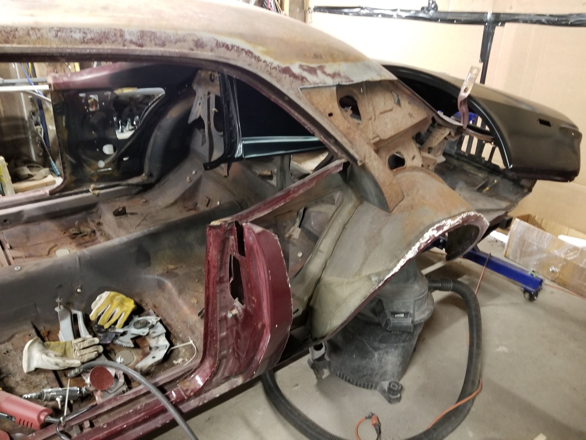

Anyway, Ricky Camaro left my home one day a few months ago on a hauler, and commenced tear-down. Once the front fenders were removed, it became obvious that this car had sustained MAJOR damage prior to my ownership, artfully concealed but now revealed… The front subframe was no longer a rectangle, but more like a parallelogram, both horizontally and vertically. Also, rust was everywhere and had done me dirt, literally. So, the journey began. At one point, it looked like this:

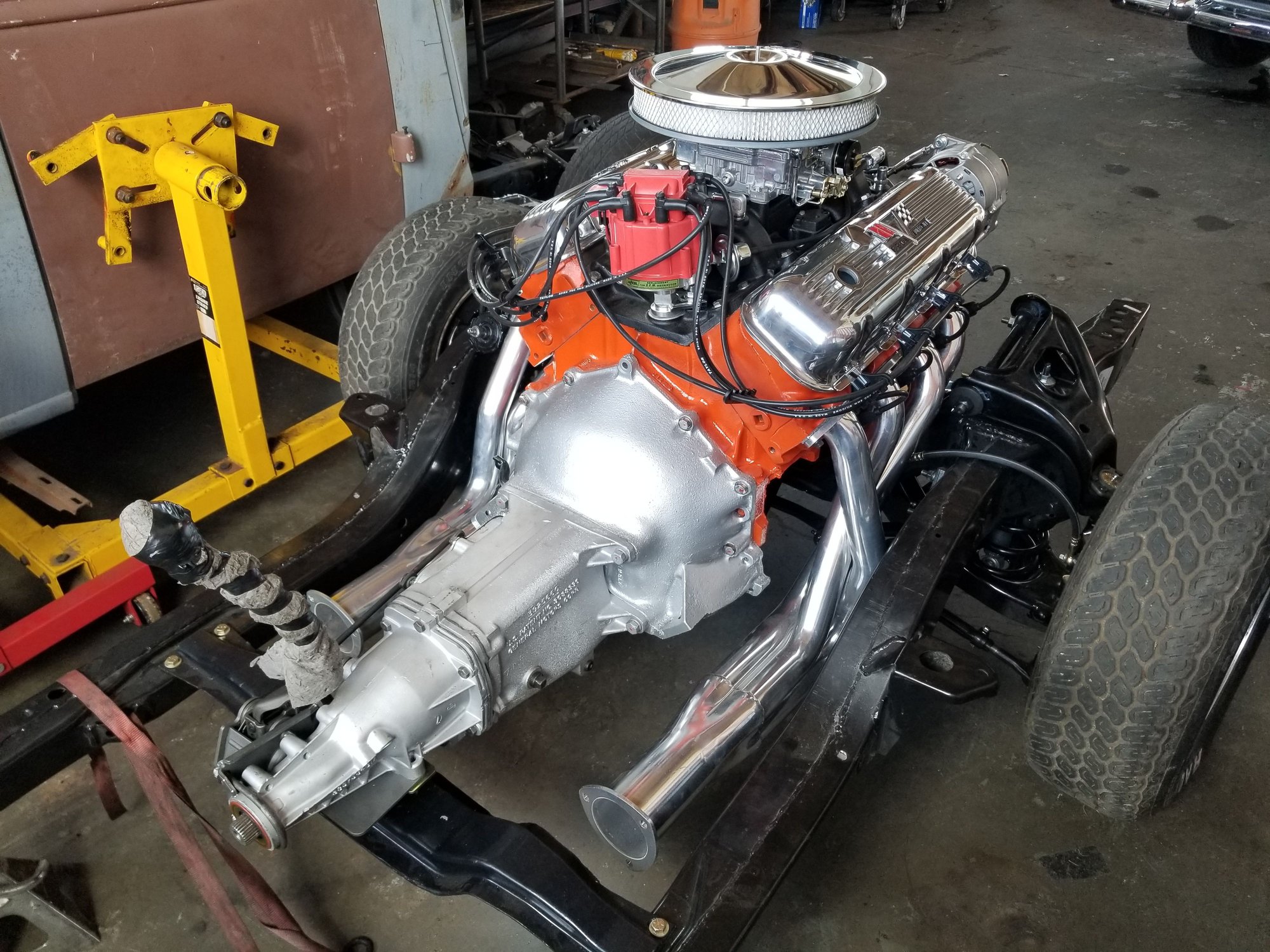

I’ll continue this story with intermediate details if there is any interest, otherwise, I’l just post further progress. However, I’ll at least include a picture of the subframe below, which is now populated with new control arms, new disc front brakes, and fully reconditioned power steering box and steering gear. Also, parenthetically, we added an Eaton Detroit Trutrac differential and new Ring ad Pinion at 3.42. We’re having fun now, sports fans.

Man that's going to be a great car,seems your resto guys really know what they're doing but I'll mention it anyway.
Not sure if it was the motor mounts I used or that's just the way it is but when I swapped in a 427 to my '69 I had to do a little hammer work on the firewall for clearance of the distributor since I used an Accell dualpoint that was a bit bigger around than the stock GM dizzy.
That HEI is a lot bigger,I discovered the problem when I got on it hard and the motor torqued over enough to break the dist. cap.
Back then it was just a hotrod and first gen Camaros were still dirt cheap so putting a little BFH on the firewall was no big deal.
Anyway something else to take note of. Looking forward to seeing the finished product and entirely envious.

Oh great. I was just worried about whether air cleaner would clear the 396 hood. Now I have firewall issues to worry about... Ha Ha. These guys will do whatever it takes, and we should know in the next week or two, when they install the front sub-frame and extenders. The deal is, this car is in no way original, although original in intent. If they have to cut a notch out of the firewall to clearance the HEI guy, so be it. That mod will in no way effect my enjoyment of the ride, and maybe one day I'll swing by Yacolt and remind you how magic a 1st gen ride feels. "Fundamental" is a term that comes to mind. I can remember driving it down I-5 at 70 mph, and the steering wheel was vibrating in my hands, dancing to every variation in the road, the 327 steel tube headers and glass packs were singing, and I was saying to myself, this has to be the best car stereo ever made. And I was on a stupid freeway, not speeding, and yet having an ADVENTURE. Now, we move up to 396 big block joy, Hooker Headers with FlowMaster F40 series cans on 3" tubes, and oh Lordy. Someday, when my son inherits this car (if it survives me) and assuming there's still gasoline around, he'll have the same goofy grin on his face. And you and I both know the joys of Washington and Oregon back-mountain roads, and how they're made for us to go play. God Bless the Pacific Northwest!!!

They did nice work on the quarter panel. Was there any rust repair need when the ragtop was removed?

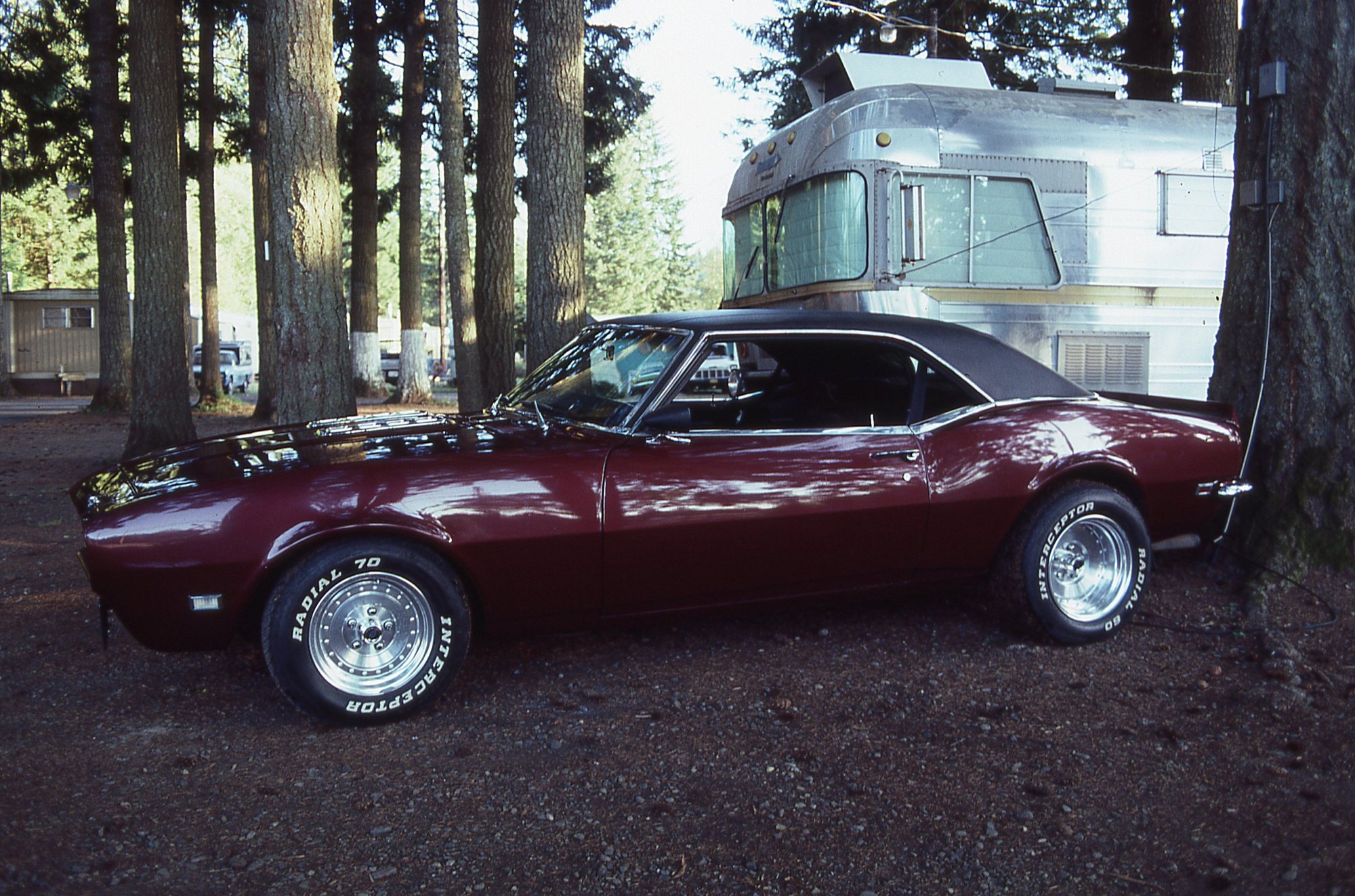

Well if you get down this way I'd be thrilled for a ride in it to take me back to the good old days and as stated we have some great rodas up here.
I remember the steering feel of the old '69,no power steering so you felt every little thing and oh how I loved the rumble of that Rat motor.
Here's an old pic the old beast just after I dropped the rat in when I was just in my early 20's,the stock hood wouldn't close so I had to get first a scoop and later a cowl hood.
That and a picture from my place,we're on 5.5 acres up a dead end road a couple miles out of Yacolt town, come on down.

Only surface rust on the roof! I got lucky there. The reason the roof is black in the picture is that Jerry worked on it quite some time ago and went ahead and put two coats of sealer over its ospho/etch primer/DTM primer to lock out moisture. The rest of the car was still drying from the sixth coat of DTM (Direct-to-Metal) Primer when I snapped that picture. He let it cure over the weekend and started final block-sanding on the following Monday prior to the rest of the car getting its sealer. Finally, he went ahead and sprayed the three parts that make up a complete Lizard Skin application to the non-painted portions of the interior, and I think it's about to go across the yard to the restoration shop to regain its sub-frame, steering column, and rear end/springs and once again become a roller.
