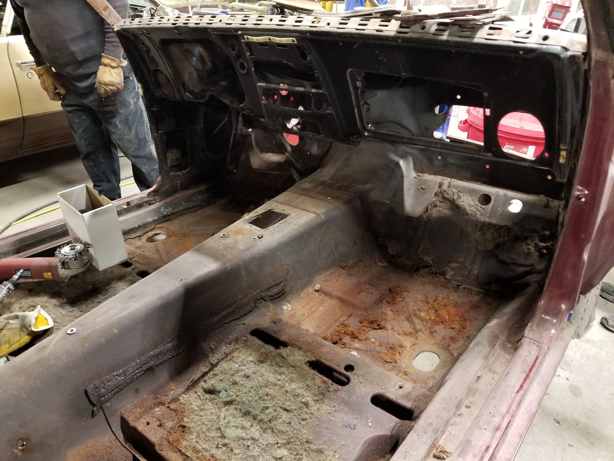

Oh hey, Turbo86, a further update on "those two holes". You thought perhaps the body shop guys might have made these holes for access purposes (entry #86). I was just going through some old shots that included initial teardown that was performed, at the point in time when we were determining what REALLY needed to be done to make this car wonderful again. Here you can see that these holes already existed, and were almost certainly original. Not sure why yours doesn't have them.
This shot also clarifies why the entire floor needed to be replaced. The creation of iron oxide was pretty complete in this area, and I was told a screwdriver could be poked through without effort pretty much all over the foot area.

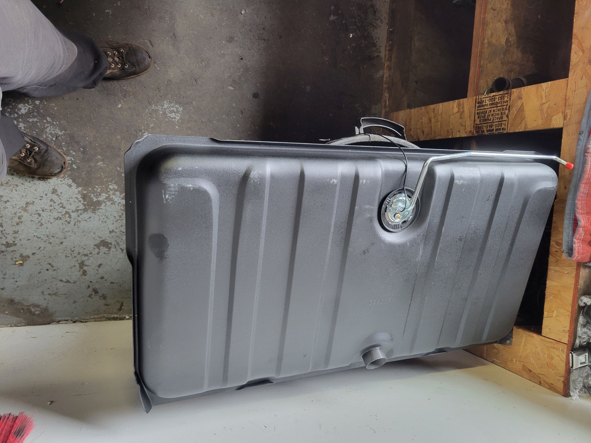

Another week, more progress. Brand new fuel tank is now fully coated, new sender installed, and scheduled for install to car this Monday. At that point, fuel system is complete, tank to carb.

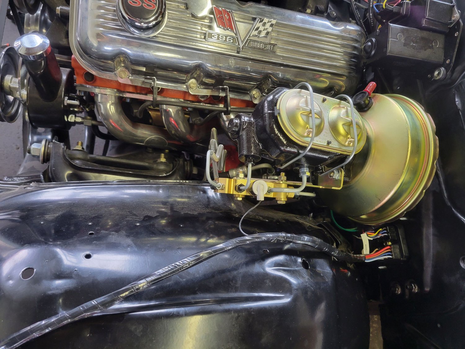

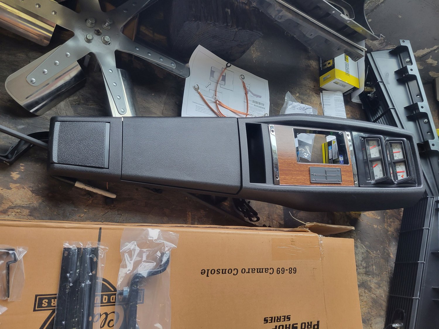

Here is a shot of the new console, new flex fan, and new front grill. Oil pressure line is going to be copper, rather than the nylon line supplied, for increased durability.
And a great closeup of the master cylinder/booster installed and plumbed.

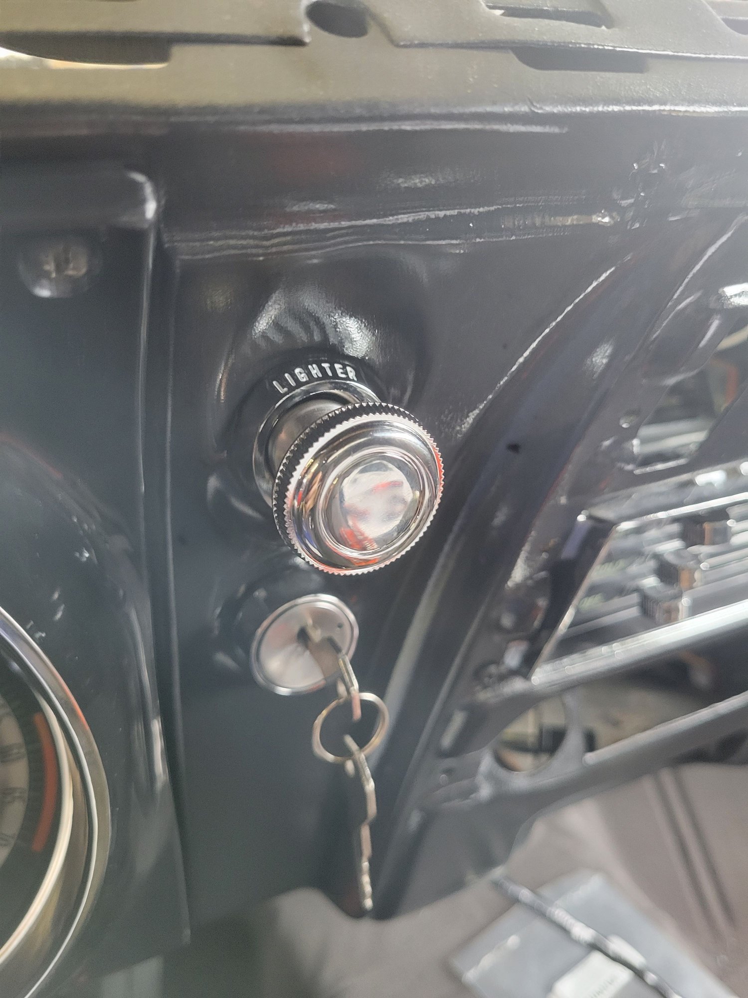

Finally, a nice shot to remind us all how the times, they are a'changin'… Don’t see many lighters on dashes these days (or maybe, surveying current events, 'daze').

Very interesting on those holes. My car has almost no options, so that would play a big part in not having the holes. Maybe someone else can chime in on the holes and there purpose. I would assume they have to be plugged up?

I've got some feed back from another forum and someone mentioned battery cables from the rear. Did your Camaro have the battery in the trunk and cables ran up the interior and through those holes?
Either way, you need to have your guy plug those holes up, if you have not already.

So, 'negatory' on battery in trunk in the past. However, the future is a different story, as there will be a battery there impending, to power subwoofer amp and main amp per my earlier conversation about sealing the trunk with high-density particle board and solid maple. However, that battery will have a fused positive lead (#4AWG) from a battery isolator in the engine compartment and a negative lead from the battery-return common bolt on the engine block, and they will access the wiring loom tray on that side, but not via these holes, as far as I know. When you first enquired on April 8, I queried Bryson, and here is his answer: "The holes you referenced are access points that receive grommet seals, easy answer there!" So, yes they will be sealed before the carpet and other coverings go onto the belly pan/firewall.
