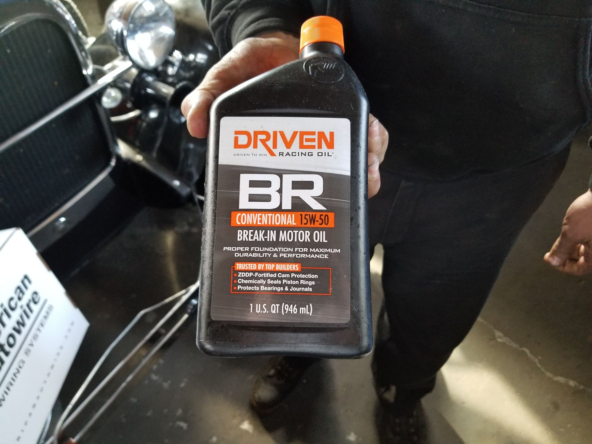

I was introduced to "Driven Motor Oil", specially formulated for older hot rod engines.
Visiting Driven’s website (www.drivenracingoil.com), I was informed that modern motor oils are formulated to protect catalytic converters, while they say their oil is formulated to protect flat tappet camshafts. Also to maintain oil-film protection for cold engine starts on cars that are at rest for long periods between runs. In any event, I am apparently a captive audience as I was told that Britco, the local engine builder ONLY warrants their engine if ‘Driven’ Break-in oil is used initially, and then Driven HR1 is used throughout the warranty period. After 5K miles, the engine is considered broken in (surfaces honed) and I can switch to their synthetic oil and extend from 3K oil changes to 5K miles, but still, I must use Driven oil.

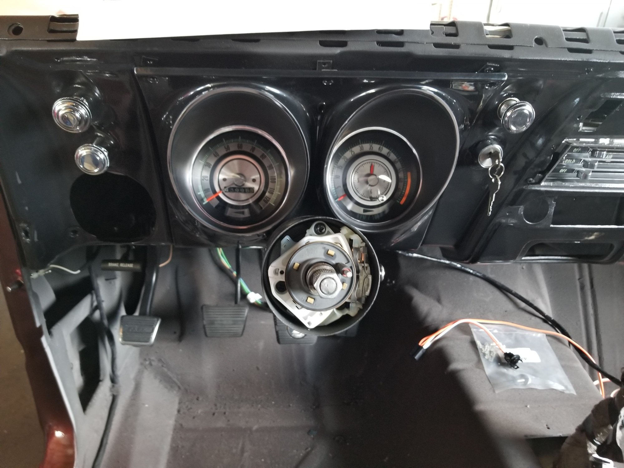

Dash is mostly done, with steering column COMPLETELY rebuilt with all new parts internally. Also, new ignition switch, and the fuse block is still old-time glass fuses. Wonderful news for me, as it justifies my huge collection of fuses I’ve been lugging around for all these years.

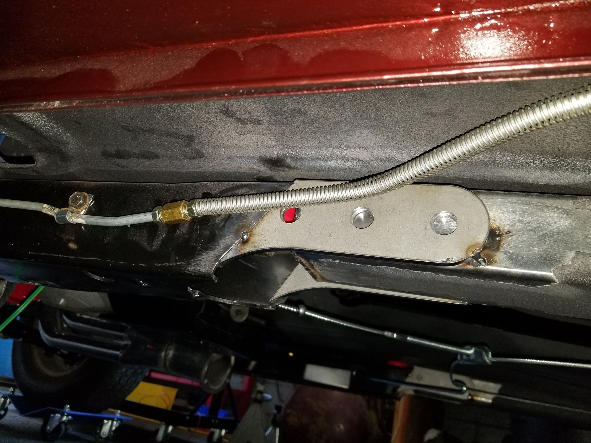

I asked if the sub-frame connector has been welded to the sub-frame, and he said "sort of". He elaborated that the fish-plate tabs were tacked in but they were advised to leave it for awhile to let the body "settle into place" before doing the finish weld, so it came out looking like this for now:

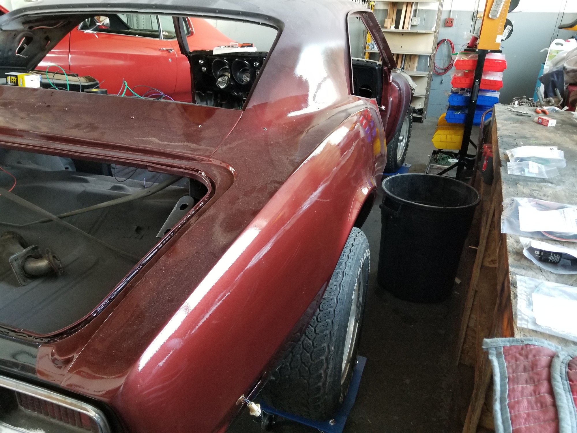

You will note from this view of the paint that Ricky has not yet been wet-sanded or buffed. That will happen when he returns to the body shop to gain front outer fenders, hood, doors and trunk lid. They will also finish-weld and re-coat the frame connectors once the car is at full weight, to match the rest of the pan underneath.

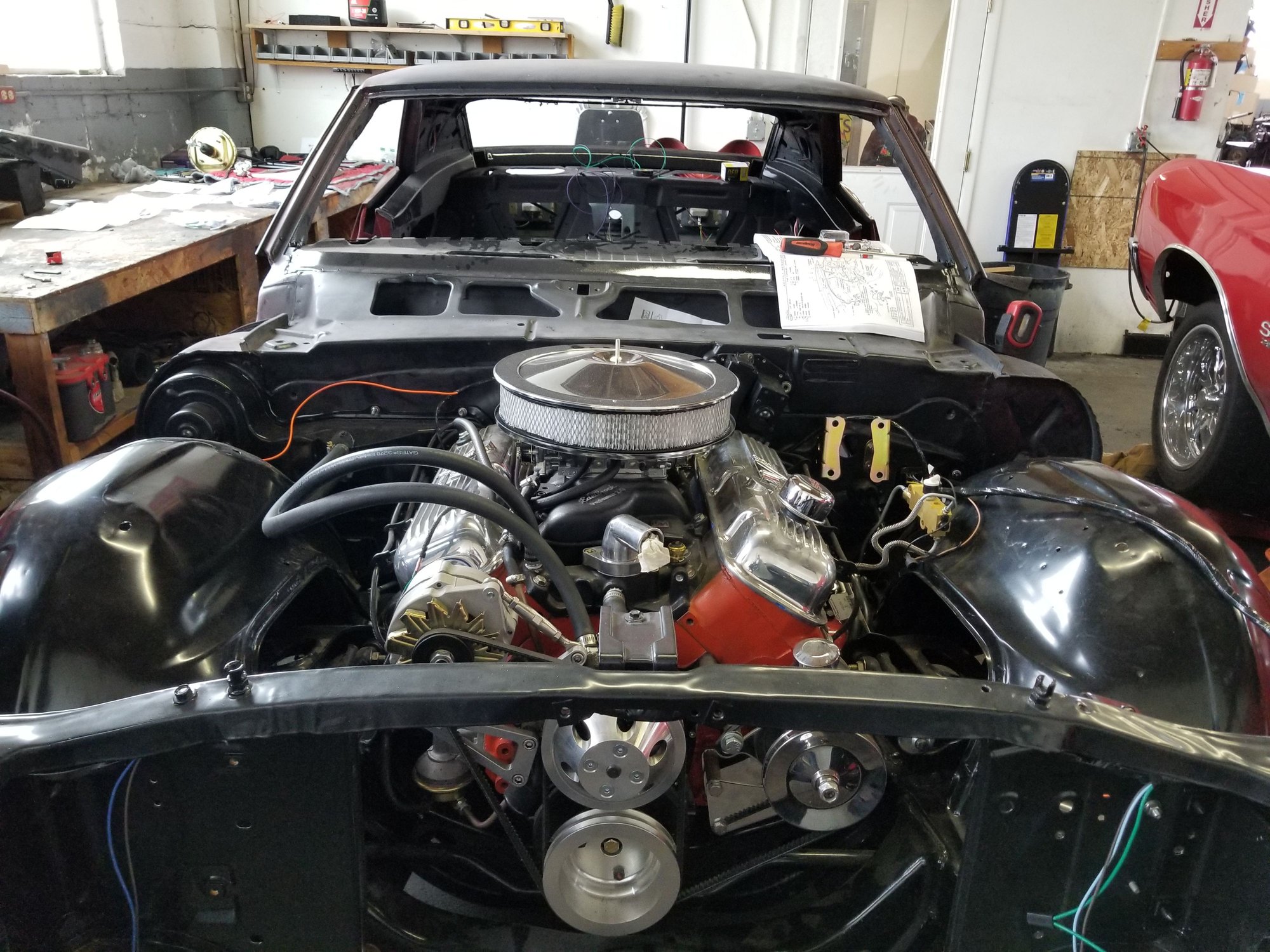

I took a number of pictures to augment my memory, and I especially like this one, taken through the radiator air inlet area:
It appears I like these shots that can only be taken during construction.

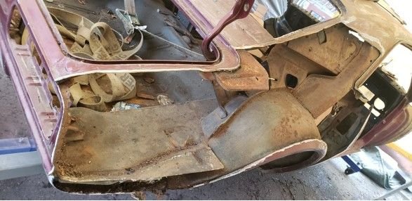

And what that meant to get to here, just in body work: new rear quarter panels; new inner fender on passenger rear; new front inner and outer fenders, new floor-pan from front of trunk to bottom of firewall, along with new seat foundations, new front sub-frame with new control arms and ball joints top and bottom, both sides; and extensive repairs to firewall, and to windshield mounting surfaces front and rear.

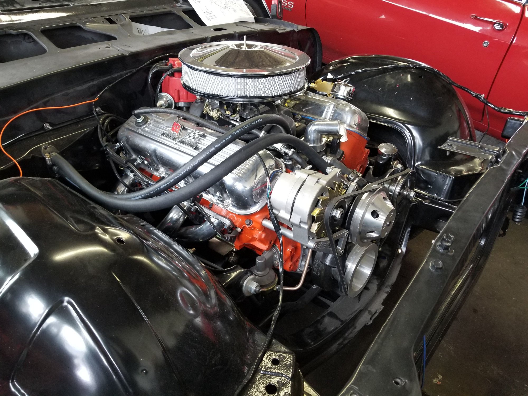

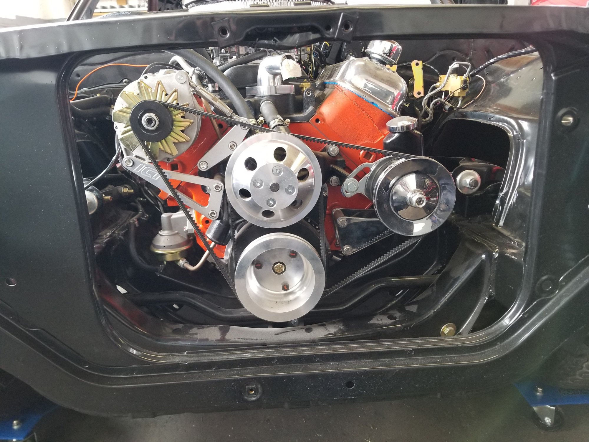

And the list goes on and on. Here, for instance is a really nice power plant, designed to help your heart beat from chest vibrations:
And, from straight on (note the hood lock receptacles, for the round-key hood locks):

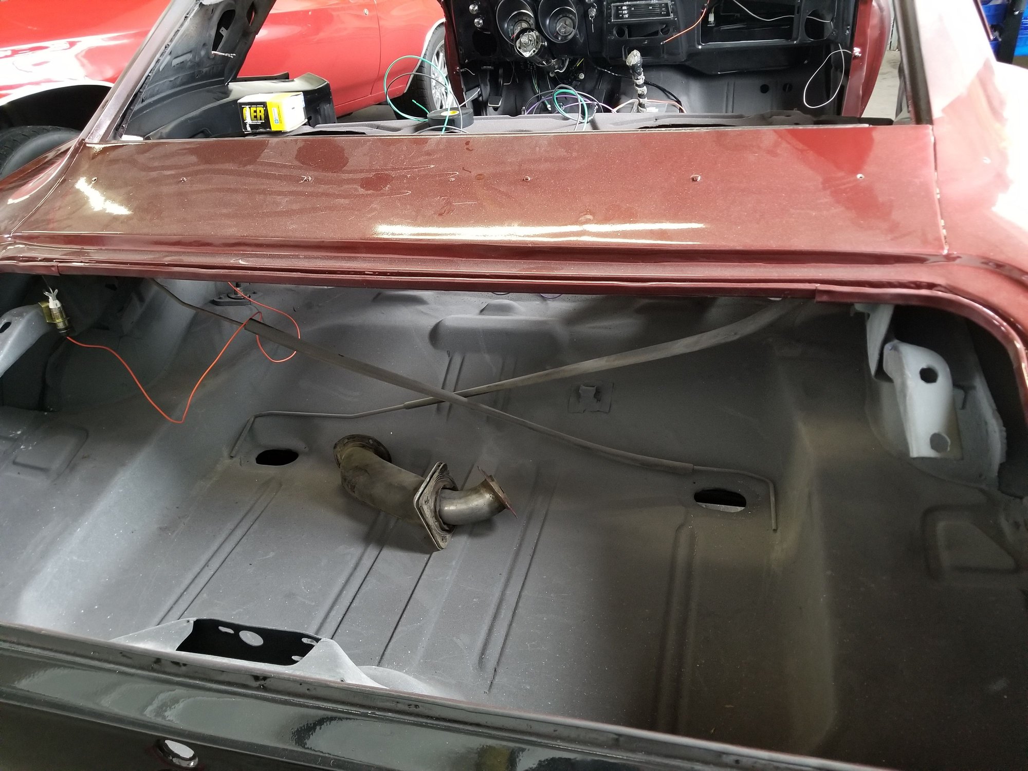

Here is a nice shot of the rear section of the car. You can see the holes that anchor the transition from vinyl roof to natural paint that takes place via a chrome strip:
For review, see the final picture in entry #90: a side shot where that transition is clear to see.

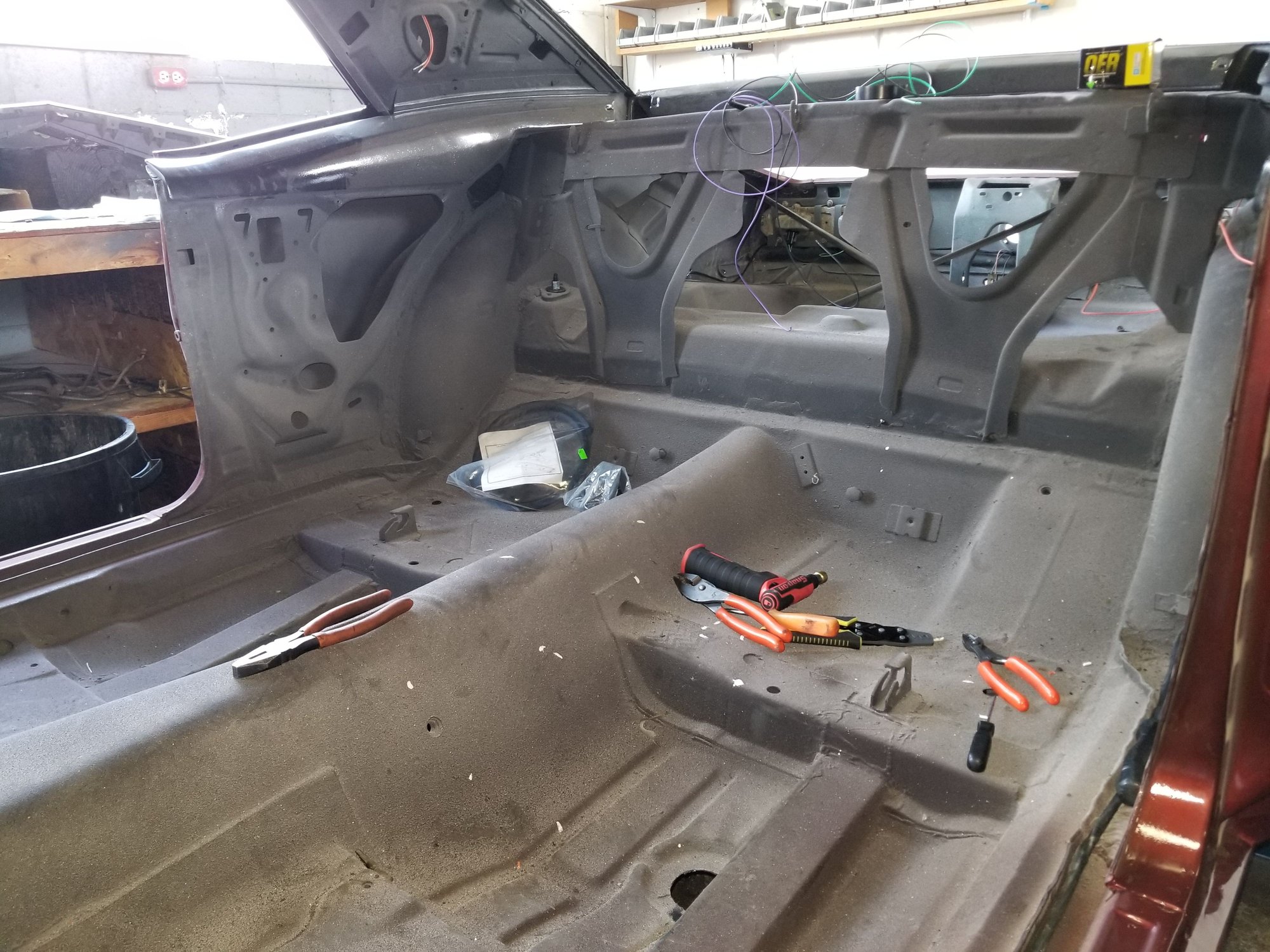

Here is a nice shot of the rear interior, where someday, that center area will be occupied by a 10” sub-woofer, firing into the seat back from the trunk, and mounted to a layer of ľ” high-density particle board, covered by ľ” maple boards, the whole isolating the trunk area from the cabin sonically. That same combination of boards will extend across the top around the two 6X9 speakers. Opening the trunk lid will reveal, mounted on the maple, the sub’s power amp, the main speaker’s power amp, and out on the floor of the trunk, a second battery to power them. As I have said before, and quoting the Firesign Theater, “Fully equipped with a complete line of extras, designed with your mind in mind”. And all helping to add a little weight to the rear for ‘good grip’.

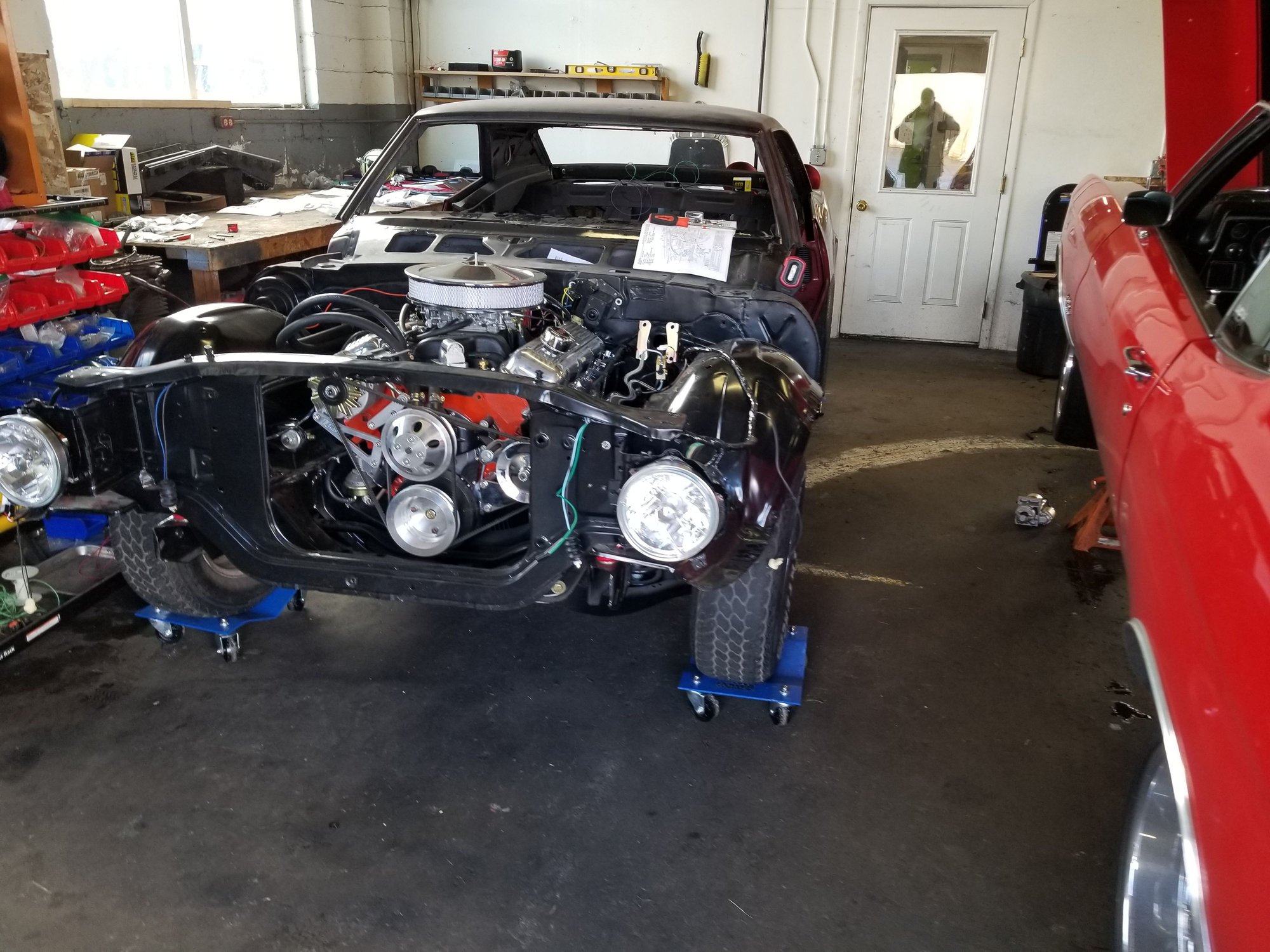

And so, here is a good overview shot of the package as it awaits front fenders, front grill-work, hood, rear deck lid, and doors. Plus other stuff.

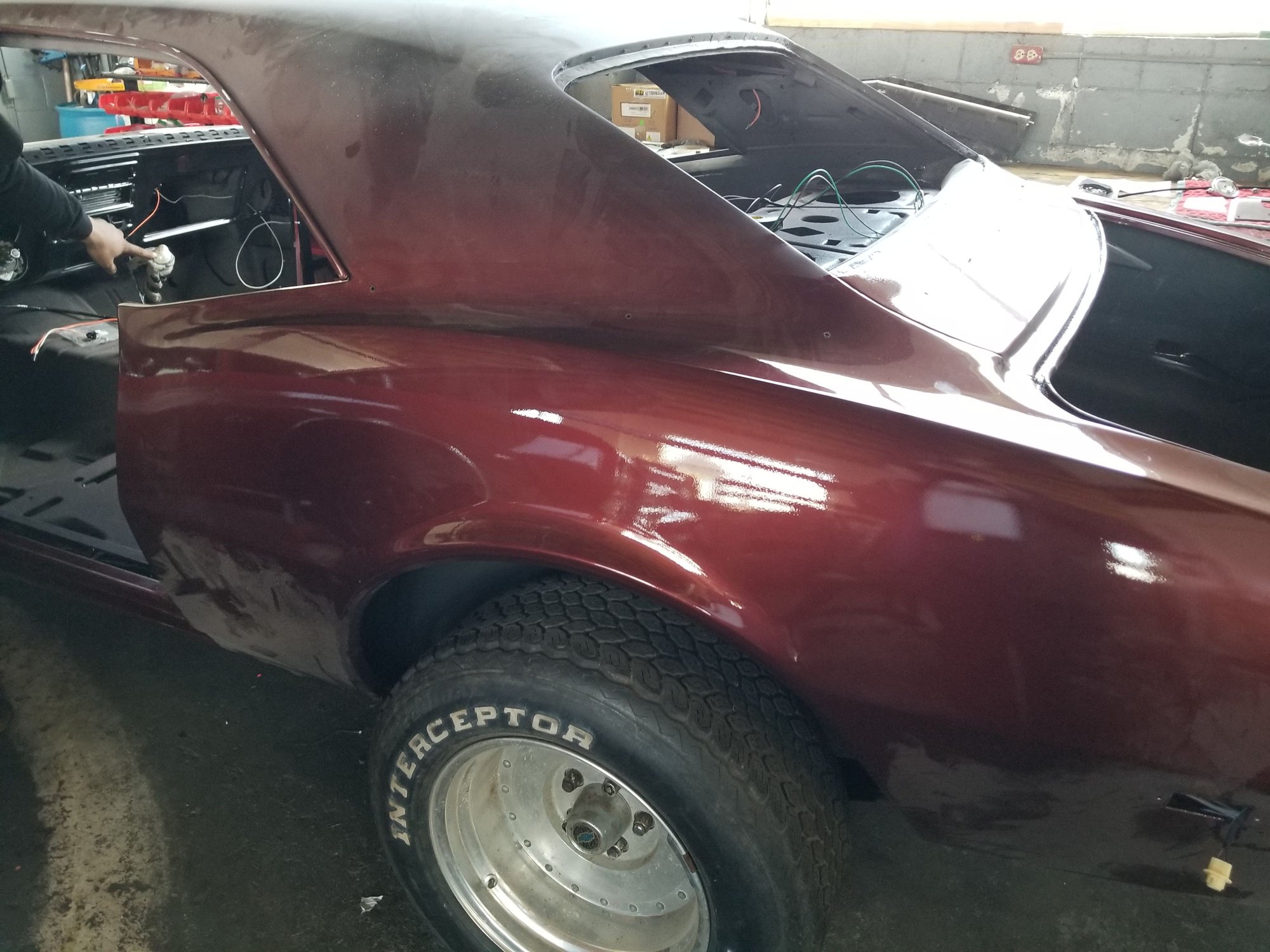

Because of the various issues with painting in the winter, and oily hands, here you can see roughly 12 layers of base coat, 12 layers of clear coat, with clear coat thickness diminished by sanding between each of the 4-layer applications over time. And it hasn’t even been wet-sanded or buffed yet. Oh man…
And the passenger-side:

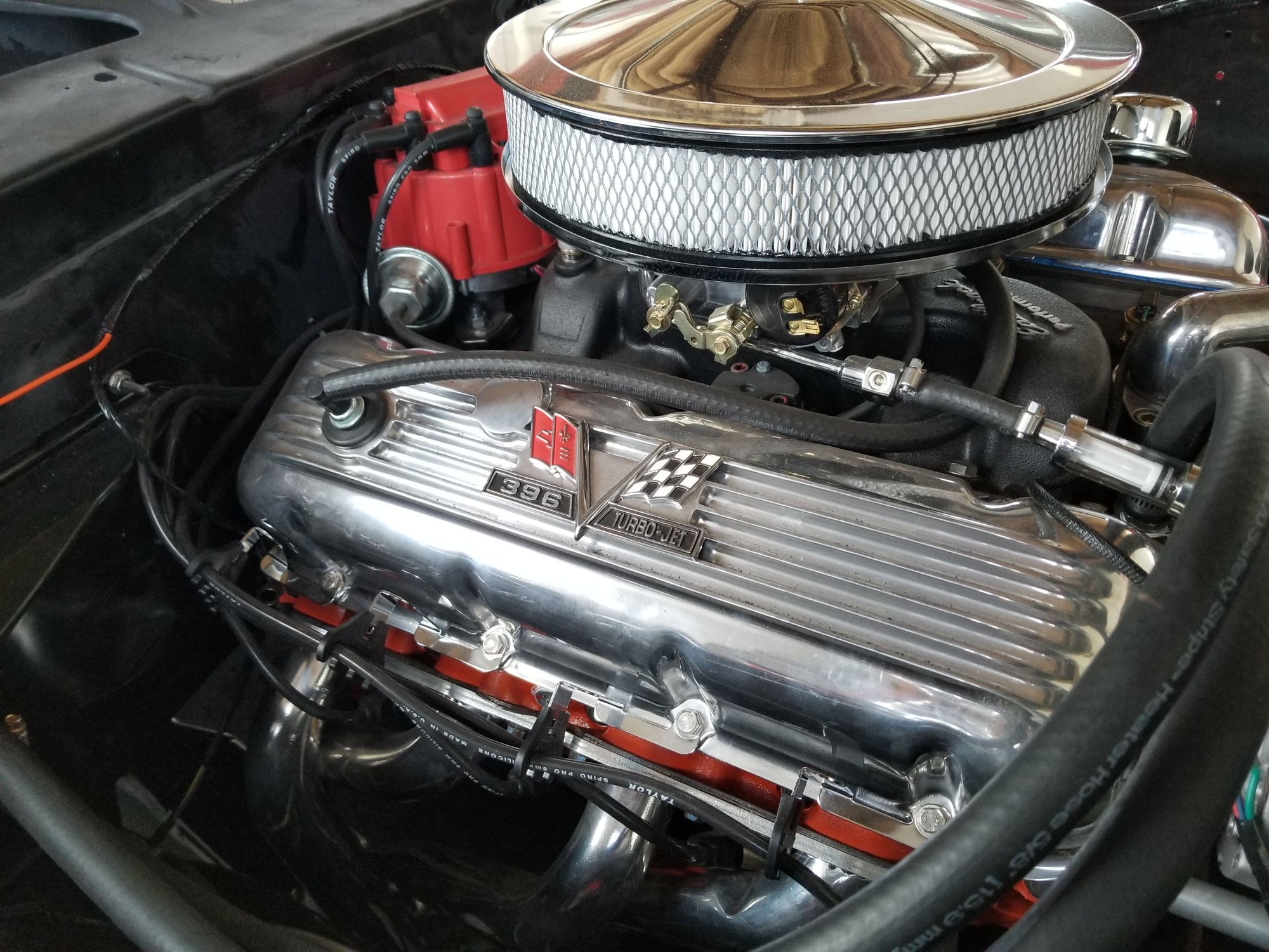

Ahh, 396. What a great number! And kudos to the marketeer who thought up “Turbo-Jet”.
I was told that if the headers over-heat the plug wire ends, they have ceramic ends in stock to replace these high-heat versions. However, these Hooker Headers are ceramic-coated and run fairly cool, so they don’t anticipate a problem.

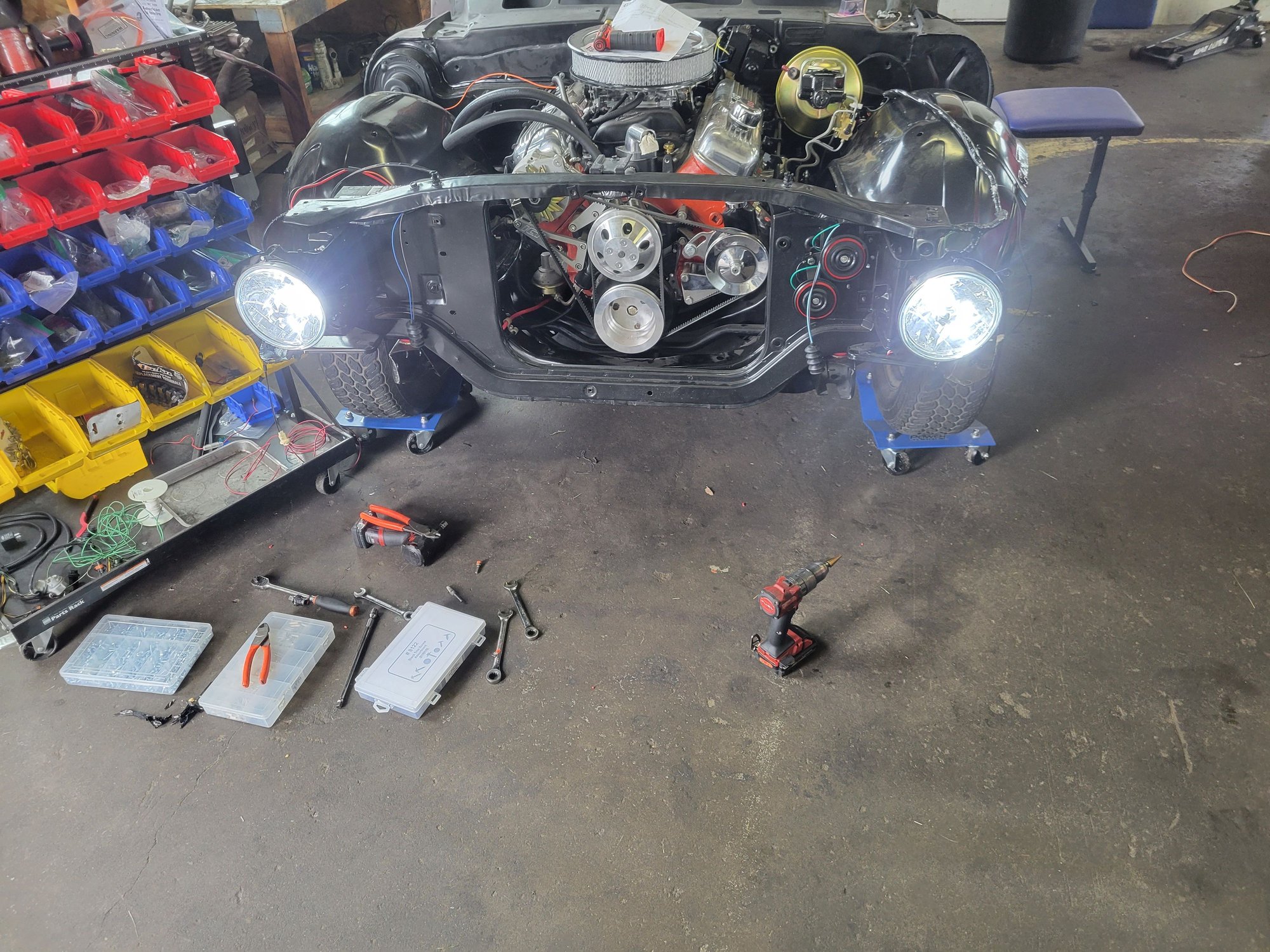

Anyway, here's a small update on Ricky Camaro:While most of the shop's attention is focused on wrapping up the '70 Chevelle and getting it out the door, Ricky has had some degree of progress, as follows: Electricity now flows throughout the car, by virtue of the battery installed, and some systems are proven fully functional. These include the clock in the brand new Tik-Tok-Tach, all lights, including headlights, tail-lights, marker lights, dome lights, dash lights, and reverse lights (with EVERY light being an LED), wiper motor, heater blower motor and controls, master cylinder and brake booster installed and fluids filled, horn installed and functional, starter wired in and able to turn engine over via dash ignition switch, and distributor is now timed for initial start. It appears the only things preventing engine start/break-in are radiator install, fuel tank installed and connected, and console/gauge install, with all gauges there installed and tested. The good news is that the radiator (& supplies) fuel tank and console are all new and in house, just waiting to go onto the car.
