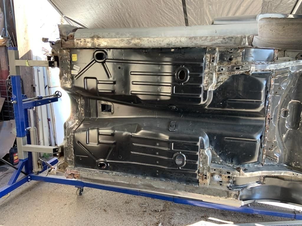

Darn, when you're right, you're really right. Everything looks good here:
But from this angle, not so much...
So, noting the red mark on the firewall, that is where it is now cut out and a 1" deep cup is being welded in, then painted. This next week the car FINALLY become a roller! I made the mistake of saying, at the start of this project, "I would rather have it done right then done fast" and this being a very small shop, in a fairly small town, Ricky gets stacked up in queue. But that's fine. It is getting done right!

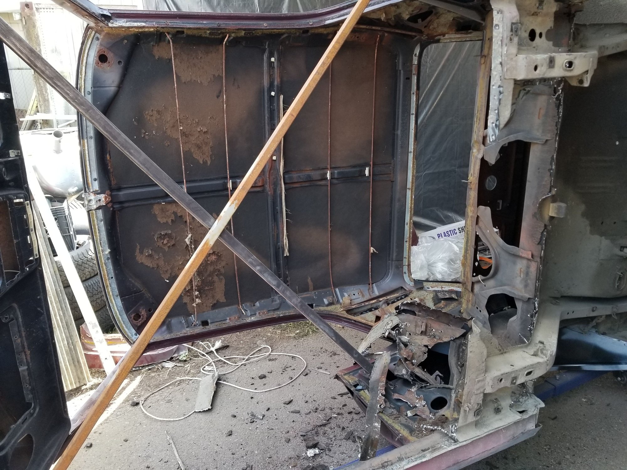

I especially like the oversize Bow-tie on the radiator grill. A Chevy-lover through and through, that's me. I thought I might continue on with the restoration story concerning a non-standard part of the process. A while back, the restoration shop owners came down to look at Ricky and examine his condition, with an eye toward providing a broad-gauge estimate of cost. We attempted to list the line items that would represent sub-tasks needed to reach a fully-restored ’68 Camaro, and one major item was the pan. I placed a trouble-light under the car, and once lit, we viewed a remarkably close simulation of the Milky-Way galaxy from inside the cabin. So, once they started the project, and we decided to replace both rear quarters, and ultimately the passenger-side inner-fender, I was told that those line items had to be done first, before removing the pan. The structural integrity of a uni-body is very dependent on its floor, and once the pan is removed, everything wants to fold in on itself, thanks to its attraction with Earth Central. We finally, after a great deal of work, arrived at a point where Ricky had new rear quarters, and a new inner fender on passenger side, and it was time to remove the pan, spanning from the front edge of the trunk to the bottom edge of the firewall. Before doing this, the body-man welded in an X-brace from front opposing corners of the cabin. Once that was done, and the pan was surgically removed, we arrived at this point:
Interesting to view the inner surface of a roof from underneath a car… In any event, Ricky did not stay bottomless for long. Soon, the bottom looked like this:

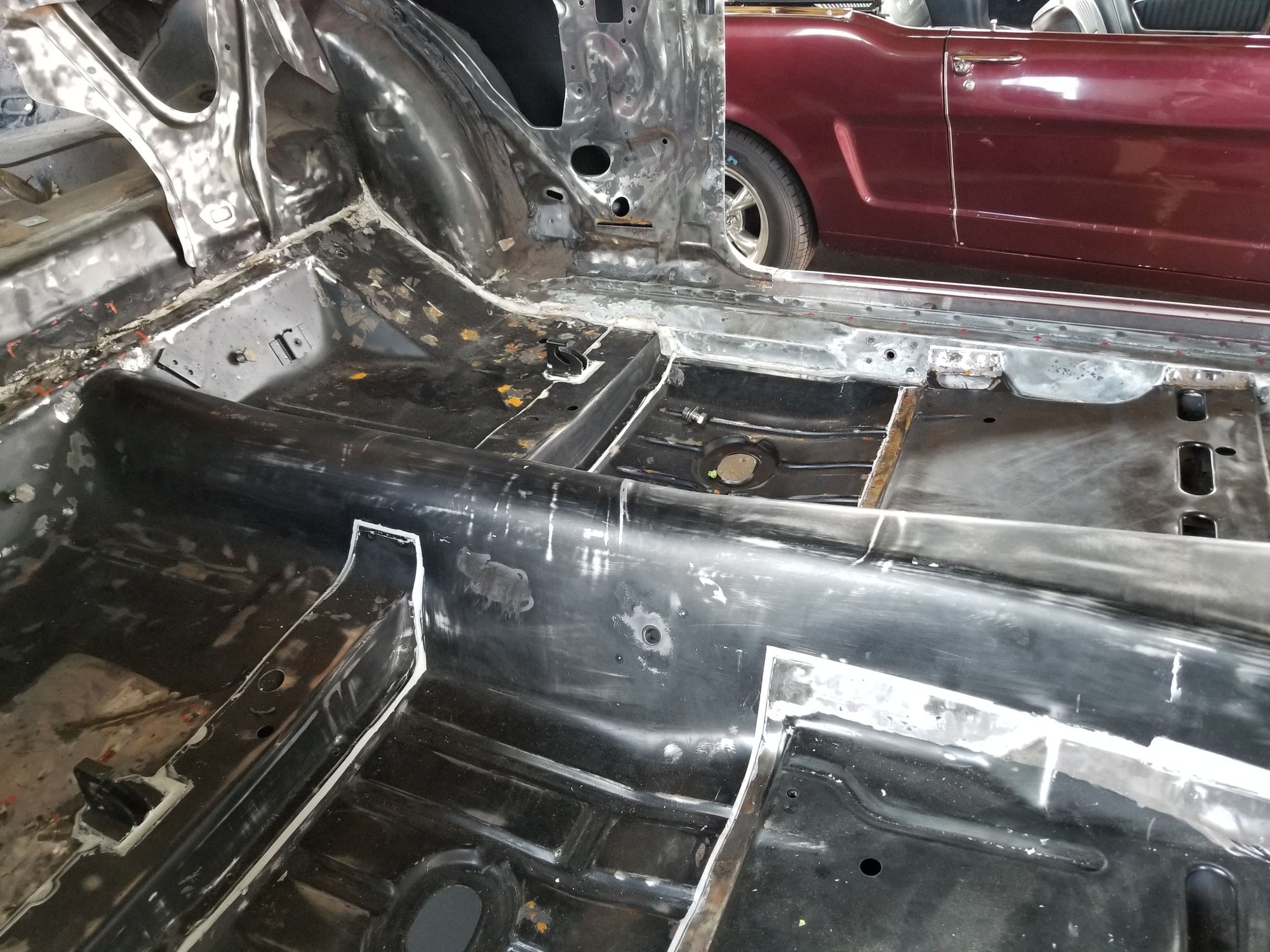

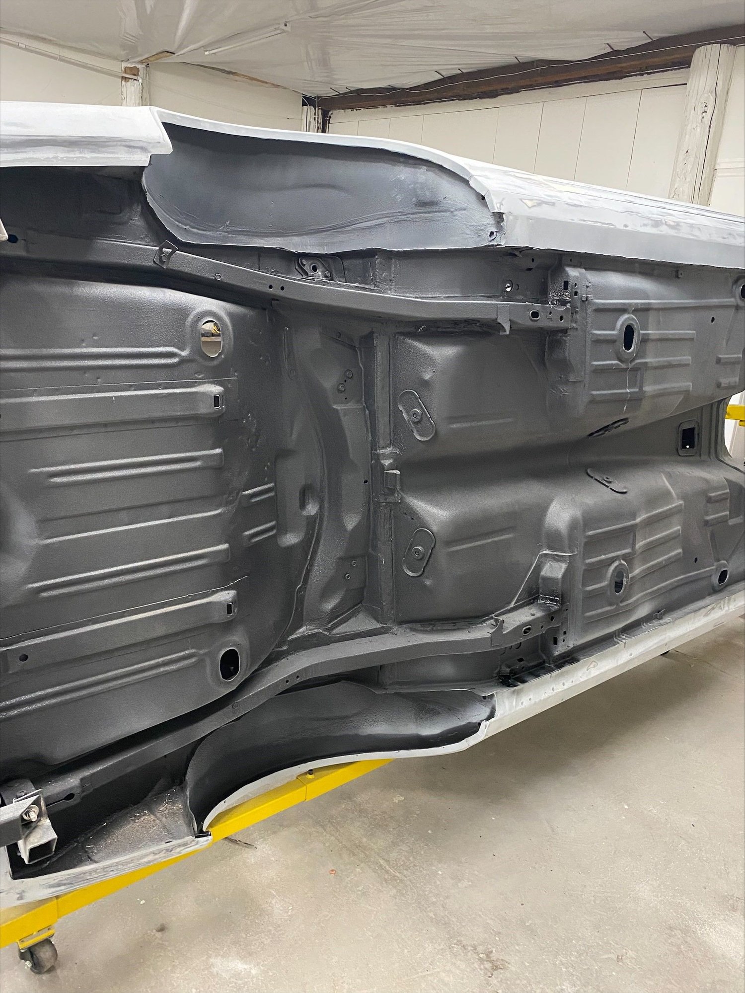

Next steps involved work both on the top and bottom of the pan. All original metal underneath (such as bottom-side of trunk) was taken to shiny metal, and then sprayed with Ospho, the residue buffed off and then sprayed with ‘etch’ primer. Then, the entire bottom of the car was sprayed with truck bedliner, and came out looking like this:

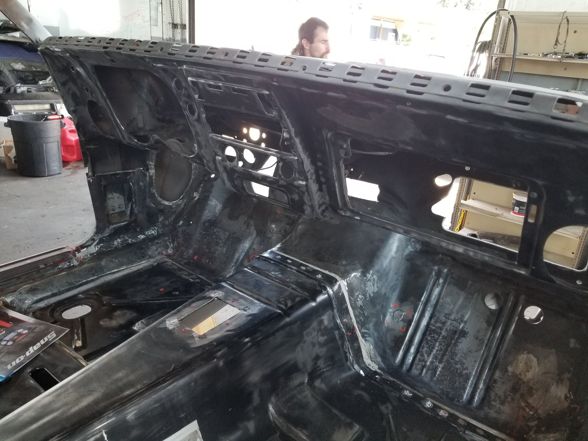

Up inside the cabin, several further operations were required. Seat supports needed to be welded in, and then the entire perimeter and other welded seam were seam-sealed with Tiger Seal UPO728 adhesive sealant. Once this was done, the cabin looked like this:

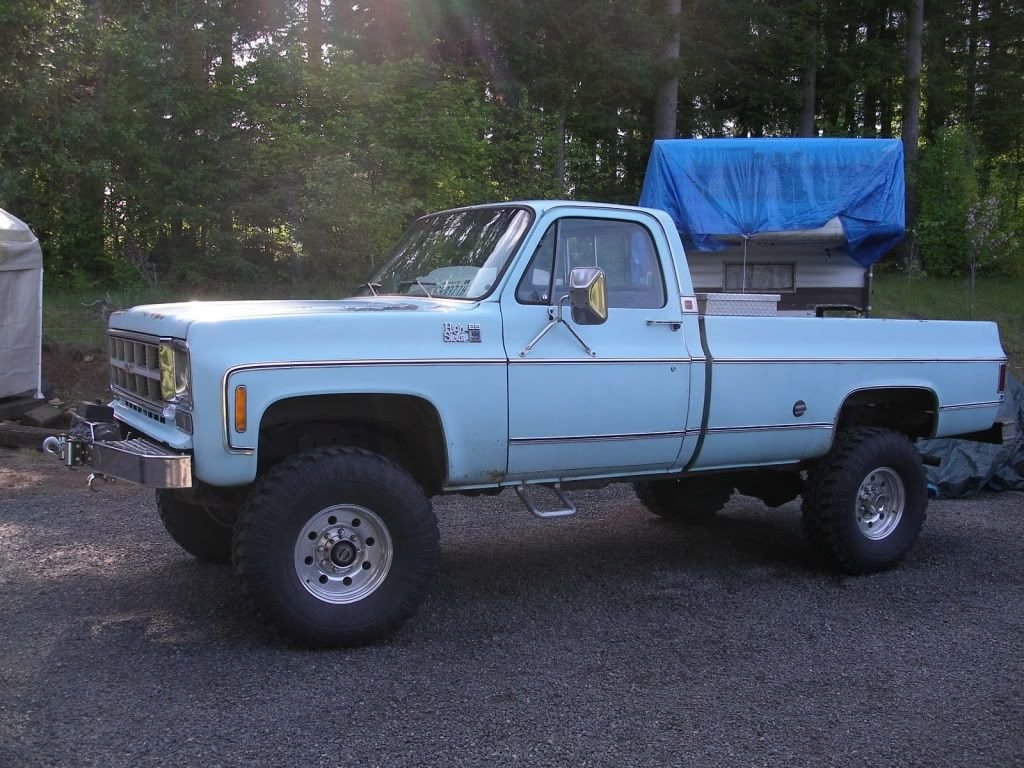

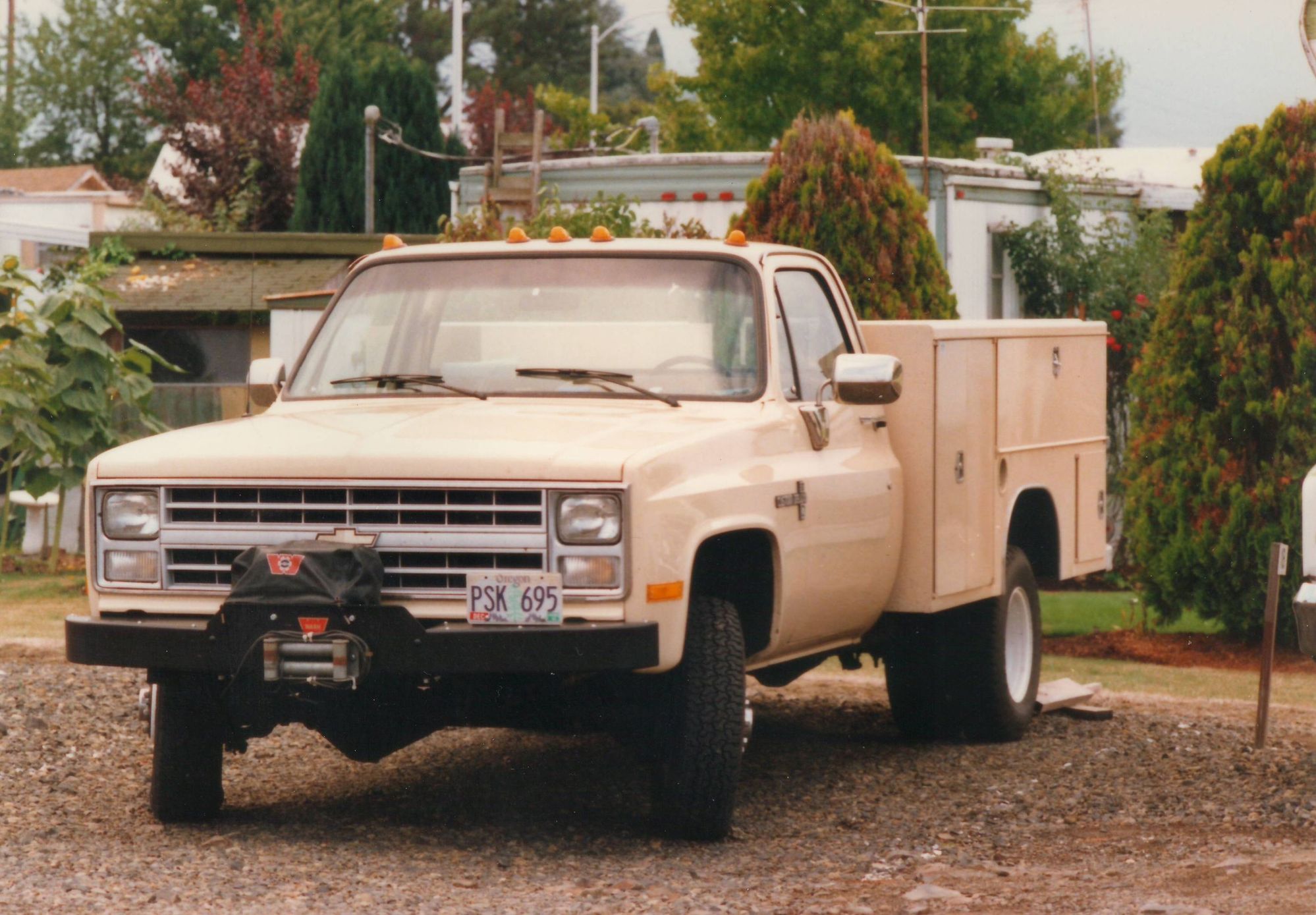

Very nice. I am partial to 454's! My truck was '73 with a 350 and a crap turbo 350 tranny when I bought it. We rebuilt the 396 from the motorhome and I bought a Turbo 400, fully rebuilt with this nasty shift kit in it. To put it in the '73, we needed to move the frame member that held the transfer case back 3 1/2" , shorten the rear drive line accordingly, and have a new front drive line made, and bought an adapter for the back end of the Turbo 400 made by B&M that allowed it to bolt to the transfer case. Major pain in the rear, but when the dust settled, I had a big block and a bullet-proof tranny in this:
Recalling that I name my vehicles, meet "Big Truck". He came with a third gas tank that someone built behind the seat, so I carried 63 gallons of gas, and could go a long way. 4-ton Warn winch with brush guard even with top of front hood, trussed axles front and rear, dual shocks on front, and 3/4 wolf on the seat next to me. A rare package to be sure. Even an awning at the rear of the canopy... That was a cool truck, and I really miss it. My next truck was an '88 1-ton dually, again with a utility box and the same winch moved over. I called it my "4-truck": 454, 4-speed, 4-wheel drive, 4 Me. Needless to say, his name was "Son of Big Truck" or "SOB Truck for short. He looked like this:
SOB Truck was a very cool ride for the years I had it. Now, I am resigned to my fate: a 2016 Silverado 4X4 'LTZ Plus' that transcends "excellence in design."
