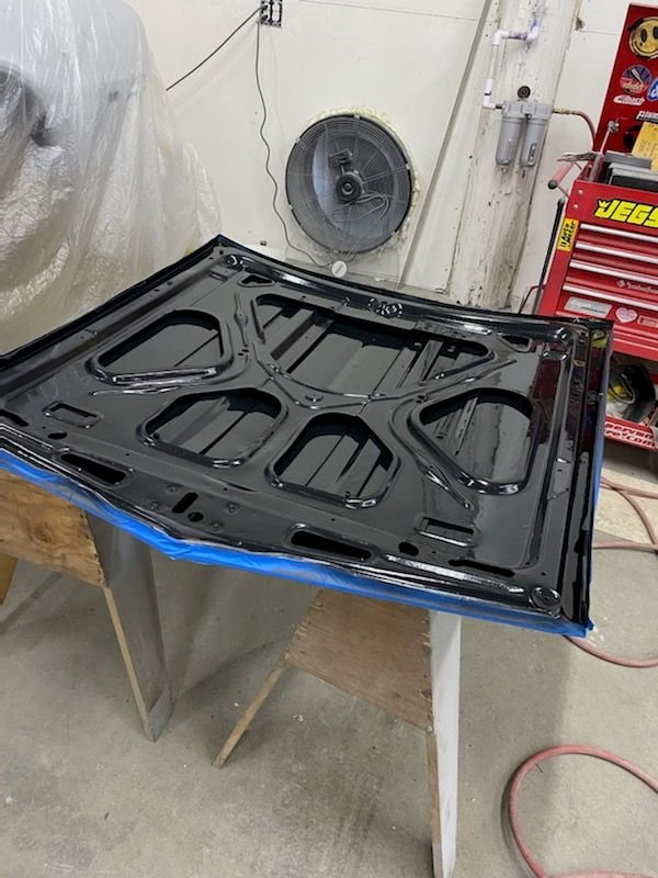

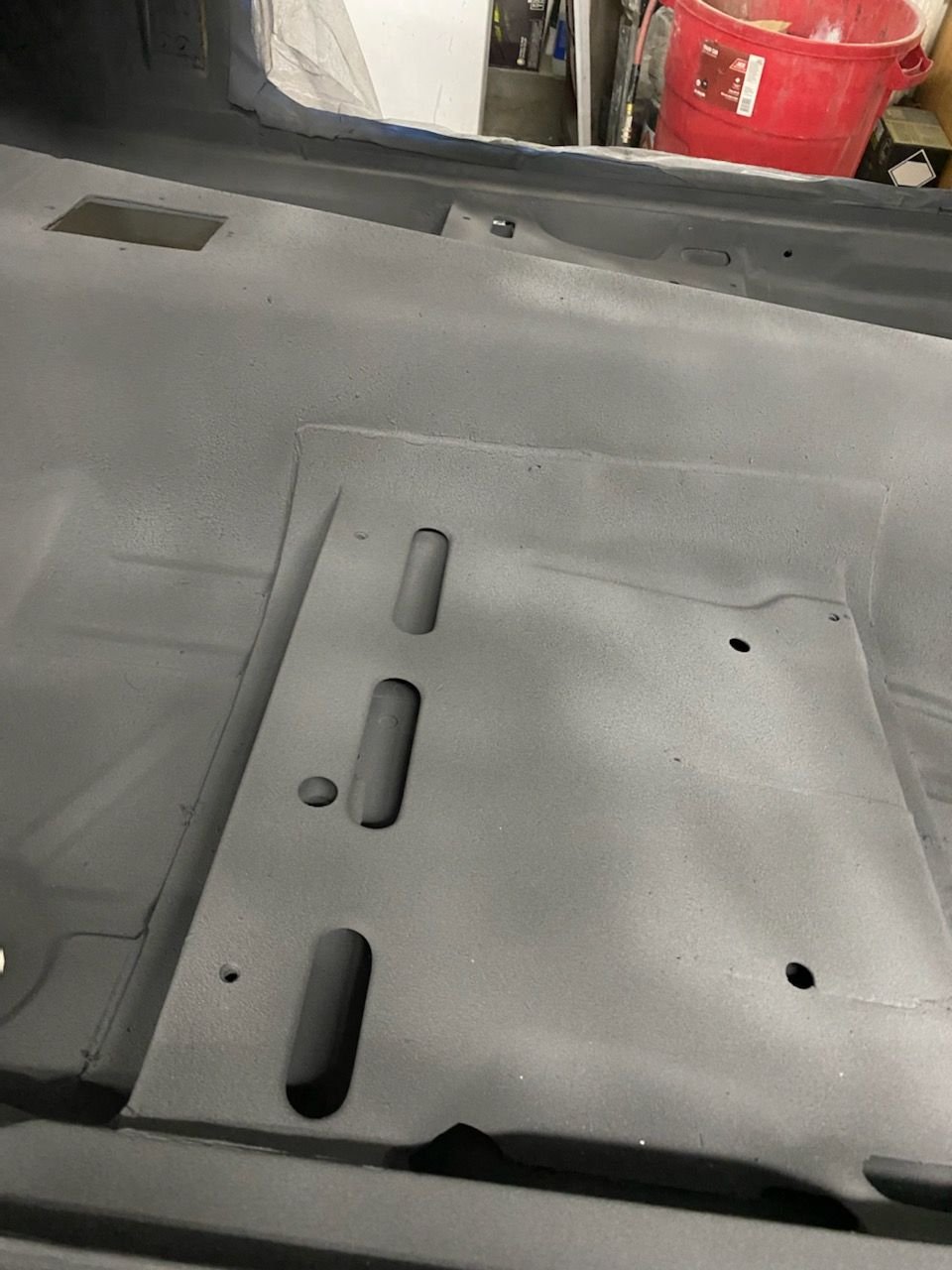

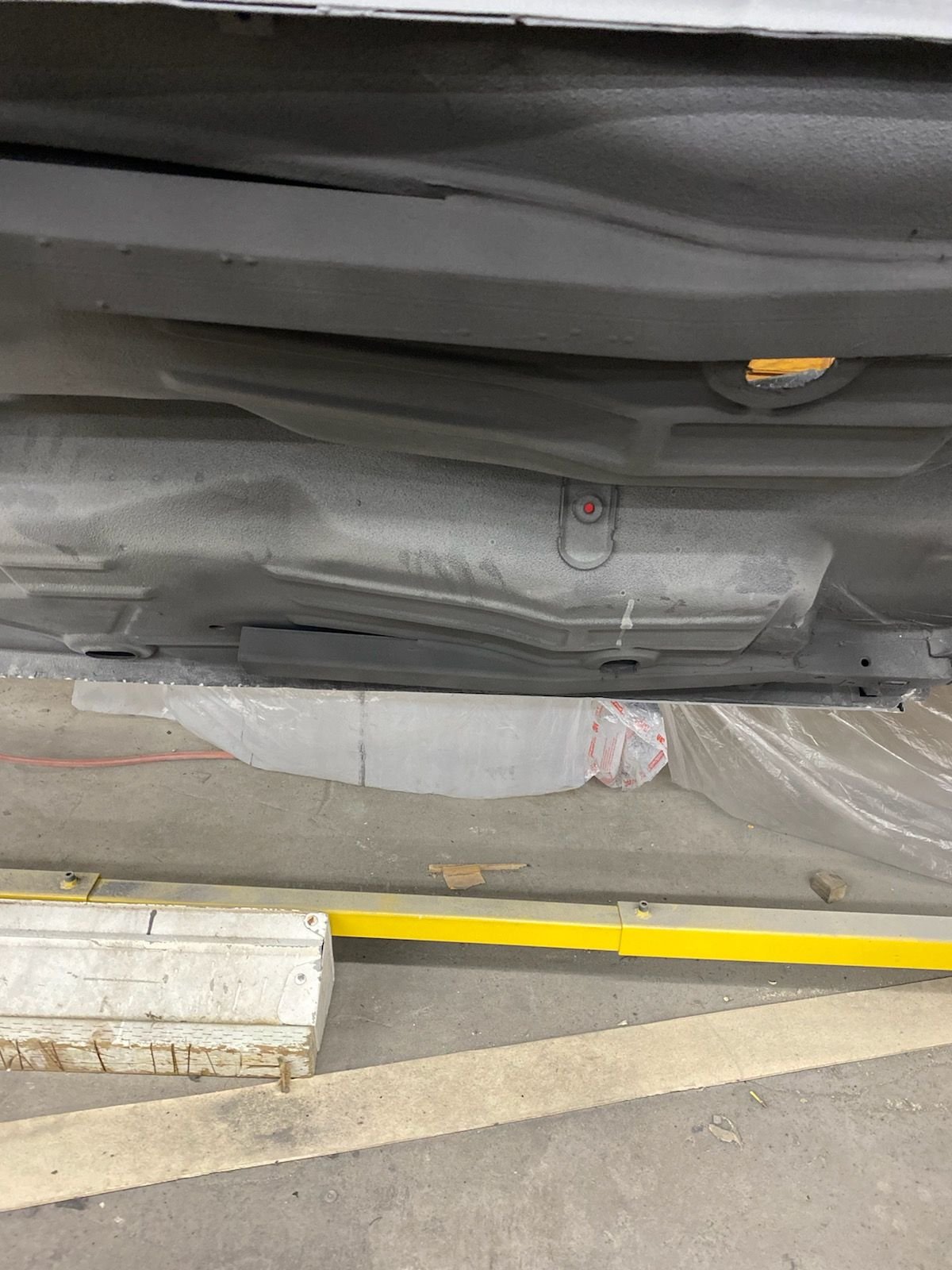

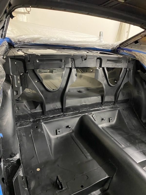

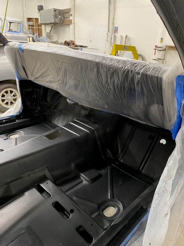

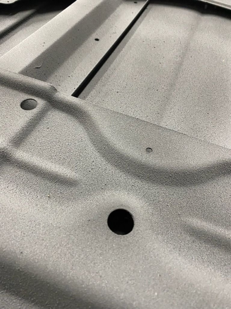

Getting back to the true subject of this thread, the rebirth of Ricky Camaro into a non-original but original-like '68 SS396 Camaro. (at some point I want to wrap around to that 'SS396' subject, but not tonight) Talking about pickups and workshops is truly fun for many Chevy lovers who like to work on their cars, but reality of this forum calls me back to report on progress on the subject car. If you've followed this story from its start in "General - New Members" to "1st Generation sticky 'Let's see those 1st Gen pics' page 63 and finally to this "Ricky Camaro Rebirth" thread, you might recall our intent to coat the non-painted portions of the interior with Lizard Skin's 3 components, rather than use a more traditonal product like Dynamat. The Lizard Skin product is sprayed on, and uses a first layer that is a sound deadener, then a second layer that is a ceramic heat insulation, and finally a top layer that is a sealer with a surface similar to a truck bed liner. We finally arrived there this last week, and have pics to show the current status. This first group includes 2 interior shots, a shot of the bottom covering the recently-installed frame extensions, and a shot of the compartment side.of the engine hood, with a single layer of the sound deadener:
The last group of 3 are end of day Friday, and show all but the hood with 3 coats of sound deadener and 3 coats of ceramic insulation. These will cure over the weekend and the 3rd layer (sealer) will be applied Monday. We continue to move in a forwardly direction:

Just to be clear, no Lizard Skin will be used on any interior surfaces that remain exposed to vision. The dash and upper portions of the door insides, for instance, will only be painted as in any interior restoration. In one of the pictures, you can see the dash is under plastic wrap. The Lizard Skin is being used on non-visible surfaces; i.e. the floor under carpet, under the seats, the firewall, insides of doors and side panels, under the headliner, etc. Also, all three layers are being sprayed on the inside of the hood, not just sound deadener. Our theory is: if some's good, more's better.
So, you mention road noise, most probably tire noise. Acoustic science would say you are actually hearing your body panels serving as crude speakers, with vibrations induced by the sound pressure waves traveling outward from the tire/road interface. Whether using traditional solutions such as Dynamat, or current alternatives such as Lizard Skin, the idea is to make those body panels not vibrate. The ideal solution, of course, is sheet lead, and in small but noisy areas, that is actually a great solution. I have personally witnessed its use on an engine hood in a 1-ton Class C motorhome we built, where the hood sits right between the front seats. Anyway, you mentioned that a great deal of sound came through the back seat, and a look at the picture above of the back seat support metal shows why, given the large amount of open area without any metal at all. So, here is how I intend to solve the problem. First, understand that I have made a decision to install a very high-end audio system in the car. This might not be wise, given the 396 with Hooker steel-tube headers, 3" exhaust, passing through Flowmaster 40-series cans. It is my hope that 3 coats of Lizard Skin sound deadener, along with truck bed-liner underneath will help, and my theory is that if I want to hear conventional music, I roll up the windows, and if I want to hear Big Block music, I roll them down. So, given two 6X9's in the rear deck, and two 6 1/2" in the doors, along with separate tweeters in the doors, the question in my head when this restoration was still early-on, was "where will I find room to mount a sub-woofer?"
As a solution, my intent is to kill multiple birds with singular stones, as follows: I have a number of sheets of 3/4" high density particle board (HDPB for short) and I propose to first create a template of the rear seat back on the trunk side out of sheet cardboard, and use that template to cut out a solid piece of HDPB. Once bolted to the back seat framework from the trunk interior, I would have an ugly but very effective solution for road noise suppression, since particle board really doesn't want to vibrate. However, Ugly doesn't cut it. Over 40 years ago, I served as a second set of hands for a friend with a Mobile Dimension sawmill, as we sawed dimension lumber from freshly felled Maple. For payment, he gave me a substantial stack of it. It's mostly in 1"X6" boards, un-planed, and has been stored, stacked and stickered, inside a shop in a very dry climate ever since. So, my actual solution will be to cover the 3/4" HDPB with planed and finished Maple, which is what you will see with the trunk lid open. On that Maple will be a Maple-over-HDPB enclosure covering the back of the sub-woofer, two similar enclosures over the backs of the two rear-deck mounted 6X9's, and two amplifers, one 6-channel, and the other a sub-woofer amp. In the trunk, there will be a 12-volt car battery, fed from the engine compartment via a battery-isolator, providing power to the amplifiers. Just the thought makes me smile. And I feel certain that the weight of this additive will help press the rear tires into the pavement for added traction to assist the Eaton Detroit Trutrac in its limited-slip endeavors.

Regarding noise bleed through side panels, I am going to be content with the Lizard Skin behind the windows. I would love to stuff the cavity with Rock Wool, and it might be possible, once I get down to the shop and look, but those pesky windows have to come down so I can listen to Big Block Music when the sun shines...
The Lizard Skin sound deadening component (layer 1) does a very good job at convincing body panels to not vibrate as much.
