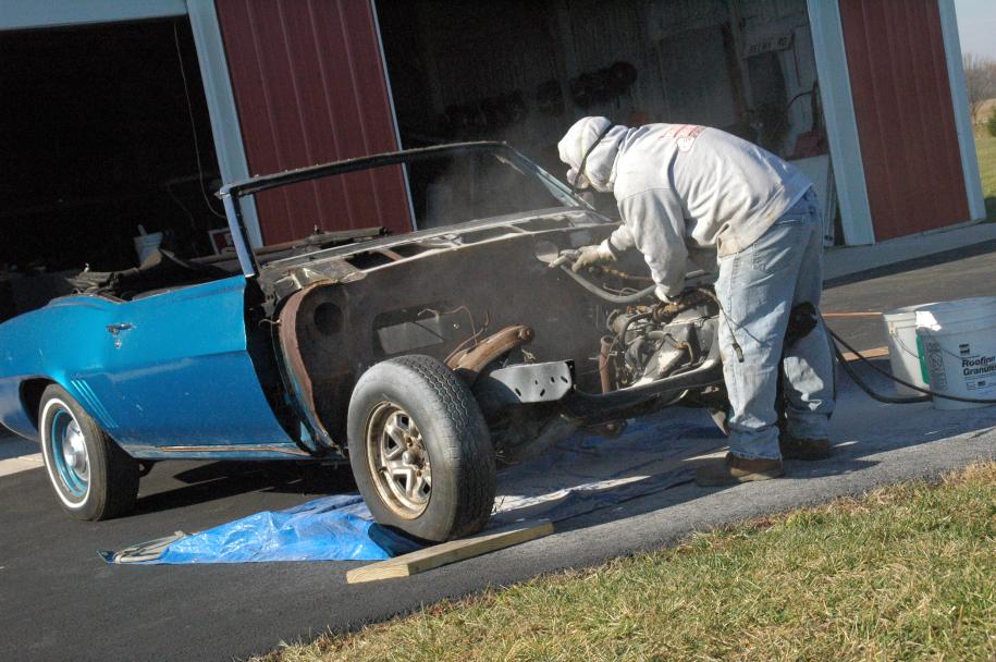

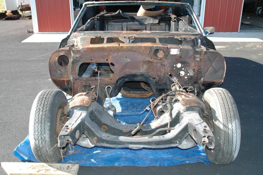

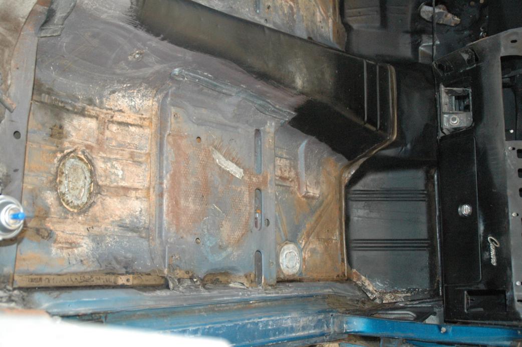

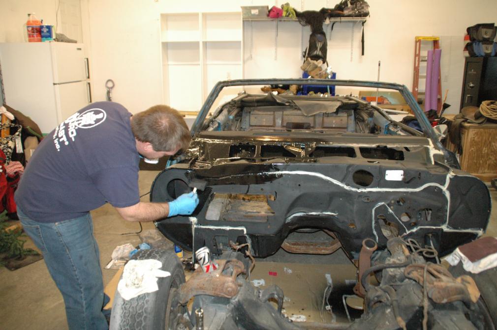

Well I pushed the Camaro into my wife's parking spot. The small garage is a little easier to heat. I sandblasted the firewall. I painted it with a couple coats of POR15. I also applied seam sealer to all of the seams. I also did the inside firewall and all up under the dash. One thing leads to another, now I'm putting POR15 on the floor pans. Here are a few pics.
