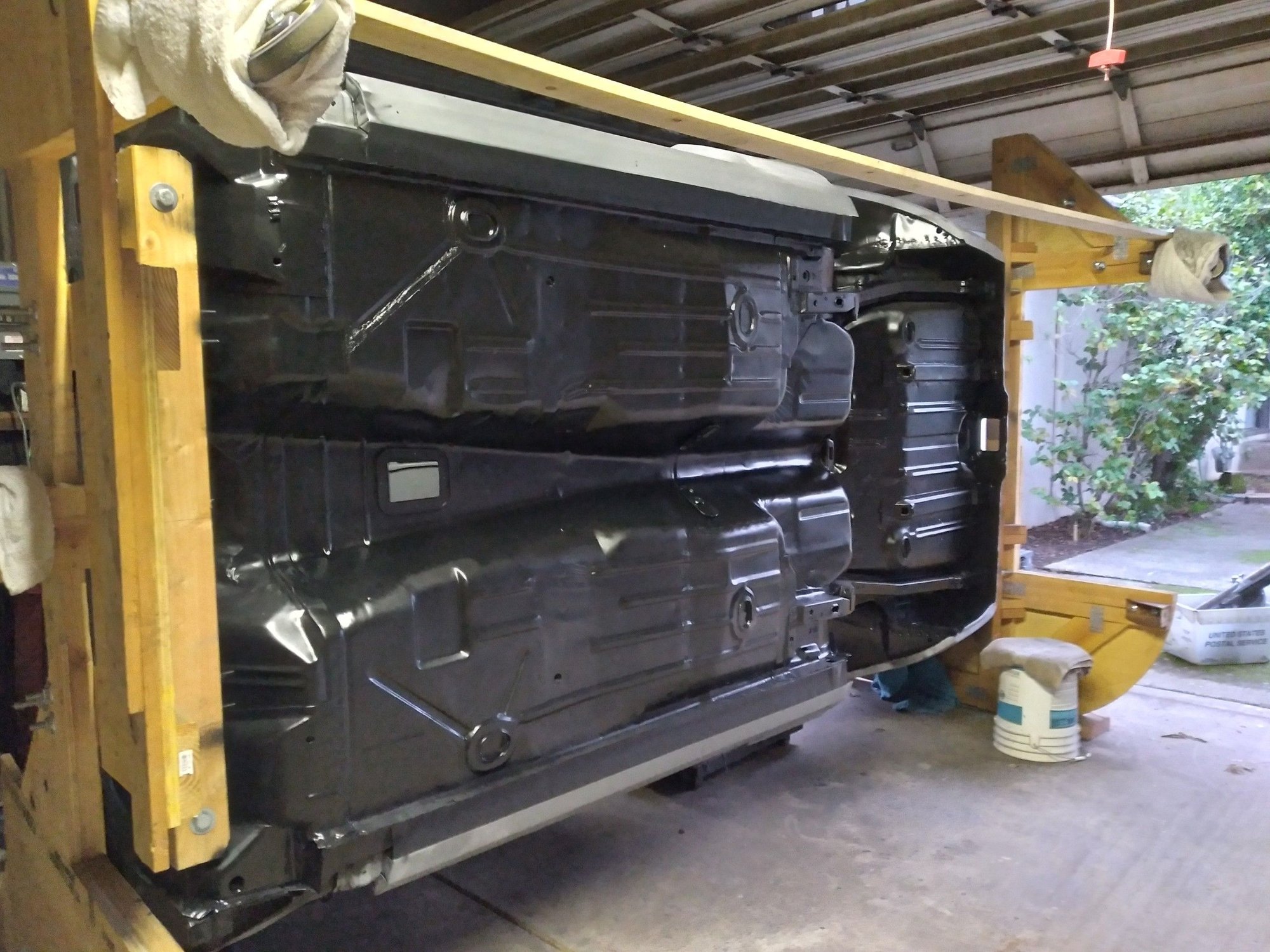

Default Bed Liner Rocks!!!
Originally Posted by Turbo86
Any recommendations at this stage is welcome.
Broken record here regarding undercoating. I just returned from visiting my Camaro, which should be getting painted tomorrow, and I spent quite some time examining the pan and trunk area and I am totally IN LOVE with the undercoating choice we made: truck bed-liner. I really have no other experience other than what I hear, but I do hear some negatives about traditional undercoats. Still, if this is an occasional pleasure-driver, maybe down Hwy 49 through Jackson and Moke Hill, popping by Twain Harte, you probably can't lose with any way you go. You're not doing this for us, you're doing it for you, and what makes you smile is all that counts.

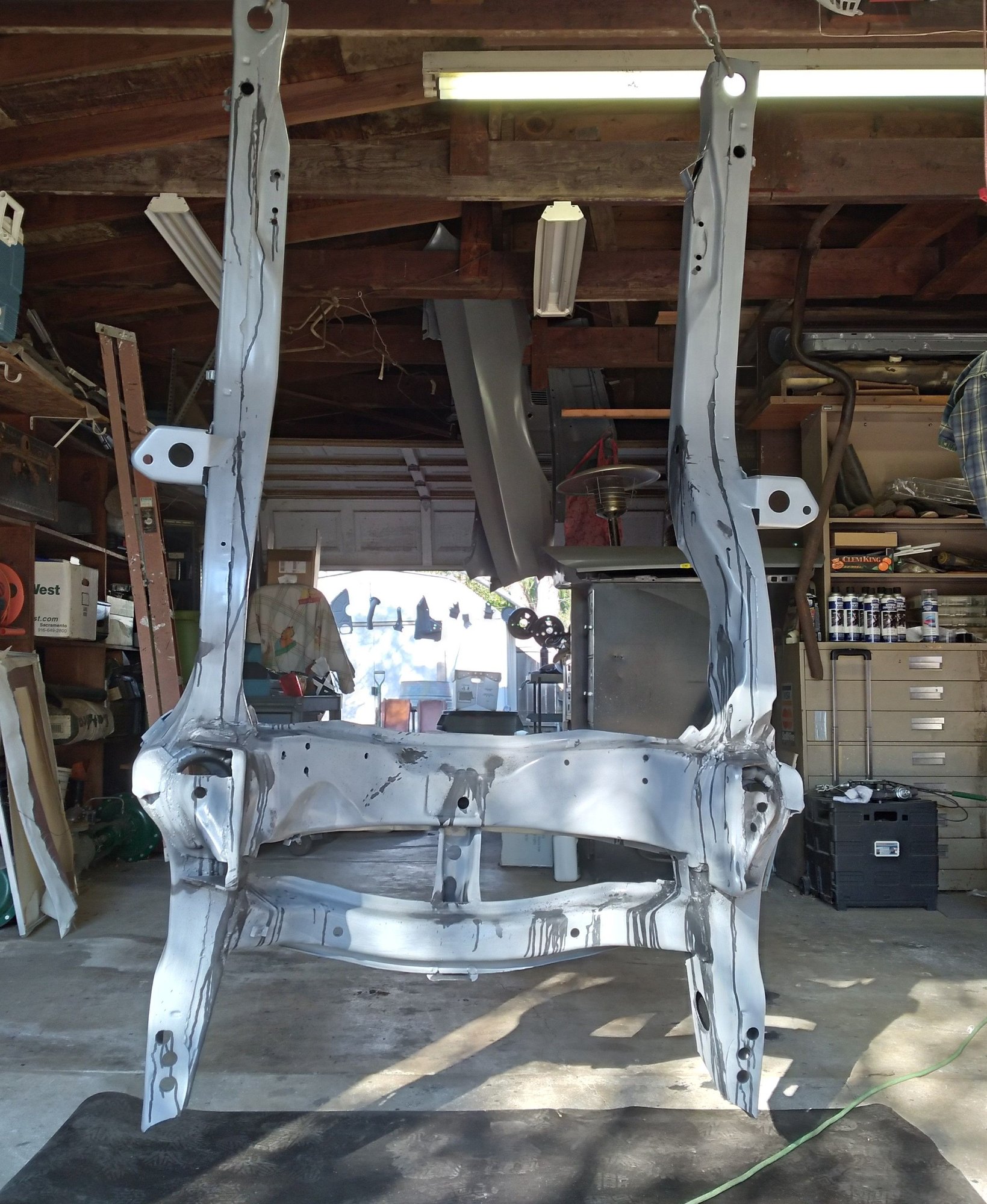

Just finished the internal frame coat on my subframe last weekend (Can also see other parts hanging in the background that I was painting too). I used the Eastwood Internal Frame Coating. Its a great product that can reach inside areas with a 2' x 3/16" tube with a wide spray nozzle at the end of the tube. I used three cans on my subframe (way to much), but made sure every inch was covered. I used tape to cover the holes to determine my coverage, plus a flash light extender helps to see inside. Oh... never mentioned it, but did the internal coating on the frame body too. Lots of areas in the support frame, rocker panels and other areas (very happy with what I did). I will paint the frame this coming weekend along with a bunch more parts. I had a goal of end of February to have my car back on wheels to be painted, but I think I'm about 6-8 weeks out, so looks like a spring paint job. Still lots to do, seam sealing interior, assemble front suspension/steering, clean/paint rear end & install, clean & prep brake & fuel lines, assemble front radiator frame & light assemblies, install paneling....and then paint? ..... OMG, so much to do by myself. What have I gotten myself into.

Boy, I bet you're getting excited as you approach getting your ride turned back into a roller! Haven't seen what you're doing with rear end. Just curious. Regarding front sub-frame, you probably noticed that my shop has totally assembled front components, from control arms, brakes, steering, engine/tranny as they feel it's a LOT easier to do this out in the open, then mount the entire assembly to the body, then finally build the engine compartment around the sub-frame mass (inner fenders and core support). They intend to leave the fenders and hood off while doing new wiring loom to avoid scratching new paint as much as possible. So here is what this will look like in a week or two:
We got this far only to find insufficient clearance between HEI distributor and firewall at which point it went back on rotisserie. Also, another point to consider: Jerry elected to leave it on rotisserie to complete body paint all the way through as he finds it easier to perform lower-body paint when he can rotate the car. Also mounting fuel tank is easier. I'll grant that all this is easier if you have a second set of hands to help.
