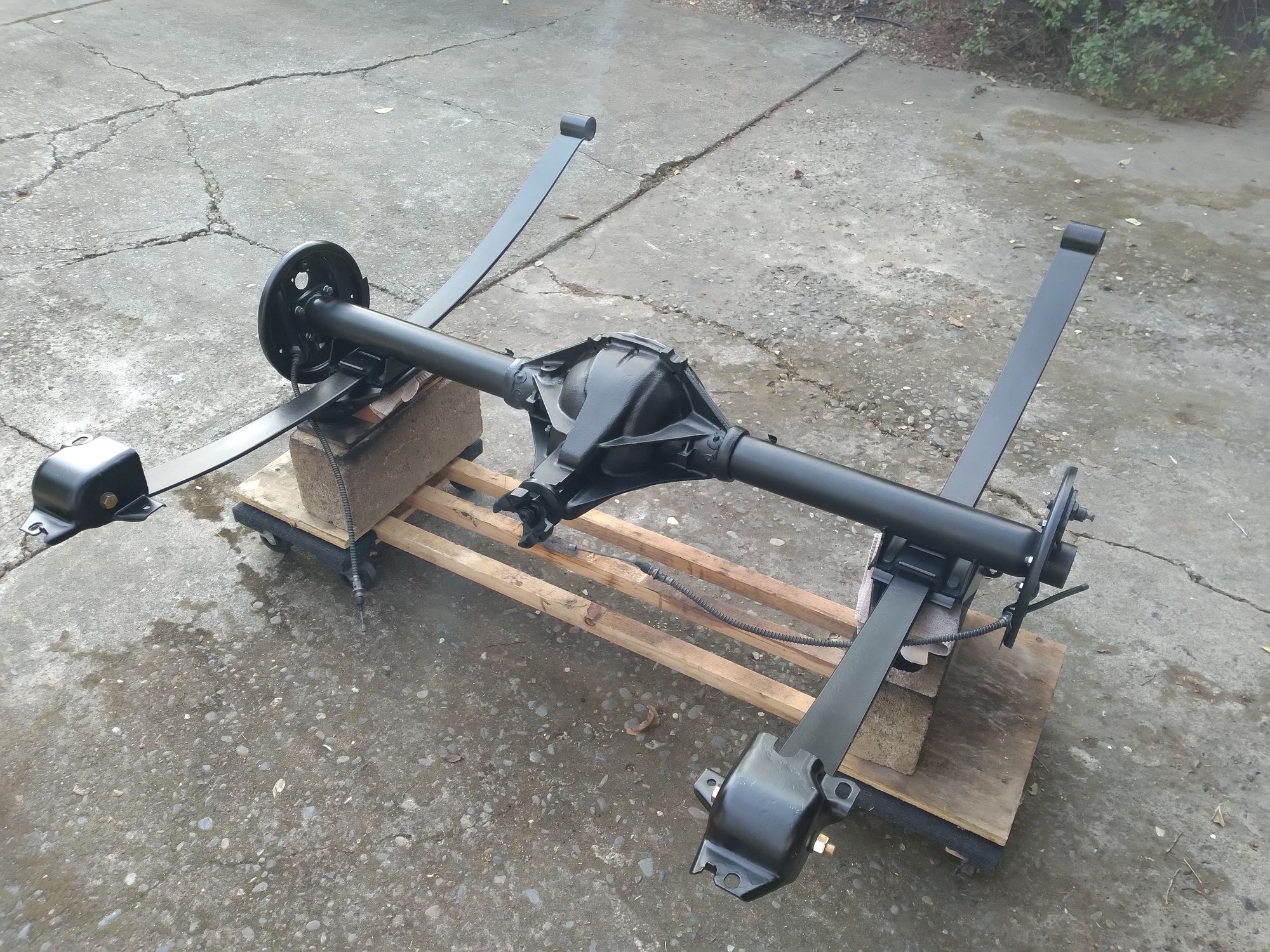

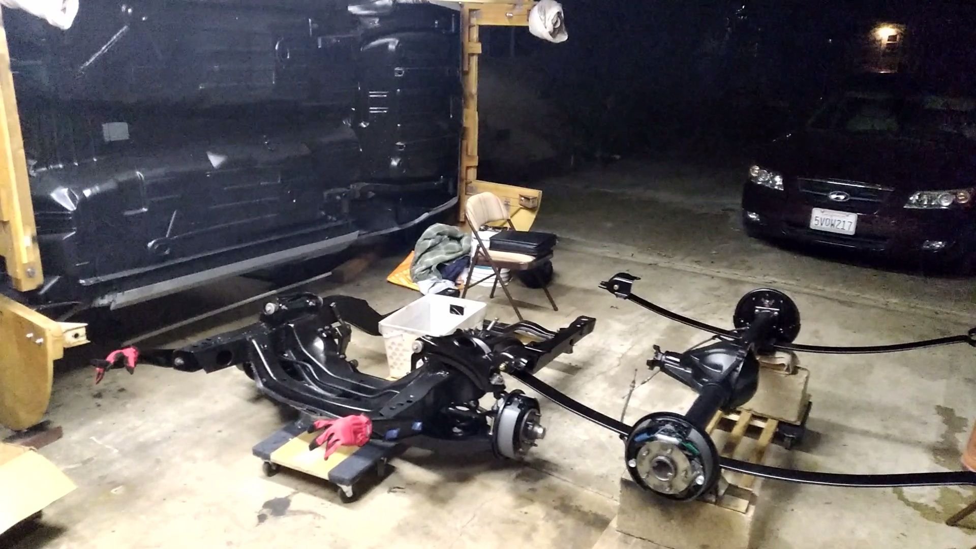

Subframe complete, rear end complete. Just need to install axels, seal up rear end cap & oil, build the brakes (front & back) and install brake lines on subframe, rear end and gas line. I won't have time to work at all on the car for the next two weekends, so that leaves me a couple weeks put the body back down on its belly and install rear end and subframe. So, by the end of March (first week of April) I should have a roller. Take me another two/three weekends to finish seam seal and temporarily fit panels for transport. That would put me end of April for paint start and finish all the touch-ups and misc. Well ready for pain that is, not necessarily start paint due to painters schedule. Anyway, once it's at the painters, give me time to work on cleaning up transmission, driveline, gas tank, chrome parts and everything else I'm forgetting. Transmission has already been rebuilt, so just needs a cleaning and probably a couple seal replacements since its been sitting so long. The engine will be the last big item before assembly. Still have not yet decided to either send the engine off to get rebuilt or fly a good friend in from Texas and rebuild together in my garage. Thank those again who have given input. I still welcome any advise, opinions and even criticism at this point as to make corrections as I move forward.

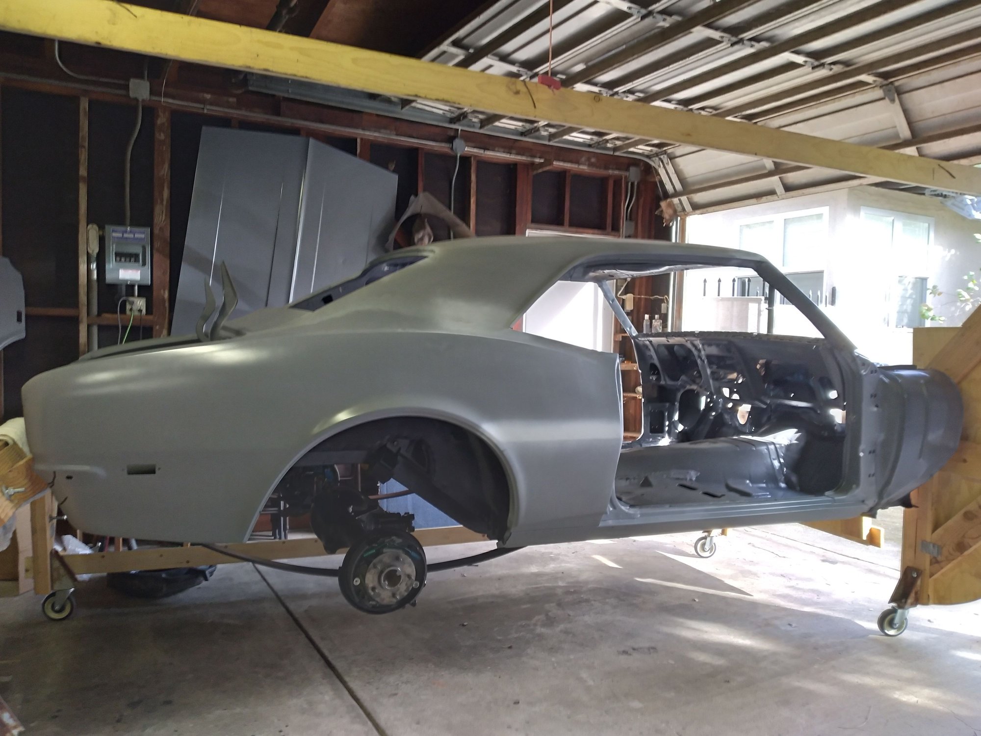

Hey what's up Camaro lovers... just an update. Have not had much time to work on my 68", but I finally got the body back down and the rear end installed. Brakes and axles installed too. Had a hard time lining up the rear end, just one bold was difficult, but still only took me about 45 min to install. Subframe ready too, but will end up installing at the end of March when I have the next available time slot. I had a little hick-up with the bolts for the upper ball joints when I did the final tightening. For those who are purchasing the upper ball joints from Camaro Central (not sure if other shops sell the same product), the bolts that come with the ball joint are crap. Do not use them. I stripped the first three, but I was only giving them a snug fit with a small 6" ratchet. Maybe 10-15lbs, not much. Didn't realize they were stripped until I went back to put the final torque of 20lbs. got two off without any cutting and the third I had to very carefully cut the top of the nut. Got new bolts.. just needed a little paint touchup on the control arm. Oh... that used original lower control arm I purchased on line (see my previous rant post), we'll turns out that one of the lower weld-on bolts for the shock stripped on me. The control arm had a lot of rust pitting and I was worried about the threads, so looks like I was right. So, looks like I got to put a longer bolt with a nut... not happy. Hope to be on wheels by March 27th.

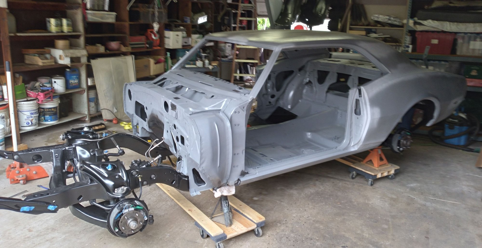

Moving slow, but getting excited. Now just seam sealing and panels... oh and tires. I forgot to clean up the brake drums, that's why not on wheels. I hope I'm not missing any steps. Have to go through my notes to make sure. My next update will have panels and wheels on and off to paint for them to take all off again. See before and after pics below (of course without the engine)

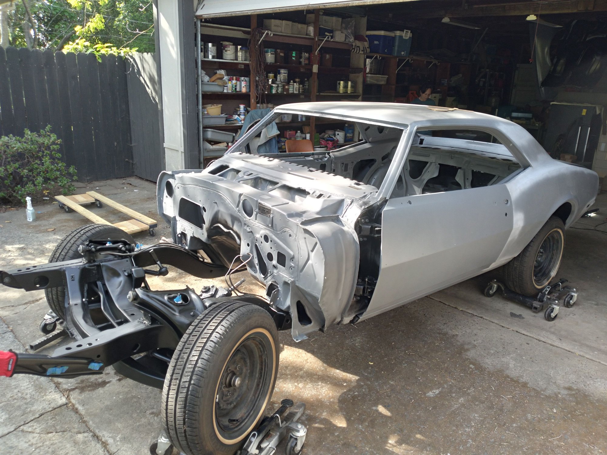

Wahoooooo... got myself a roller. Wheels on, doors on, trunk on and seam sealing done (except for the gutter above the doors). Soooo close....
