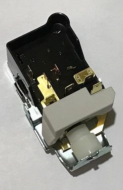

One way to tell is if the front bulb sockets are dual filament sockets or not

67 is single element bulb, IDK about 68-69

Dual filament bulb for 68 and 69, sounds like Robert K might have the wrong light switch installed on his 68 ( 7 Terminal is original for non RS/SS models)
