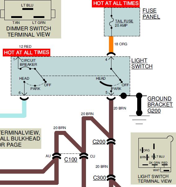

Normal operation for parking lights to go out when headlights are on.
Why need front parking on when headlights are on?
Parking lights when parked, headlights on when moving, you're not parked.
This was the thought back in the '60's by design.

Geez, I'll be eating this one.

My '67 is a standard from end and my park lamps go off when I turn on the headlamps. There's a fix somewhere on the site to change the wiring ?? As soon as I find it again I'll be switching mine to being on with the headlamps. Just looks better. (to me)
