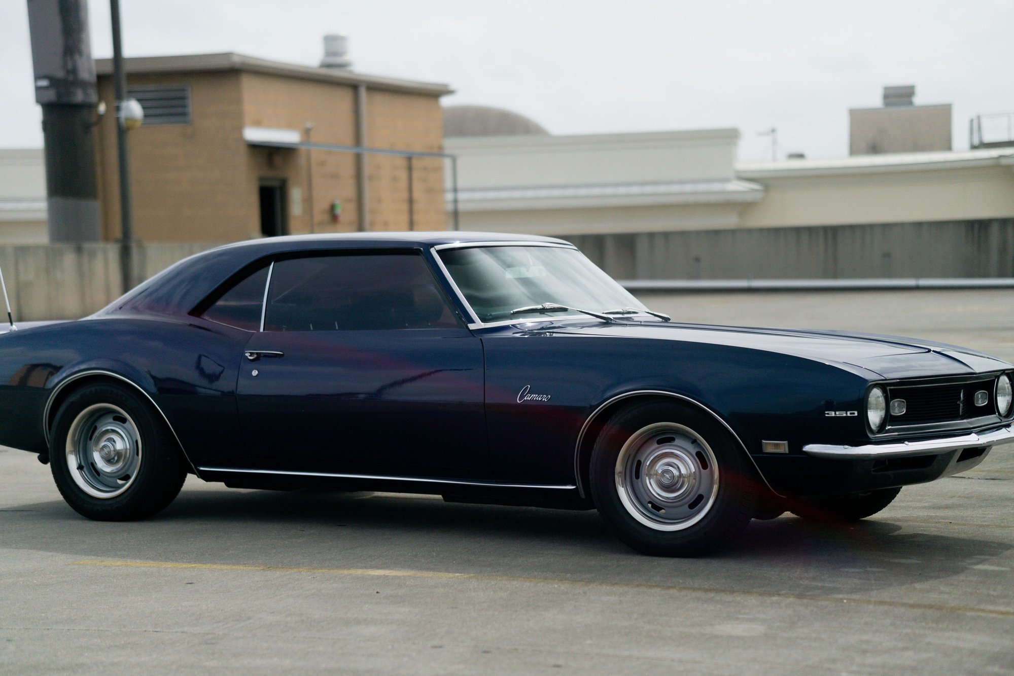

I’m very inexperienced in mechanics, however, l own a beautiful 68 fully restored I’m thinking about doing a Ls swap. I have a lot of friends in the car game and l here Everybody’s different opinion. What is the most inexpensive build ( motor, trans, rear end) that you recommend that l can build off of down the road but, not break the bank now.

Beautiful car... but in my world, it will break the bank no matter what is done. How much did you put into the car as is and is it worth it to upgrade for that much more. I'm not one to tell you what to put in or the cost, but it can depend on if you plan on keeping the car or selling and want a return on your investment. The buyer and market is different if you have all original with matching numbers or if you upgrade. If you upgrade and can afford to not sell original parts, plan on keeping the engine, trans and other parts. There are regrets to swapping out and I'm one of those who love all original no matter the engine.
