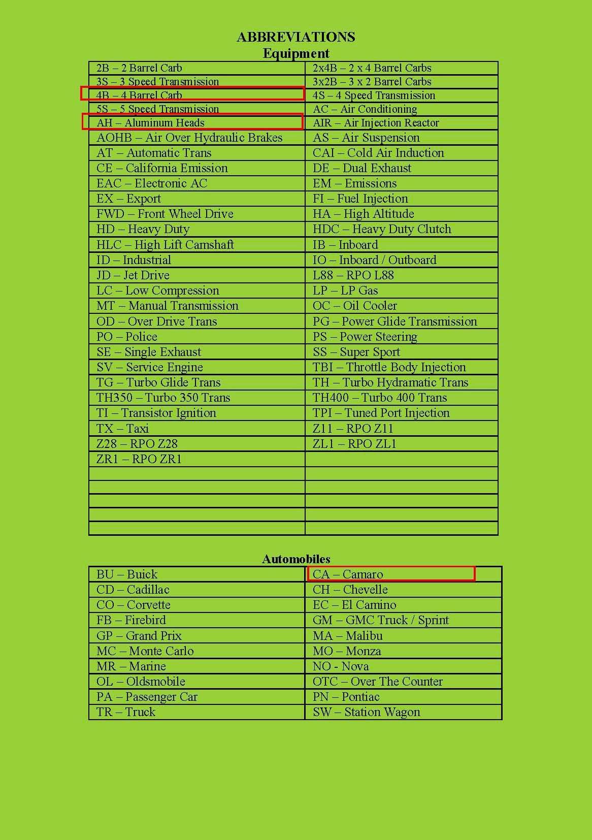

I'm no expert, but this is what the Lime Book lists the engine code as. Does the partial VIN match the car? If so, that would be indication the engine came in that car. Another good source of reference would be this CRG website page on drivetrains.

Are those the original aluminum heads? My info notes that BB MT suffix came only in '68 Camaros. Chevelle had EG, Chevy II MQ or MR

The "Lime Book" (the green pages shown above) is also saying the MT code was only used in the 1968 Camaro. In the equipment abbreviations for this code, aluminum heads are shown. On the CRG website, the L78 and L89 engines are shown as having an aluminum head option. The OP didn't mention aluminum heads, so I not sure he has the original heads or not.

Looks like an aluminum head from the photo which has the engine stamp on it. casting number would be 3919840 or 3919842
If this is in fact an L89 car, only 272 were made.How many with the convertible is anyone's guess. I had the very fortunate experience of riding in one of these cars back in 68. A friend of mine's uncle purchased the car from Baldwin Chevrolet, LI. Red with vinyl roof , 4 speed. Rated 375 HP was laughable.
