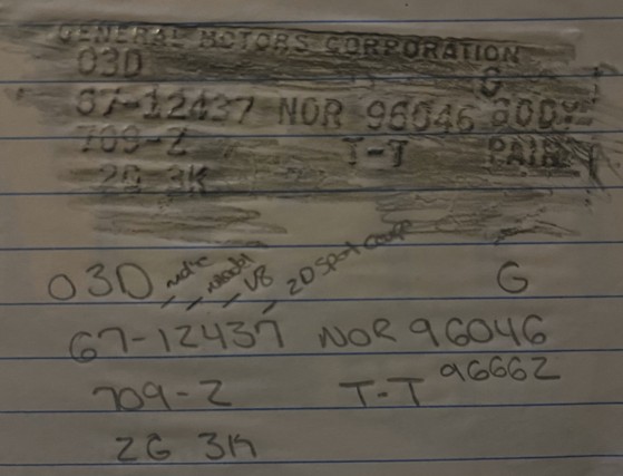

While this is my 6th First Generation project car and I have deciphered VIN codes before, admittedly, this one has me scratching my head. The digits seem odd but are directly from the VIN plate.
For the initial; codes reach (type, sub type
, assembly plant, etc.) but seeking other options and features like exterior paint color, validate it’s a real -off-the-line Rally Sport, etc
Thank YOU!
1967 Chevrolet Camaro Rally Sport
VIN: 67-12437 NOR 96046 6712437NOR96046 6712437N96046
Any help would be GREATLY appreciated!

Your 67 should have a cowl tag that should have the information.
"The cowl tag is a small aluminum tag riveted to the driver's side of the firewall in the engine compartment, by the master cylinder."
Camaro VIN, Cowl Tag, and other Numbers Decoding
About 1/2 way down the page you are looking for "1967 Cowl Tag - Fisher Body Codes"
RS package should be in Line 3L Note it can have other options in line 3 "3LK" would be RS with external molding package.

THANK YOU for your response... I;ll check the firewall when I meet the car in 2-weeks. Thx
