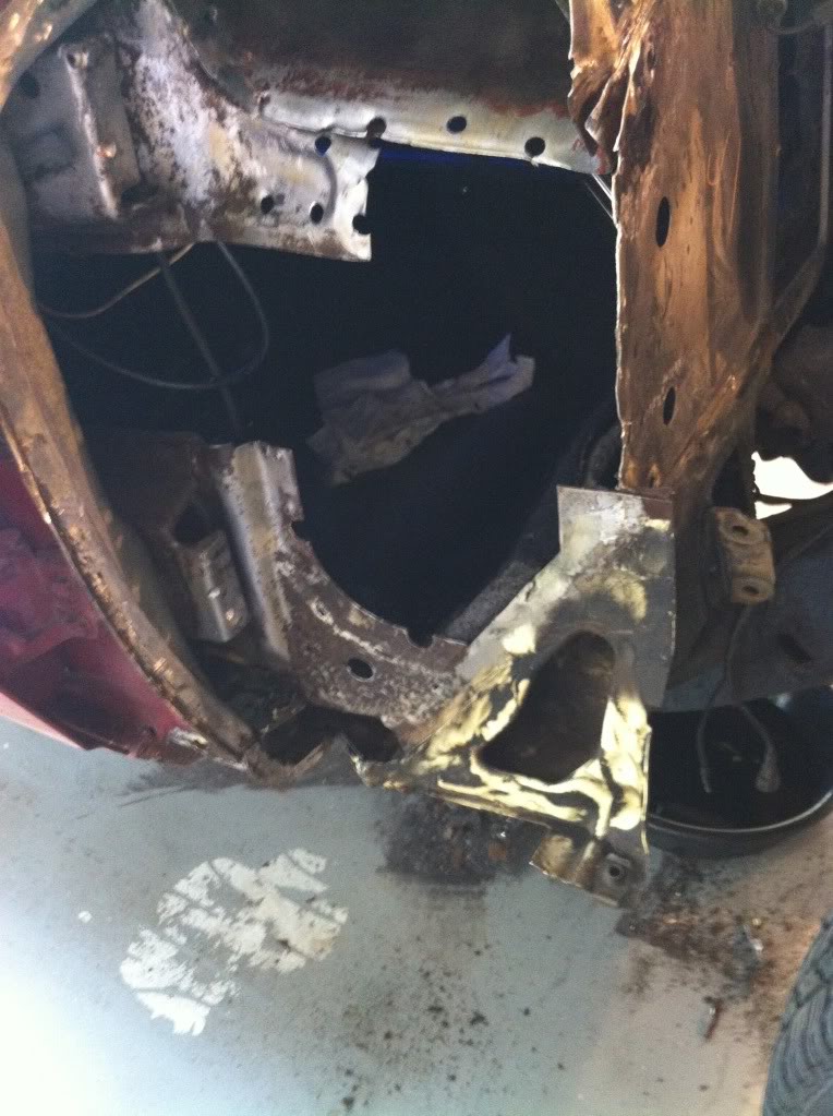

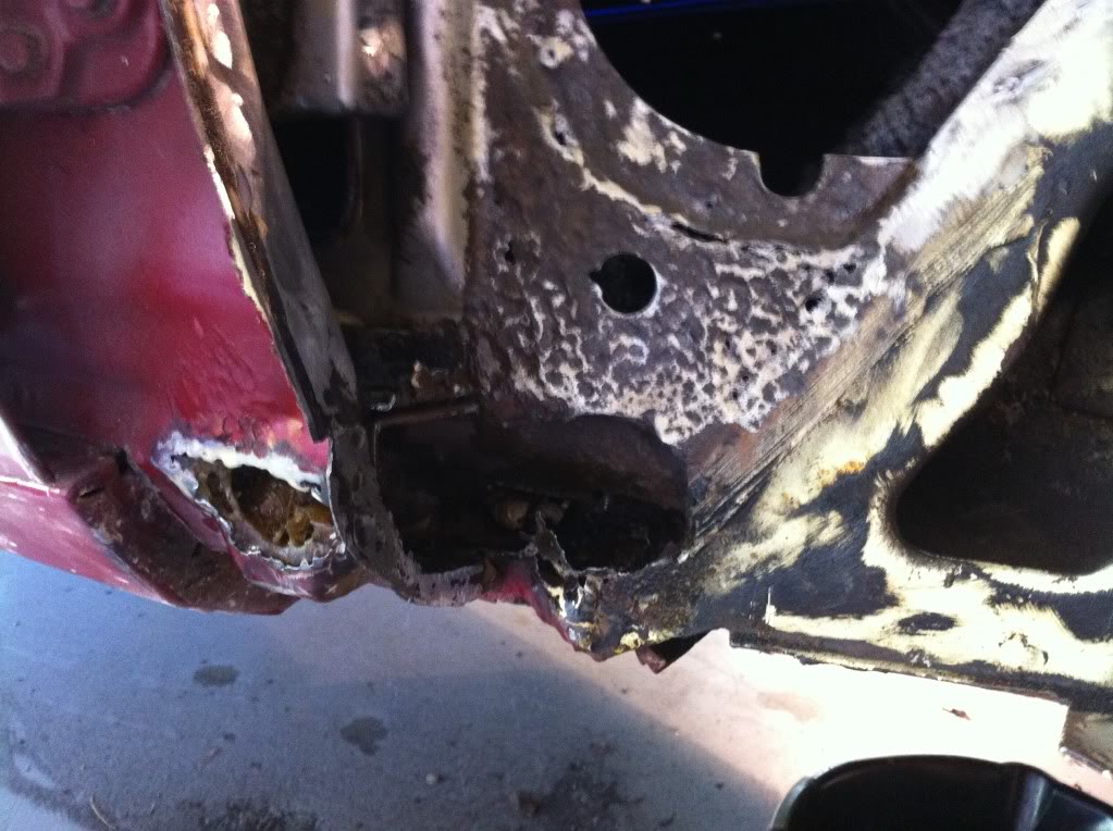

I removed the passenger side cowl. Took about 3 hours, not too bad. It was hard to see some of the weld dimples and know where to drill and/or grind.
Once I got the cowl out the way I see that rust has got the best of other metal just in front of rocker panel. I am not sure how this should look in good shape. I'm going to cut out the bad and make some new pieces.
Do you have any closeup pictures of this area with the cowl removed?
Here are a couple pictures of what mine looks like. The picture makes it look much worse then it is. These pictures are before I wire brushed and cleaned the area:

Rocker panels do not have holes in the front. Do you have any pictures of the hole location so that I can open my up?
Thanks very much!

You dug a lot deeper then I did but it looks like it was the right thing to do based on the pictures. I live in Texas and bought an central Texas car so I didn't have the rust same problem. I don't have a good picture of the end of the rockers but I do see two slits at the end of your outer rocker. They're on the left side of your bottom picture. I think my slits were a little larger. BTW, if the previous owner replaced them, it was done a long time ago. There's some rust and paint buildup on it. Looks original to me.
The photo links in the previous post takes you to the PhotoBucket album. Keep clicking the Next button. There's more pictures of the cowl area. They may help.
