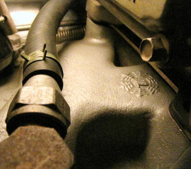

what about something that looks like a "snowflake". Will take a picture of it tonight.

The "factory" aluminum intake manifolds were made for GM by a company called Winters Industries, the snowflake logo was their trademark.
From what I understand, ones like yours were then sent to Holley to be sold by them for aftermarket use. Most likely, it's the Street Dominator model you have. See if you can find any other casting numbers on it.

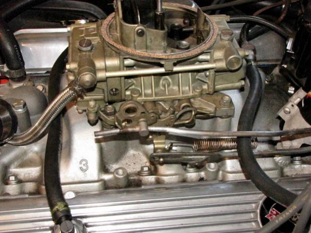

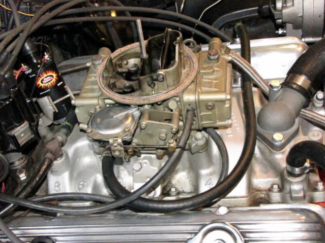

I think you are spot on. In fact, the snowflake logo has a distinct "W" in the center of it. I found no other casting numbers...at least none are visible with the intake still installed.
I have attached 3 pics of the intake...one is specificly the snowflake logo.
So this is an aftermarket intake, made for GM engines by Winters and then sold by Holley. You used the term "factory"...I'm not sure why.

Yes, that snowflake is the Winters mark. I used the term "factory" because some performance small block (and big block too) engine packages rolled off the GM assembly line with an aluminum intake manifold. Winters was the manufacturer of those intakes. They also made the one you have for Holley to put their name on it, but yours is not a "factory equipped" manifold.
