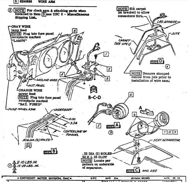

Check with www.hemmings.com or yellow pages for a local auto clock/instrument repair shop.
Could be the contacts need some emery paper as a solenoid energizes for a second to rewind the main spring.
Spring runs out, contacts close, solenoid energizes winding the spring.
Endless cycle until battery dies.
Here's the attachment/install.
