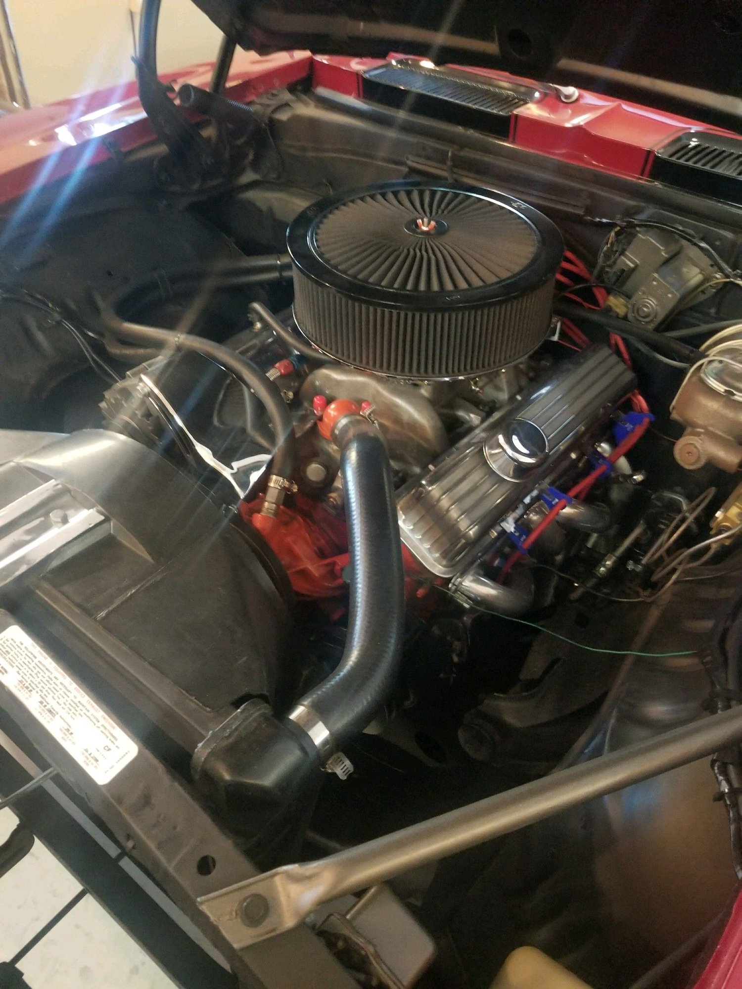

I would really like to keep the old-school 350.
How much hp/torque could I expect from some decent heads, cam, intake swap?
i know the '71 had a much lower compression (I think around (8.5/1) than the previous models.
Maybe I could increase the compression for a decent gain?

I've got some headers hooked to flowmasters, and a Holley 670 carb, roller rocker arms, MSD distributor but everything else is pretty much stock from what I can tell. Still the original winters intake manifold and stock heads.
I appreciate any parts advice you guys may have to up the power numbers. I wouldnt mind spending a little more money to turn a few more heads.

I would like to rebuild the motor if I could do it on a budget ($2-3k). I checked the casting on the heads and they showed 3973487 which came back to a 71 350 engine. I'm assuming the cam is still original as well.
Im beginning to think I could put in a crate from somewhere like summit for not much more money and come out better in the long run.
