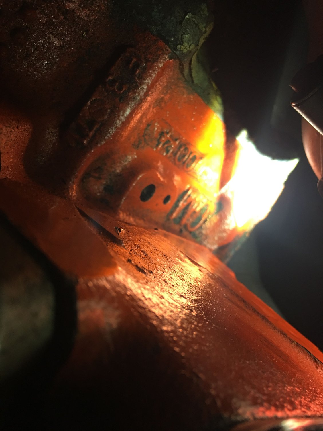

Does anyone have information that would help me identifying where this engine? The casting number reads "3970014" and I believe the date code is "F 3 71"?
Any information would be greatly appreciated.
Thanks in advance.

From Mortec:
3970014....350...70-76...2 or 4 - meaning 2 or 4 bolt main caps
Old Feb 10, 2019 | 11:43 AM
1968-75 350. 200 or 255 h.p. Get the numbers off the block pad that's in front of the passenger side head. The suffix code, (there as long as the block hasn't been decked) will tell what vehicle it came out of.

Thanks for the quick replies guys!
I'll check on the other numbers and go from there.
The car is a 69 so I'm guessing this definetly is not the original 350 for the car?

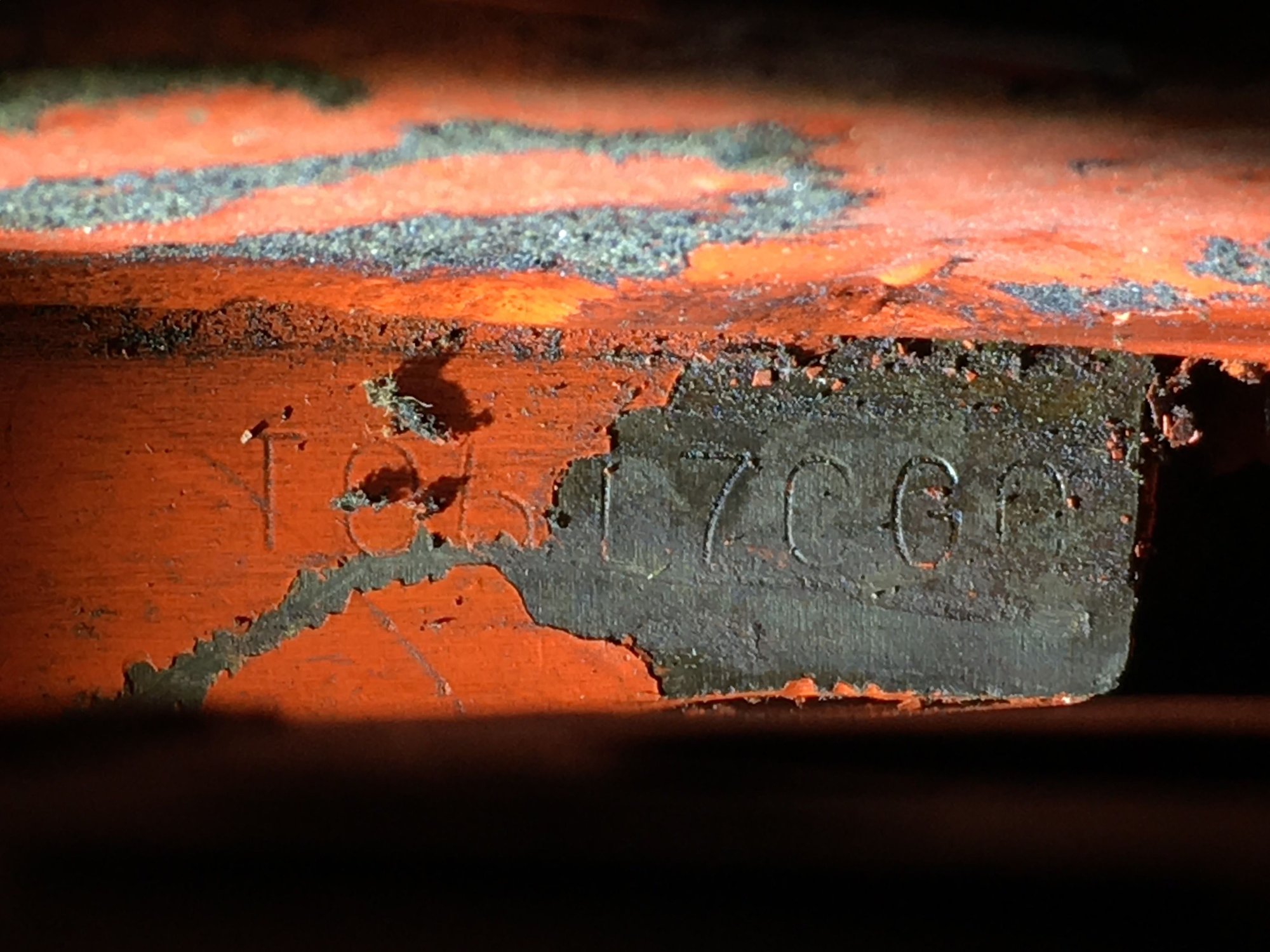

I was was able to get the following numbers off the front passenger side of the engine block. Looks like:
11B23290
T06670G0? (Not sure on this one)
Again, any help would be appreciated. I've looked online and can't seem to make heads or tails of the info.
Old Feb 10, 2019 | 06:04 PM
Some suffix codes are 2 letter, some are three. Any chance those letters could be CGC? Kind of looks like it from here. That would make it a 1971 350 (jives with the casting date), 245 h.p., 2 bolt main, was mated to a powerglide trans.

That would also explain why I couldn't find a suffix code for OGO.
Was hoping to have an original 350.
Thanks a lot for the help!

I checked that code CGC in the Chevy parts catalog. 1971 350ci 245hp in a full size Chevy (no other model) with manual trans. CGB shows up for 1971 in several models as a 350/245hp with powerglide.
