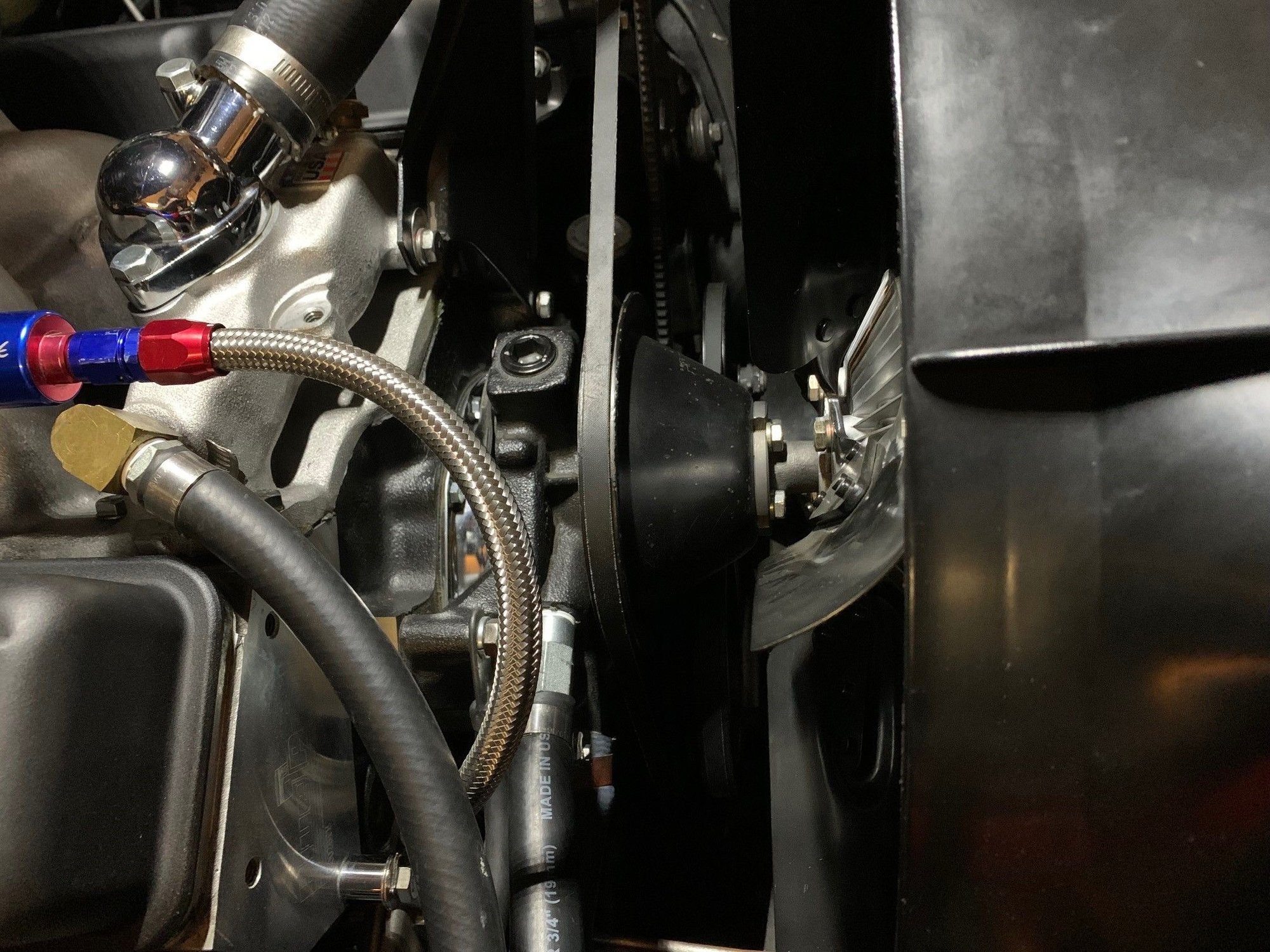

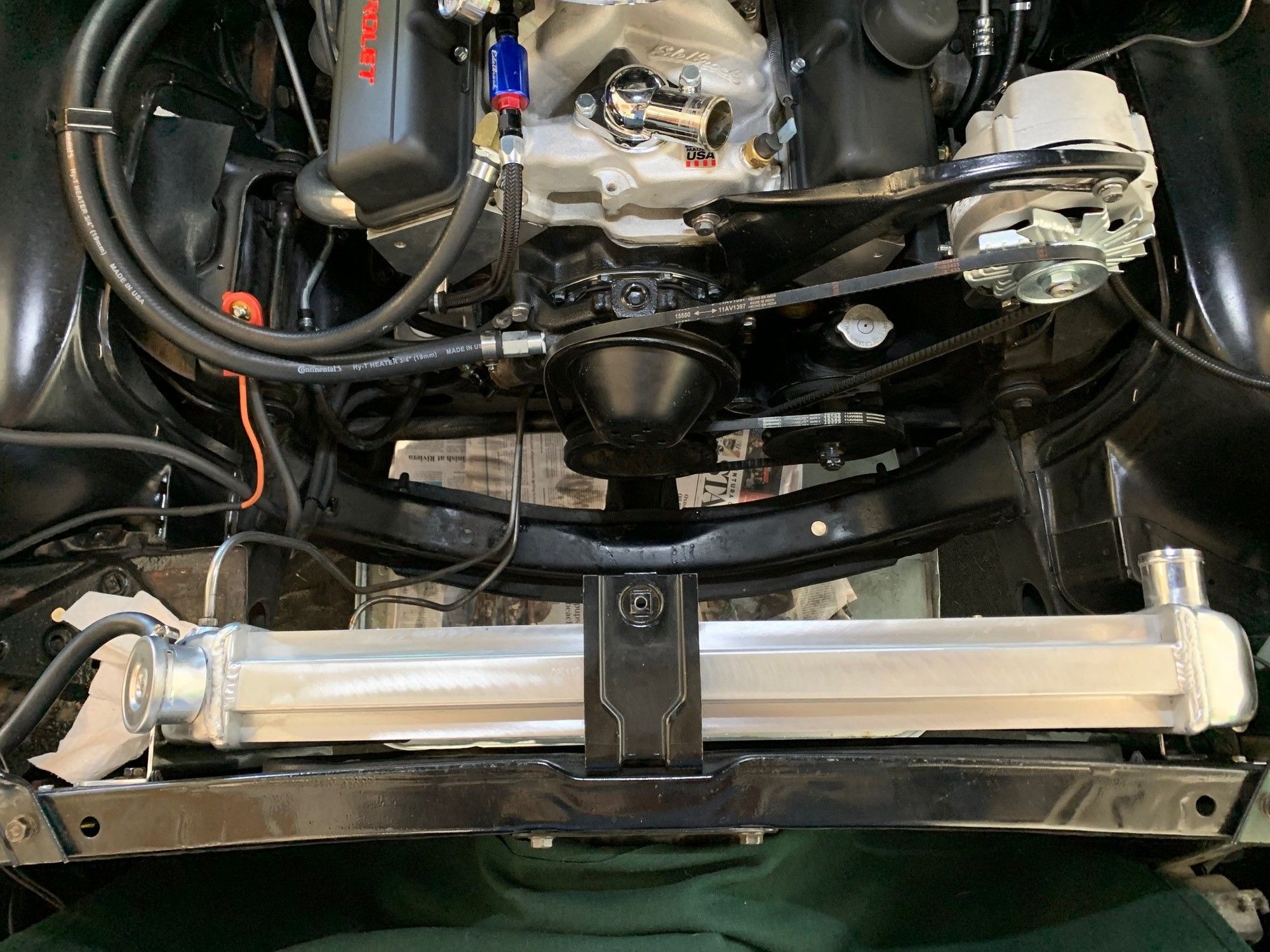

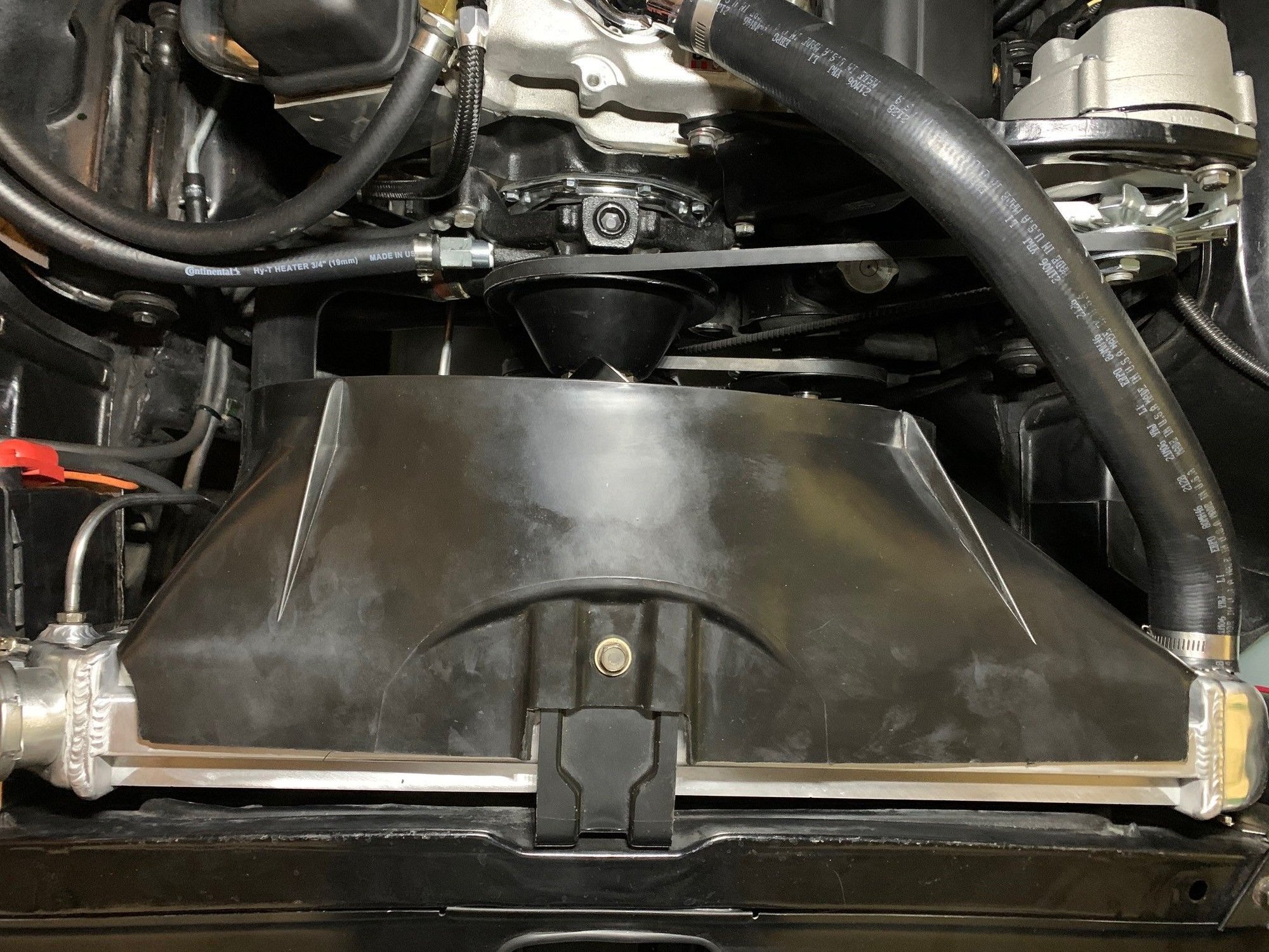

My 67
Fan wants to be 1/2 in/out of shroud.
OER makes both the 21 and 23" camaro shrouds. Summit
