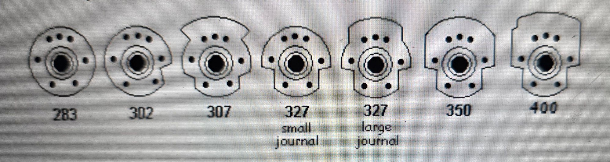

The build date numbers are on the back of the block
You can tell what crank is in the engine by the flange
Those 302's had a mostly round flange
