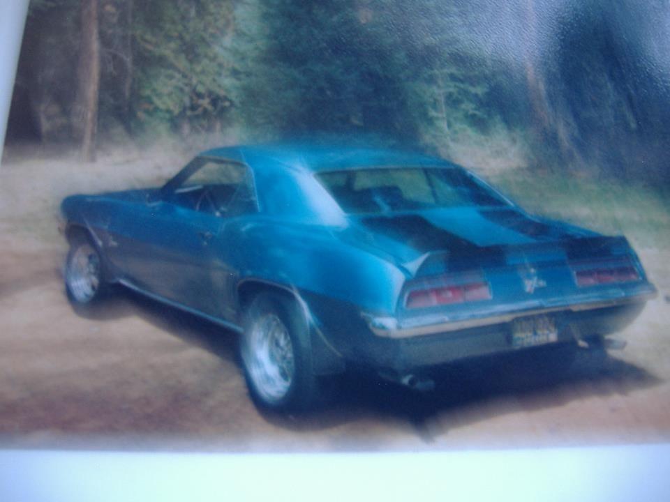

That's the way they were,my '69 was like that and so was my old roomies Z28 pictured here,fuzzy pic taken in the 1970's.

The early 69's used leftover 68 spoilers, which were narrower than the rear width of the 69. When those were depleted, the new full width spoilers were used.
