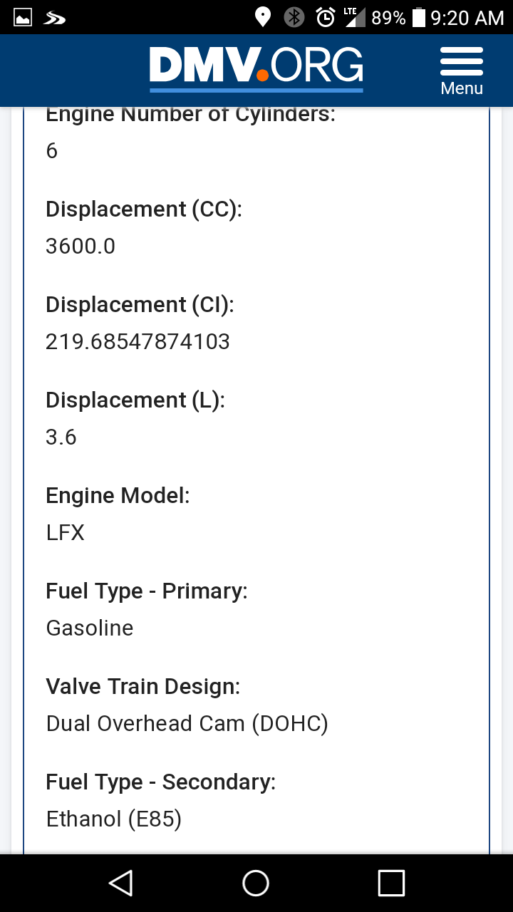

So i did a vin search through the dmv on my 14 camaro and it list e85 as an alternative fuel and in Missouri its cheaper than the other unleaded fuels but i was wondering are they able to run it?

ok so it says not to but then why does it list it as a fuel source to the dmv? ive added pictures but left out the vin

GM sold the car both ways, if you have a flex fuel car it will say it right on the gas cap and the inside of the Gas cap door. Cap or something was green also?
When you do cost calculation keep in mind that E85 will reduce your MPG by about 25%. So if you are getting 18 MPG on 87 octane gas then you will get around 13.5 MPG on E85. This is because E85 has less energy then gas per gallon.
