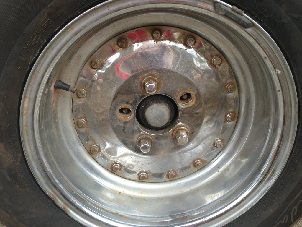

The washers used on unilug Cragars are just thick 1.25" washers. Didn't know any Cragars used a shank that long though? Most use a .75"-1" shank length. Hope those don't bottom out!

Yeah here's a pic of them. they could use a polish
