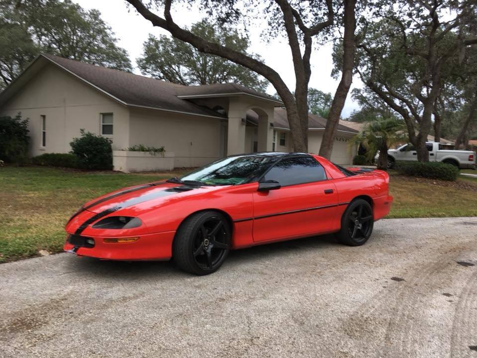

Hey Everyone,
I recently picked up this 97 v6 for my son, who will be turning 16 in March. We gave it a quick cleanup and noted the various broken interior pieces that we need to start swapping out as well as a leaking exhaust and non-working turn signals. Hoping to read up on any known issues with the platform so we can make it as reliable / fun as possible for him over the next 4 months.
