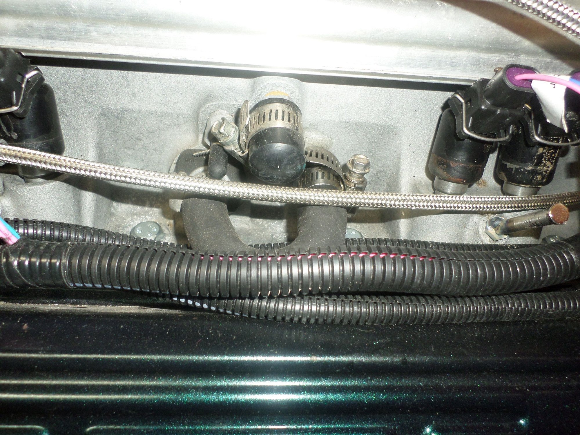

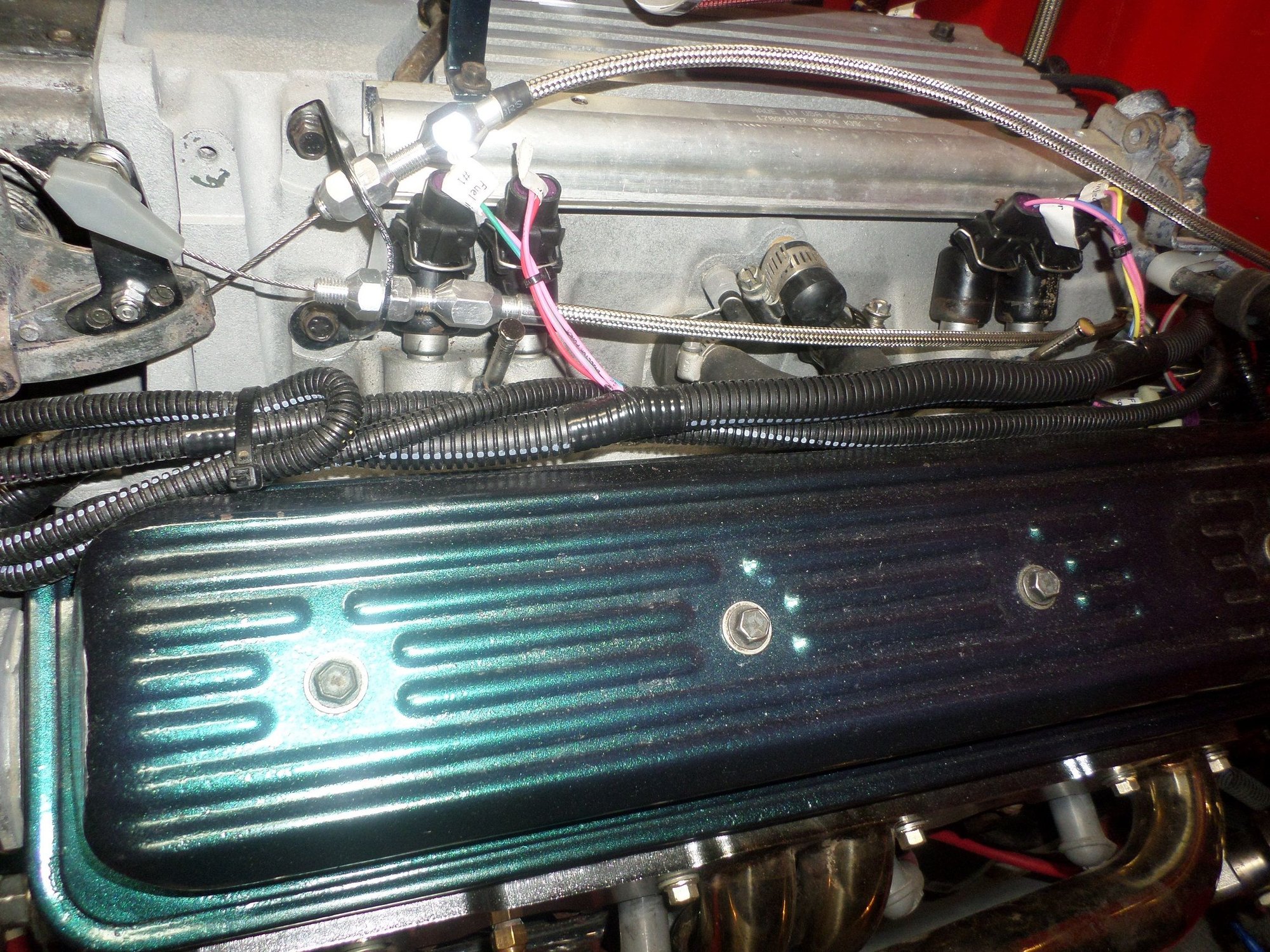

Now for the PCV system. Not to sure about how things are set up on my engine. There is a hose running from the passenger side valve cover to the throttle body but the PCV on the other side of the intake is blocked off. The connection for the PCV hose under the throttle body is also blocked off with a screw in plug. Is this normal?

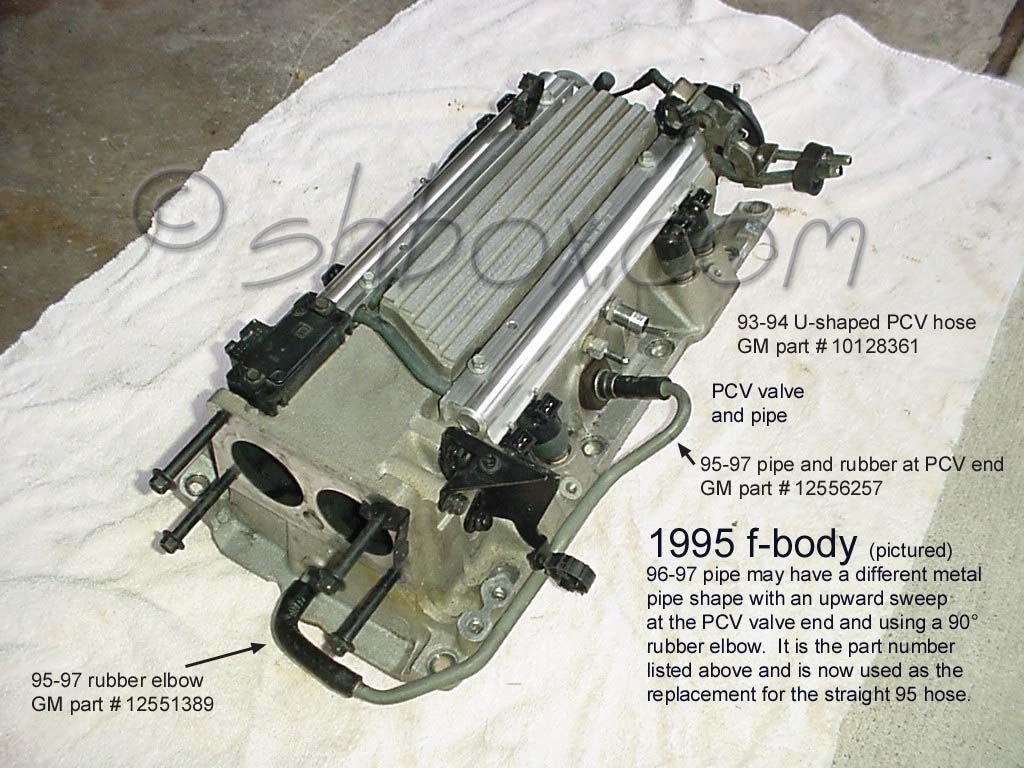

can you post a picture, this is how it should be. the other hose on the passenger side allows air from the intake to go into the motor to keep air flowing through the engine.
http://shbox.com/1/pcv_pipe.jpg

Thank you Craby. sorry but can't really get a good picture of the area under the throttle body. It's just a screw in plug that's there and the port on the left side of the intake is capped. How will this affect the engine?
