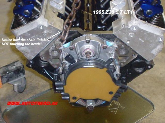

ok i make sure i dont loosen up the tranny mount, but i still have not gotten info on what kind of chain to use to lift the motor, also yes i know i ask too many question, were do i lift the motor from?? were to i position the chain that i need to get in order to lift the motor

Ok..fairly beefy chain is recommended.

so i just lift from that point?not anywere else?

Also the chain can be obtained in an engine leveling kit or from home depot that can hold about 700 lbs. But you should be able to hook it up to an accessory bracket bolt or on an intake bolt.

ok so this saturday i will be replacing the gasket to the oil pan, now you said to hook it up to an accessory braket bolt or a intake bolt, is there a picture? to an intake bolt or a accessory bolt??
