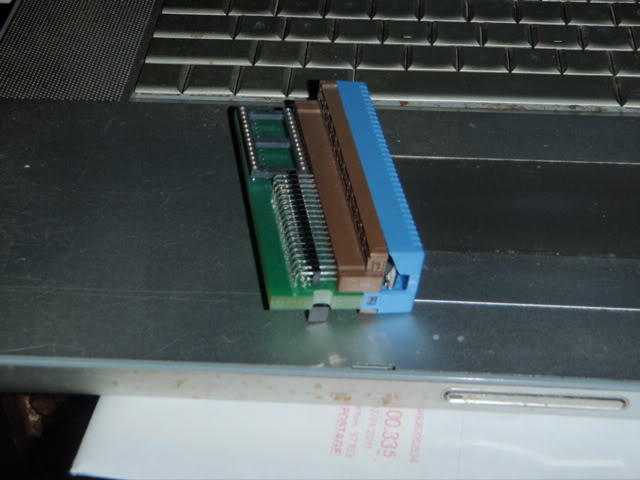

take the pcm out and look inside to see if you have any water damage and see if you have an aftermarket tune chip. tune chip can go bad.
93pcm
prom with tune chip adapter

Nah it's still got the stock chip in it I'm pretty sure, I can check tomorrow after work tho. So do you think it would only be the chip or could the computer itself cause it too? I'm also planning on cleaning all my grounds tomorrow too.

Well I went and cleaned all my grounds and checked the wires best I could, everything looked alright. If I was getting excess voltage to the ICM I would think that would have shown when I was testing all my connections tho. I went ahead and pulled out my prom chip and was rather surprised to see a hypertech chip attached, my car deff didn't feel like it had any more power or anything than any other camaros on the road. I didn't get a chance to put it all back together tho tonight it got waaay to windy get blowing my worklight down then would switch and blow the hood down on my head lol.

take the chip out and see if that helps. not a fan of hyprtech

And yeah I've sold a ton of hypertech at work and never really heard anything about them but I looked on their website last night, apparently all the hypertech chip does for the 93 is tune it for higher octane so I guess 93 instead of 91. That's kinda rediculous to spend little over 200 bucks for a chip that barely changes anything.
But on the bright side I got her started! After cleaning all my grounds and taking the hypertech chip out she fired right up. I decided to put the chip back in just to see if it was the grounds that was the problem or the chip causing it. It still started up right away with the chip in so I guess I must have just got a bad ground connection somewhere. I did find out one of the mounting screws for the ICM was stripped so I had to tap out the base plate and put a slightly larger screw in but other than that everything had seemed fine. So for now I'm gonna drive it around and hope she doesn't die on me again.
If I get a tuned chip from solomon will I still need the tune chip adapter or will his just plug in where my original chip plugs in?

lose the hypertech chip. most just up the fuel. doesnt really add power but gives the feel of it. i have one here somewhere that was in my first 93. ran better without it. solomon uses the adapter in the pic i posted. i think you still get a re tune with each tune.
