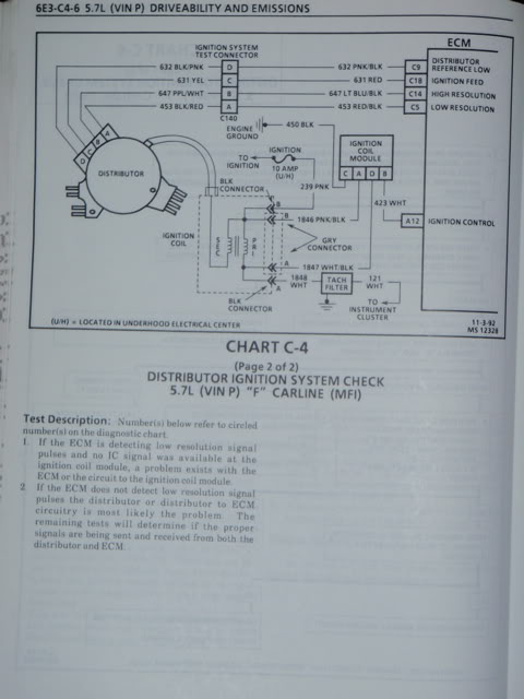

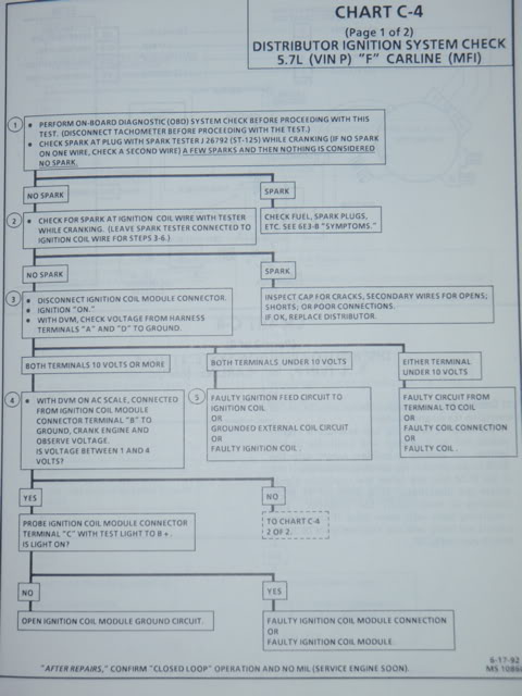

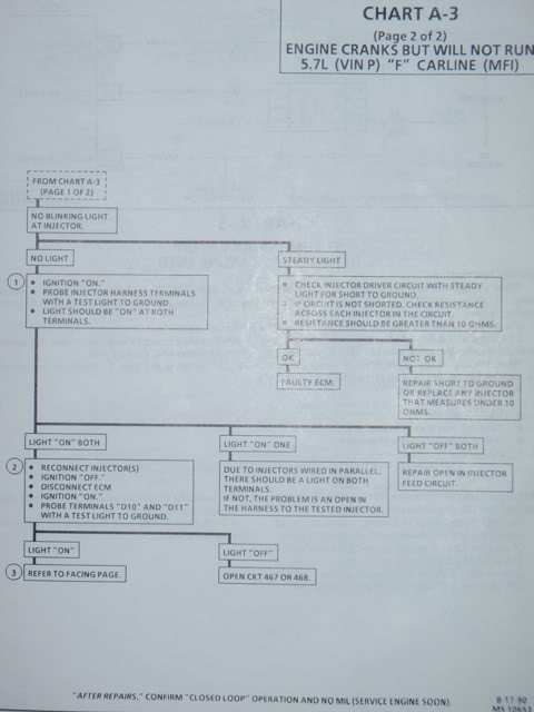

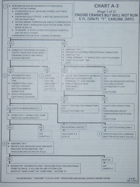

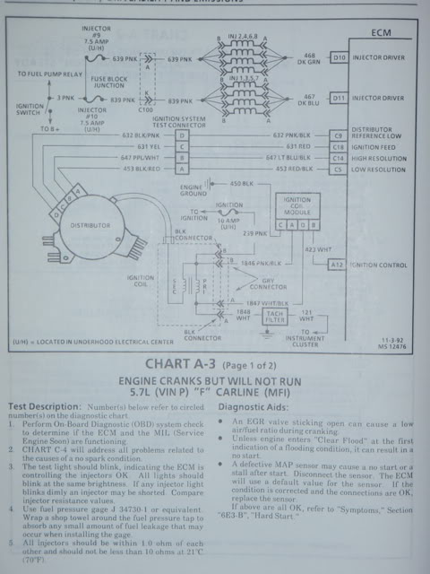

Size:  57.8 KBName:  P6030002_1-1.jpg
Size:  49.5 KBName:  P3170041_1.jpg
Size:  61.2 KBName:  P7150004.jpg
Size:  64.5 KBName:  P7150006.jpg

Within 24 hours, car became really hard to start. My original problem is no spark out of coil, now I've spark, NO FUEL. When I turn the key on, the pump will come on. But when I crank the engine, the pump will not stay on. I bypassed the ignition and keep the pump stay on, still no start. I noticed there's no fuel out of injector. Btw, the engine will start on ether.

test the tps and map. check the fuses for the injectors. have you put a noid light on the injector plug to see if they are being told to fire by the ecu.
