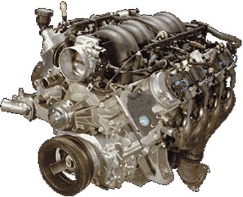

yah i posted a couple pictures of a lt1 i thought someone might post one or two of a ls motor.

lt1s have a very distinct intake than lt1's very different, the intake on the pics is same as lt1, ls1 has the rounded look like this
