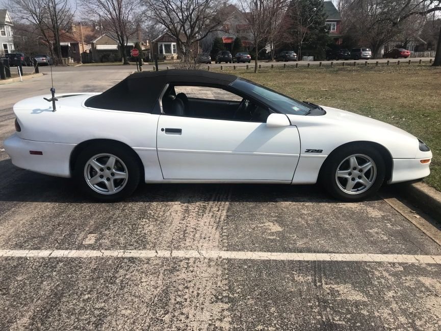

So, the motor is back together, and running right. The hose at the firewall did turn out to be a trans vent. I intend to do another oil and filter change in a few miles to hopefully trap whatever metal shavings were ground into the motor from the drive gear. I'm sure some got in places that it shouldn't be, but I can only hope no further damage occurs. The car is going up for sale now, as I am moving to Arizona and can't take it with me. Anyone need a nice summer car?
