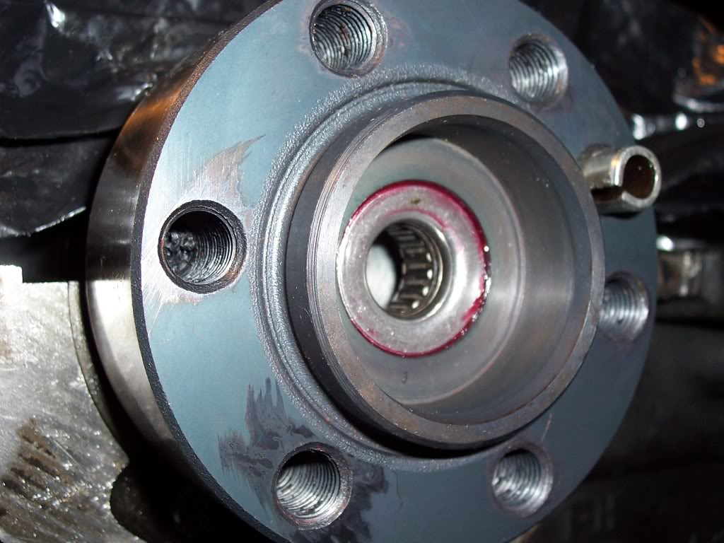

My GM roller pilot bearing installed with ease, lightly buttered with red loctite. Name:  100_1364.jpg

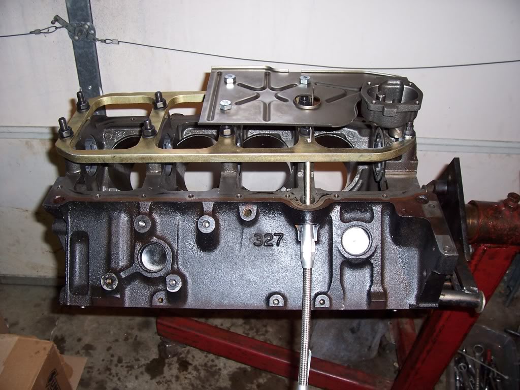

I just got done fabing up the stud girdle. Tying everything in instead of drilling/splaying new caps into the webbing of the block just makes sense to me.

Ready for the machine shop, to do a main line hone and bore/hone .30 over! Got the oil pan ready too!Name:  100_1365.jpg

Ya this was the first time it's been off and cleaned too. It was covered in oily grit and hair! Right next to the exhaust, I know that was stinkin!!
I'm freaking out. I don't want to put the crank in and do any clearancing. Well, because I can't put the rods and pistons on yet. Is the machinest going to clean it good. I hope he installs the steel ball and freeze plugs right. I think I am going to let him assemble it! Those are the original bearings in the pic. I figured maybe he would use those for checking and clearancing, then break out the tri-armor bearings, those bearings take more clearance to, I aint' toachen'um!
