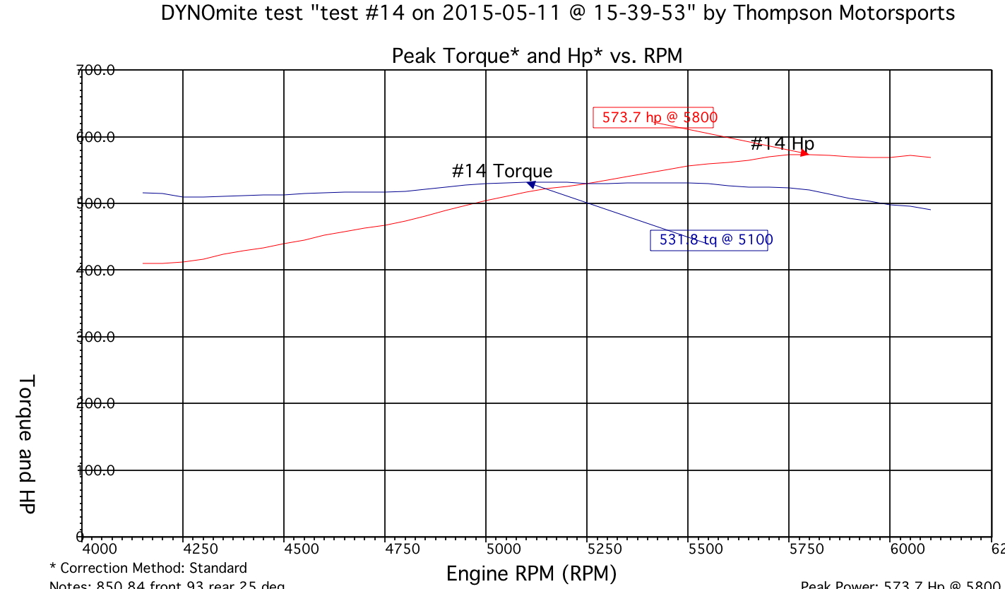

FINALLY got the engine dyno chart from TMS. On the 6th Gen Camaro the HP AND TQ is 455, but mine has a big gap between HP & TQ — seems like that might indicate a not quite ideal combo of parts? Or can anyone shed more light on why the two split off like that?

I don't know the LSX motors but I did Dyno a lot of circle track cars back in the day. I think those Torque and HP curve look good. In fact they look way more streetable then what I use to seeing. Is that pump gas?
Do you get a copy of the tune they used? You have some limitation on what you can change on the curve due to Heads and Cam and to some extent intake but you can do a lot to tweak the curve with timing and fuel maping.

Those numbers look good to me, Nice flat Torque curve that's above 500 ft. lbs.!
