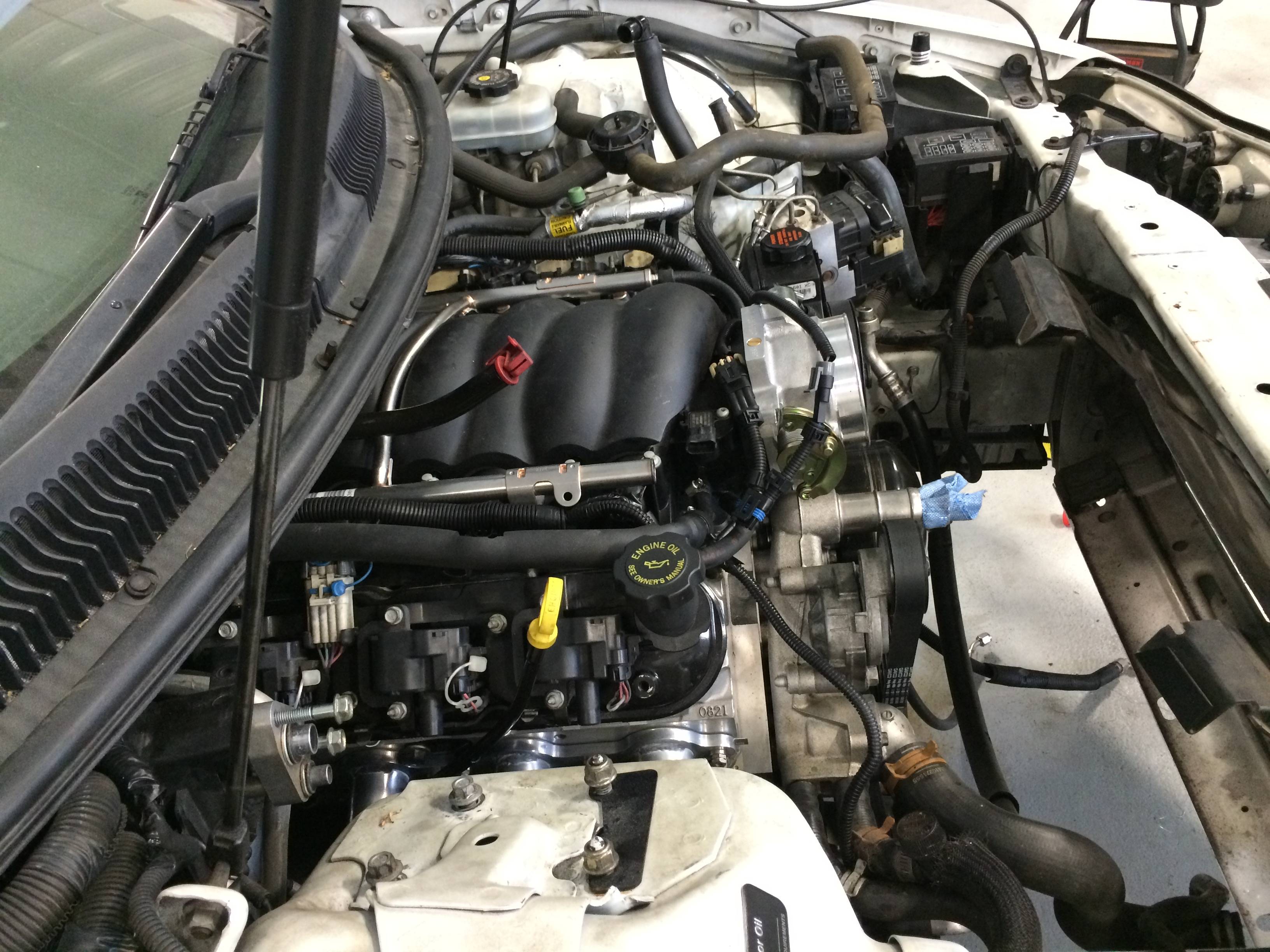

I decided to go with PLX Devices gauges in a 3-pod pillar cluster - A/F, Trans Temp & Oil Temp. Here's the empty engine bay, and the new engine was just put in the car!

She's in the bay! Wait till you all see the carnage on my LS1 , will post more photos soon... Probably the only thing worth saving is the heads.
