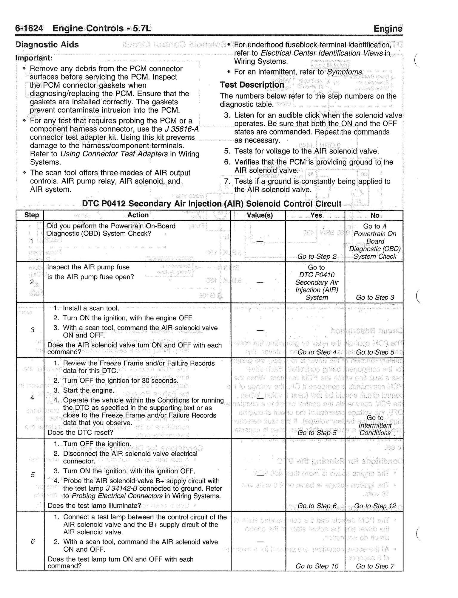

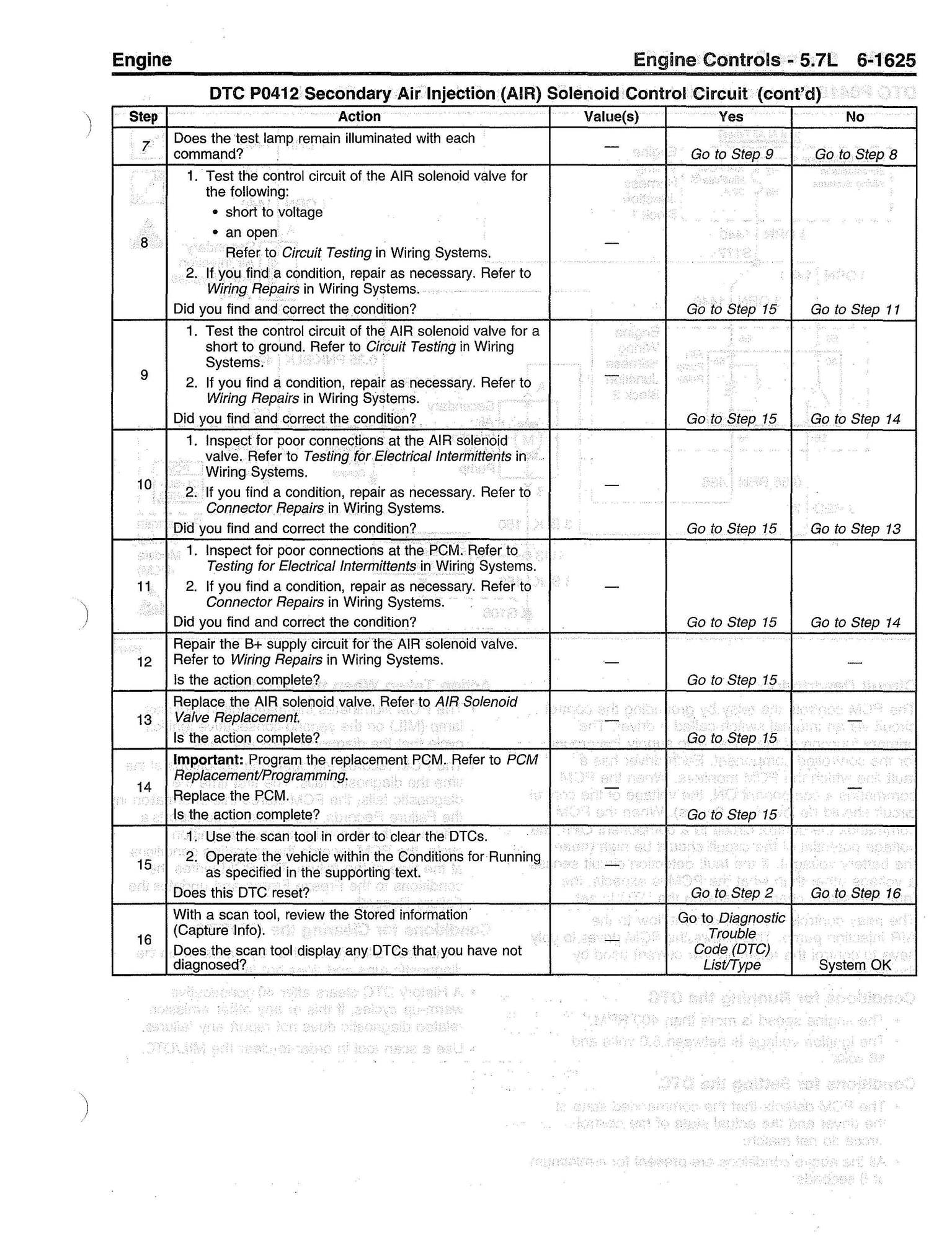

I don't know if I can be much help with your problem. My experience with solving DTC code issues is limited to my own cars and I have had very few of them over the years. Something that I have found helpful is a copy of the service manual and a GM Tech 2 scanner. The manual will have an explanation of the code and what conditions will set it, plus a chart to troubleshooting it. The DTC P0412 code pages below are from the 2000 service manual, but they are the same as 2002. Hopefully, they can help. A 2000 Service Manual can be downloaded at this link.

That's a big help!
Thanks again!
