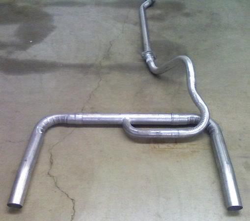

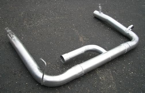

Here's what I put on my 91, I'm still trying to find where I archived the pics of the 96. [:@]
It's a complete "cat back" system that I found on ebay. Price was relatively inexpensive too. It has bolt-together flanges before the rear axle, which is nice if you ever want to remove the exhaust without having to cut it up. I welded the whole back section together and also welded on the stock hangers, and an extra one at each tailpipe.
