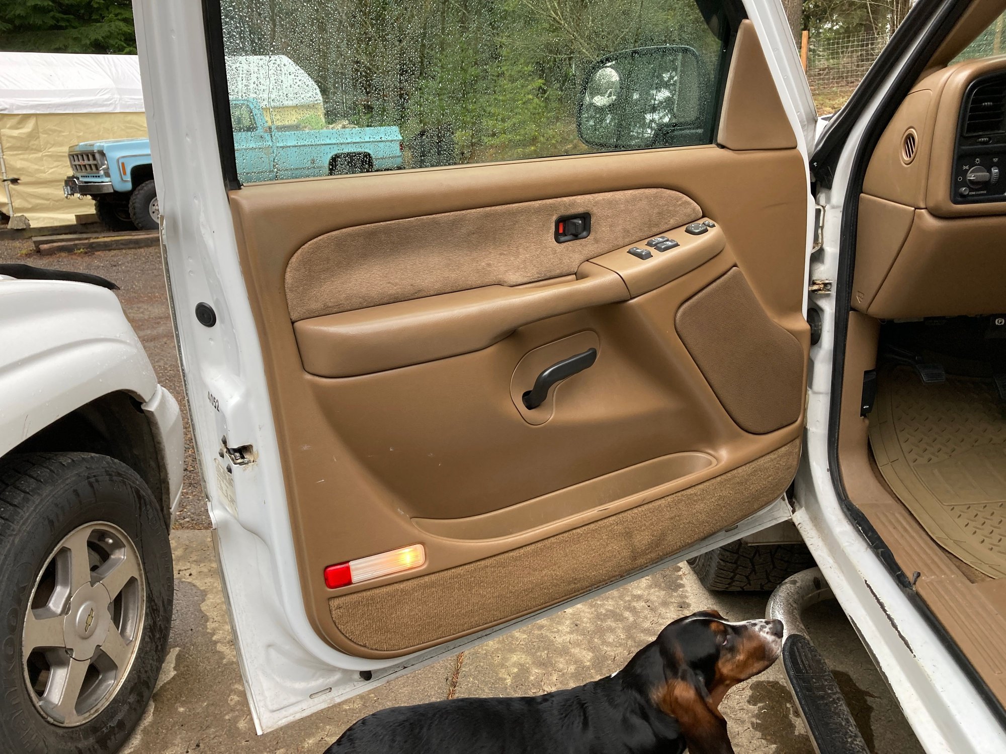

Fixed a few other things as well,replaced a broken courtesy light fixture on the driver's door panel and replaced the bulb in it and the other side and the dome light,all work now.
The passenger side didn't have a bulb in it and the wire had dropped down inside the door so I had to pull the door panel off to find it.
While in there I cleaned and lubed the door lock actuator shaft clips,the grease was hardened and the lock wouldn't work with the electric switch,works great now.

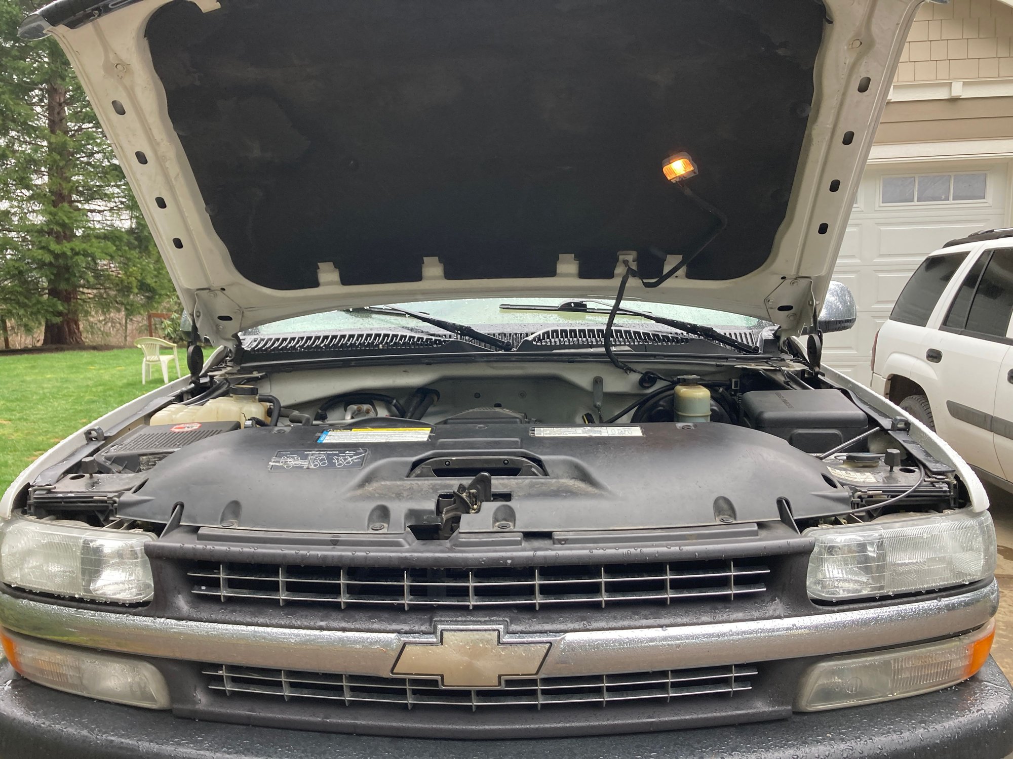

The engine bay light wasn't working so I checked it out,good bulb and power to the plug,took it apart and cleaned the gravity switch and it works now.

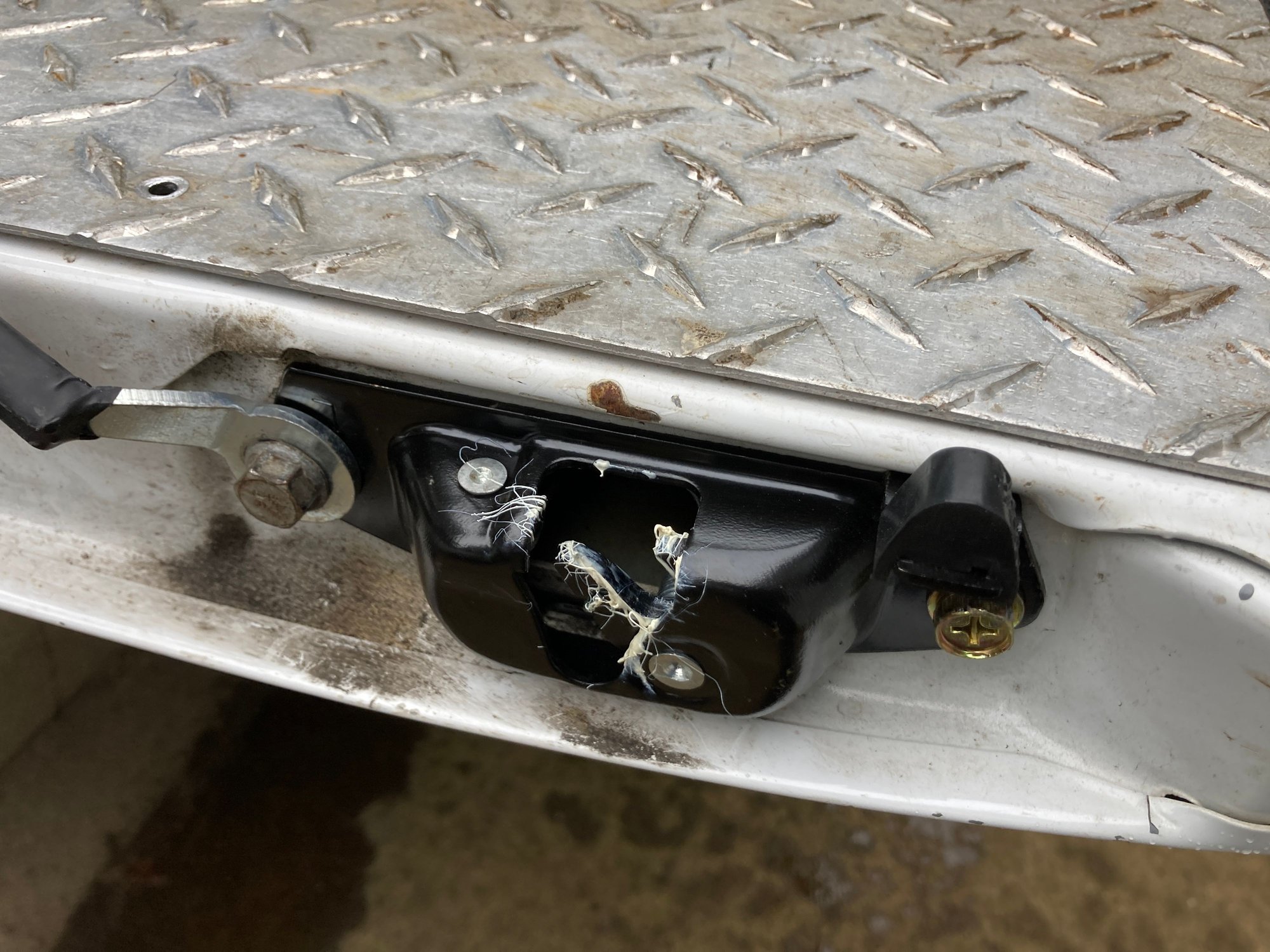

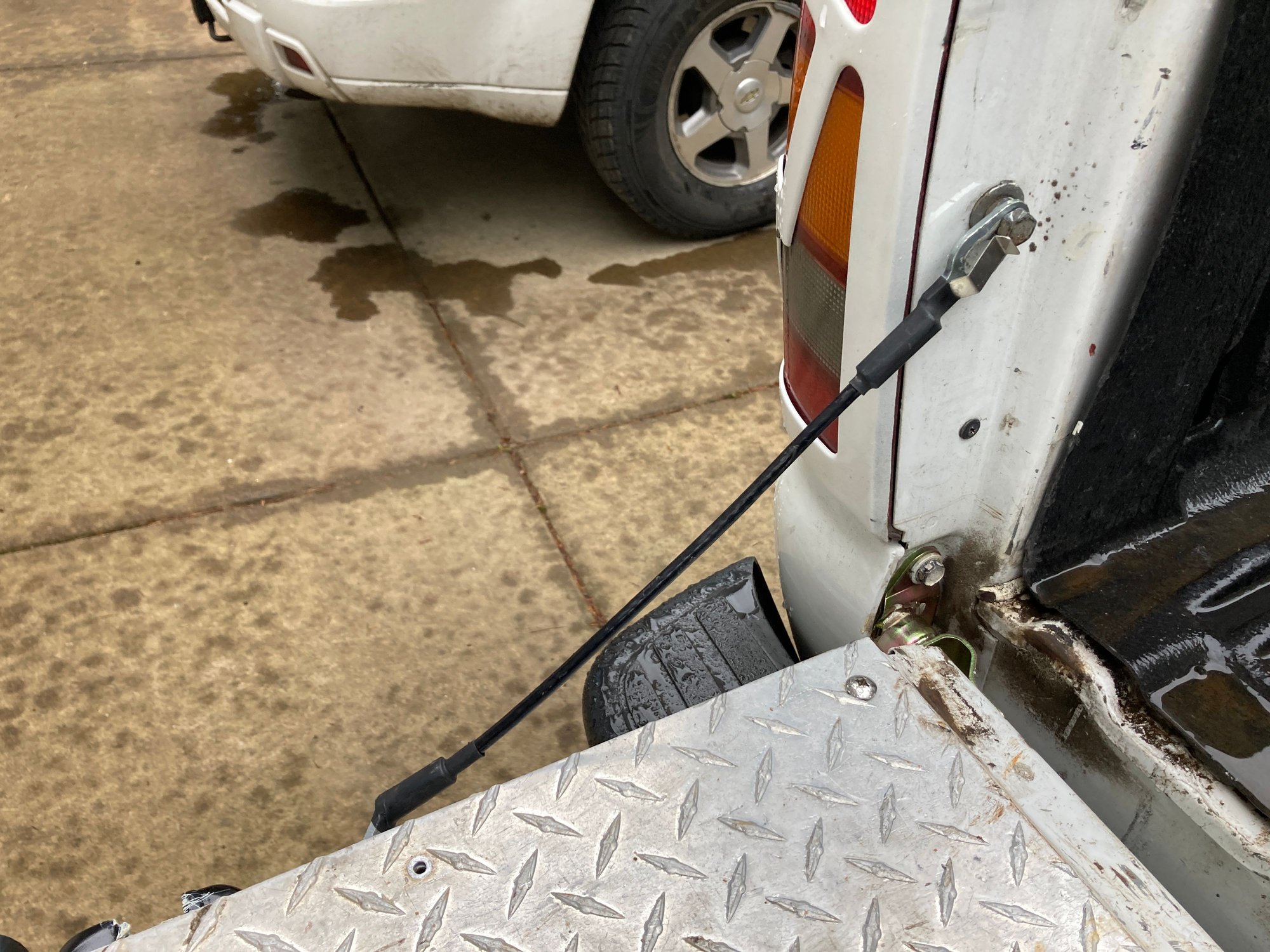

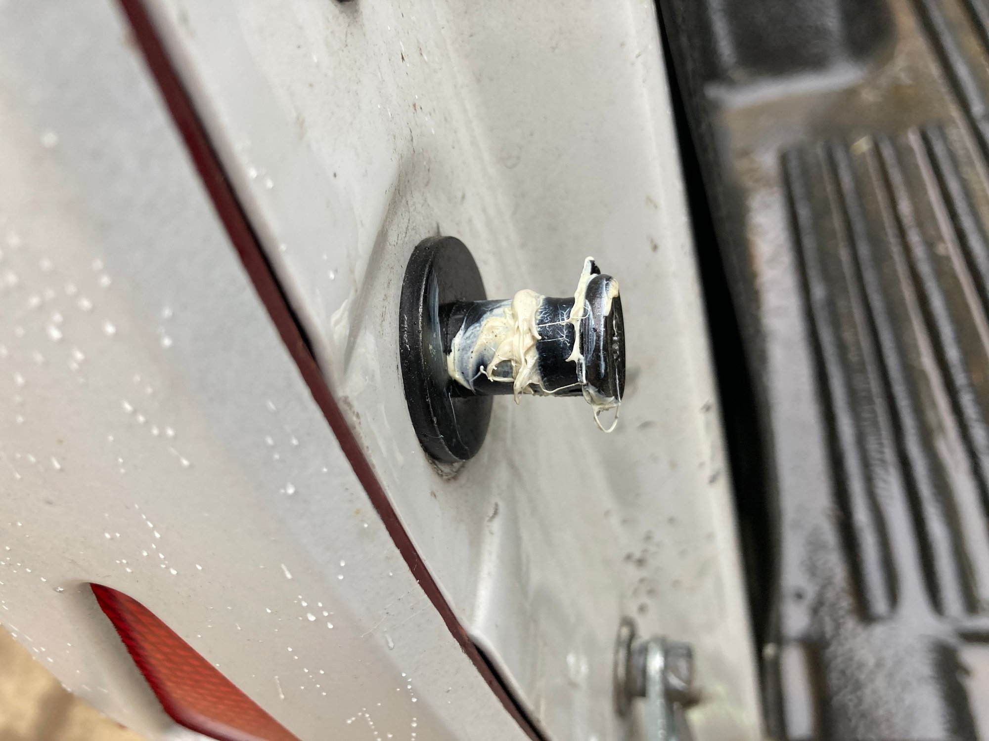

The tailgate was a mess,the hinges and latches were shot,one of the support cables broken and the striker bolts worn out so it rattled and didn't like to shut.
I replaced all those parts with new and she shuts tight now like it should.

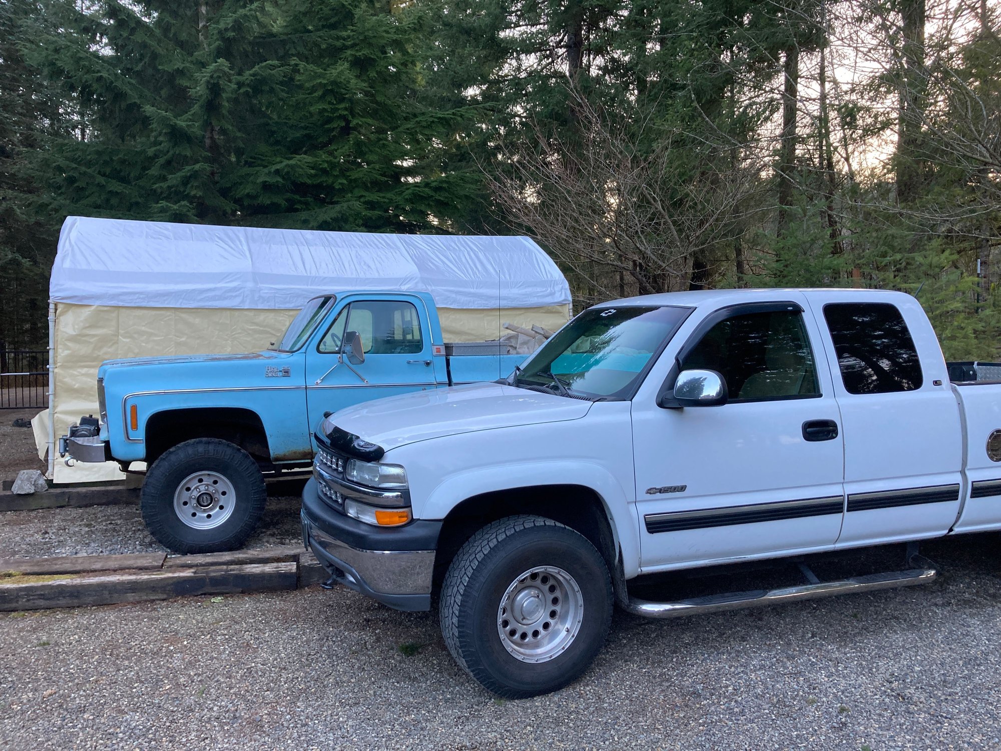

Well last weekend I fixed the daytime driving lights with new sockets and bulbs on project '99 Silverado and the reseal I did on the housings seems to have worked,I drove through rain off and on during the week and so far no water in them and they still work.
This week I installed a new power mirror switch and the mirrors now work like new and I pulled the door panel to clean and lube the electric door lock actuator rod tracks and got that working,did the other side earlier so my locks work with the switch now on both sides.
Today I installed my new KYB Excel-G shocks front and back so she has a much smoother ride.
Project '99 Silverado is coming right along.
Next up I'll tackle the driver's door hinge pin and bushing job.
