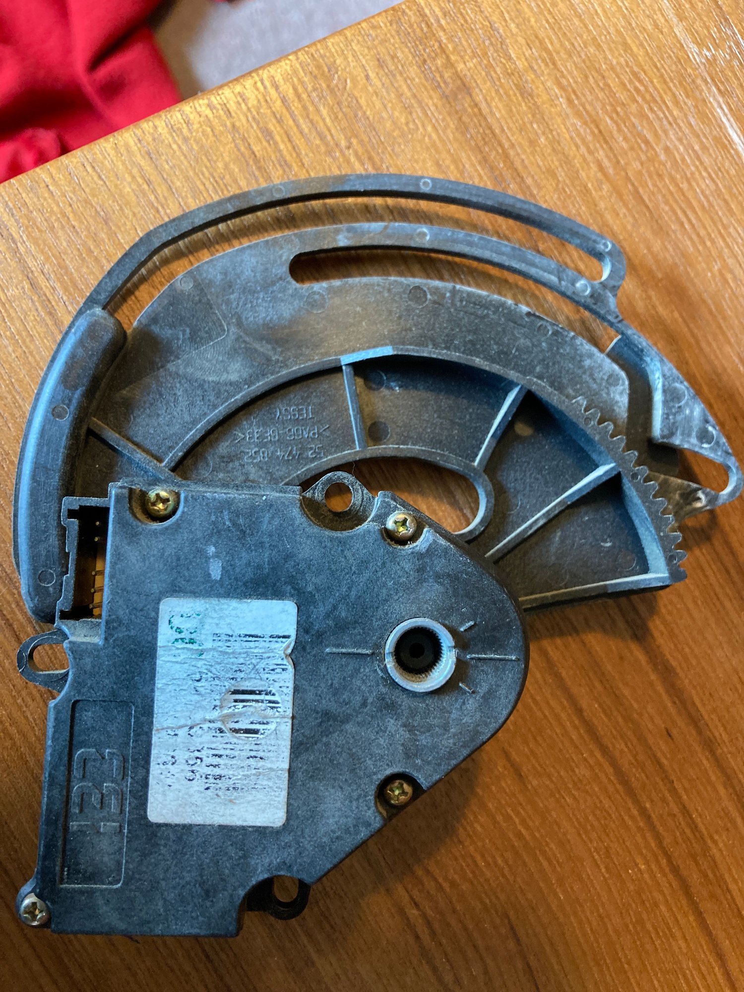

What I've done so far is pulled the cover and removed the blend door actuator thinking it may be the culprit,I had a plastic gear inside the actuator break on my old S10 and a replacement was the fix so I hoped it would be on this truck as well.
I've also replaced the cabin air filters which were filthy,after that and moving the blend door by hand I now have better heat and some defroster air but still not what I would consider normal.
There is good heat heat so the heater core is fine,the fan seems to be kicking it in all settings and makes plenty of noise like its working but still not moving as much air as I would expect. Maybe because the bottom cover is still off?
Getting back to the blend door actuator,I took the cover off it only to find nothing broken,the gears turn freely and the motor spins free,I hooked it up with the cover off and with the gears out, the motor started spinning as soon as I turned the heater to the on position. I put the gears back in and it spun the gears as far as it could go and stopped.I tried switching the selector **** to a different setting to see if it would reverse and nothing,it only spins one direction until it goes as far as it can then stops. So now I'm not sure if the switch is bad or if its something electrical with the blend door actuator itself,I hate to start throwing parts at it hoping for a fix.

I would start with replacing the actuator. It's not uncommon for them to fail, and they're the most likely culprit for the issue you're having.

Well I made progress this weekend after some more online research,turns out this truck actually has 3 different actuators.
The one I pulled (Blend door) had nothing wrong with it,it's the hot to cold actuator. Once I turned the right **** it went both ways doah!
So the mode actuator is on the other (driver's side),it controls where the air comes out ,defrost to floor and in between.
Not fun to get to but after pulling some duct work I could see it well enough to see if was moving when I turned the **** and it did nothing so hopefully it's the problem.
I bought Dorman replacement for $50 after quite a battle to get the old one out. I Sure hope it's not the switch lol.
The 3rd actuator is the fresh air or recirculation air door and it's way up in the dash,hopefully it's okay because it's a nightmare to get at.
