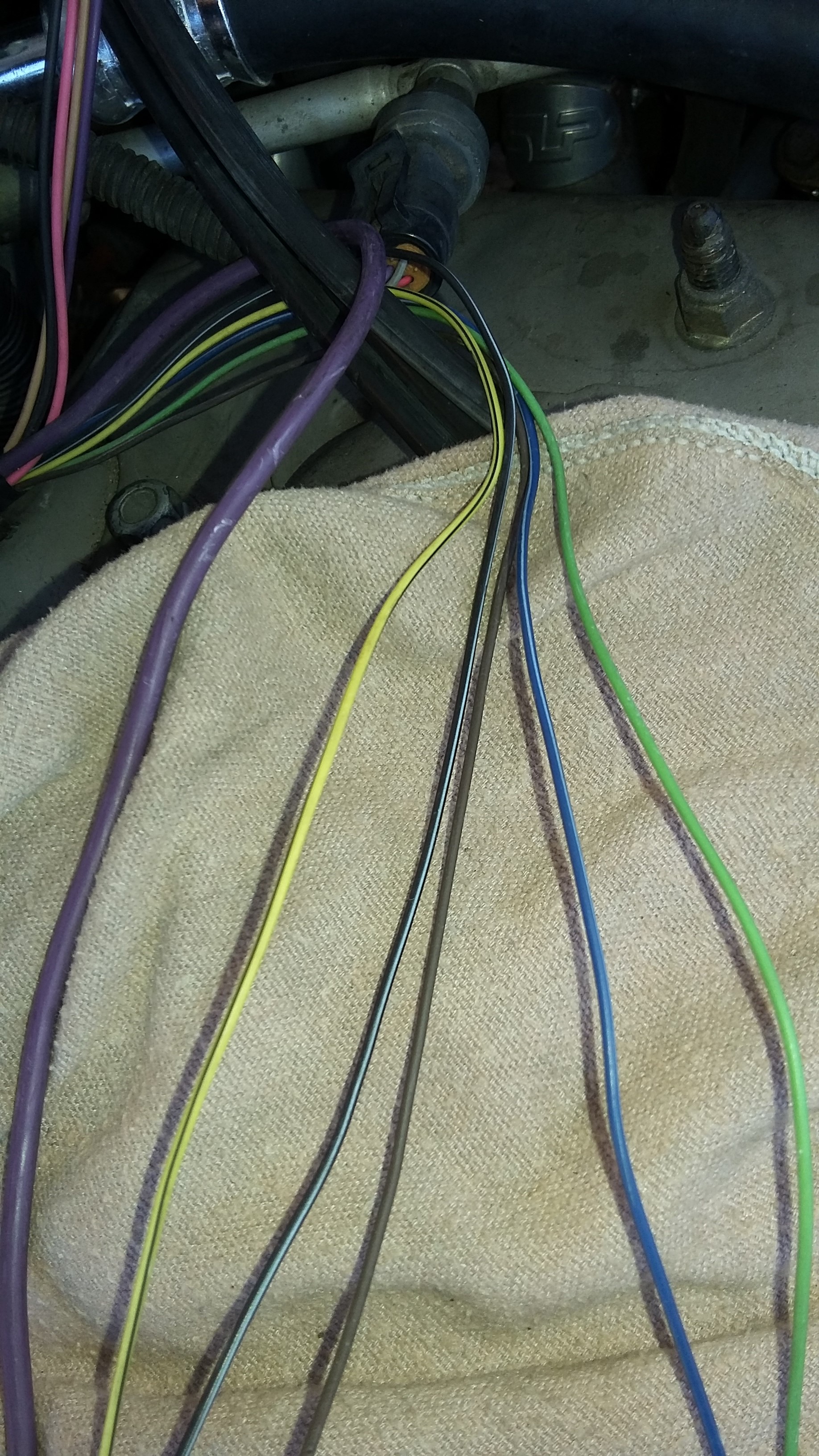

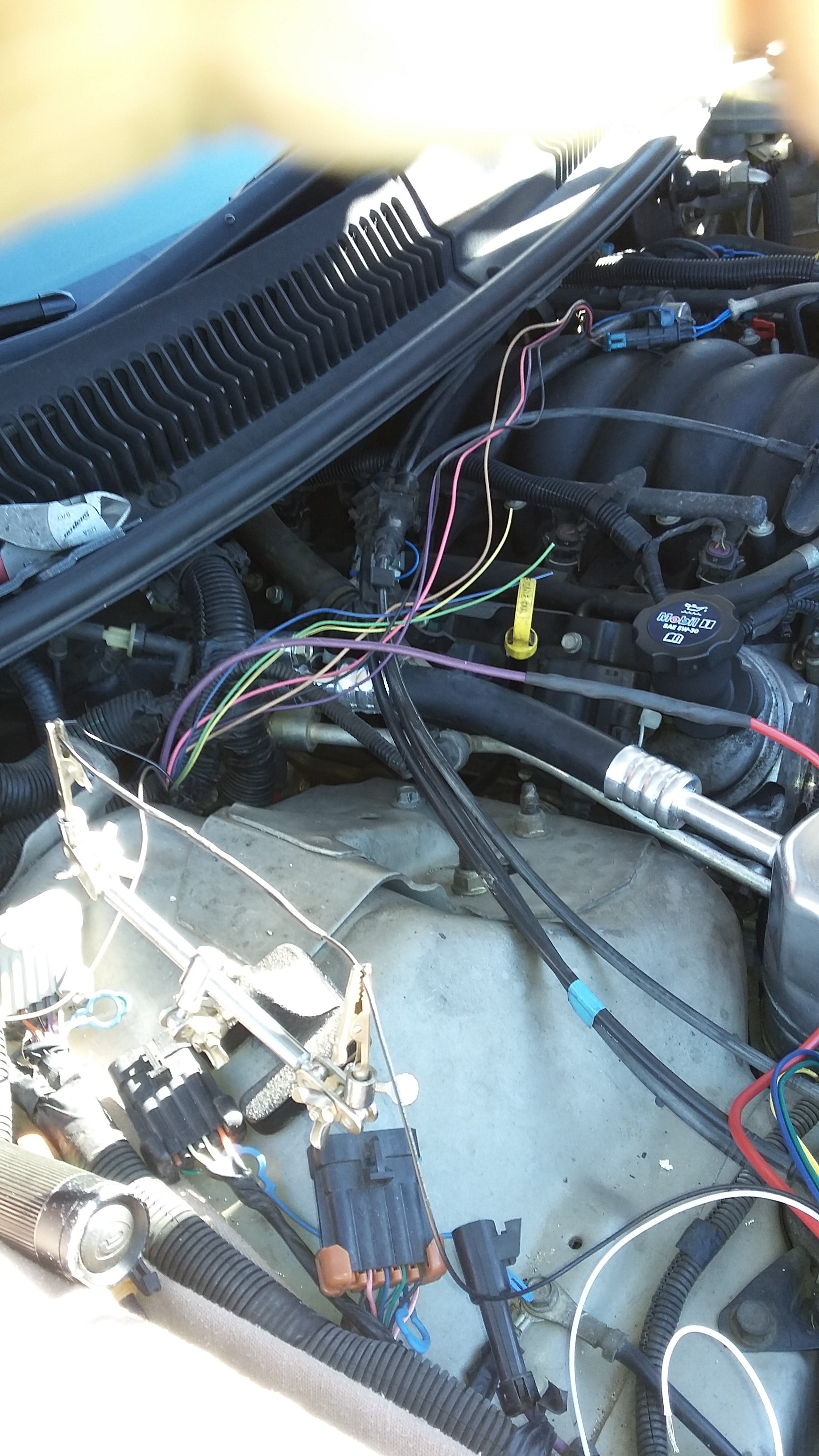

I finished the wiring yesterday. They had the wires running from beside the computers down the side of the fender and wormed it around the headers to the starter/sensors. I lengthened the wires about two feet. I soldered/shrink wrapped them and then wrapped it all in black tape. I ran them a long side the harness on the passanger side fender down behind the batters to follow the red power cable to the starter. I wrapped the wires with heat tape the closer I got to the headers/starter. I finished off the wires with convalescent tubing just like the factory uses,that way it blends with the other wires in the car.
I thought it would be a PITA to drop the starter with the headers but it wasn't. I started it a few times to make sure everything was a go. It just go's to show that people really don't do a good job when its not their stuff.
