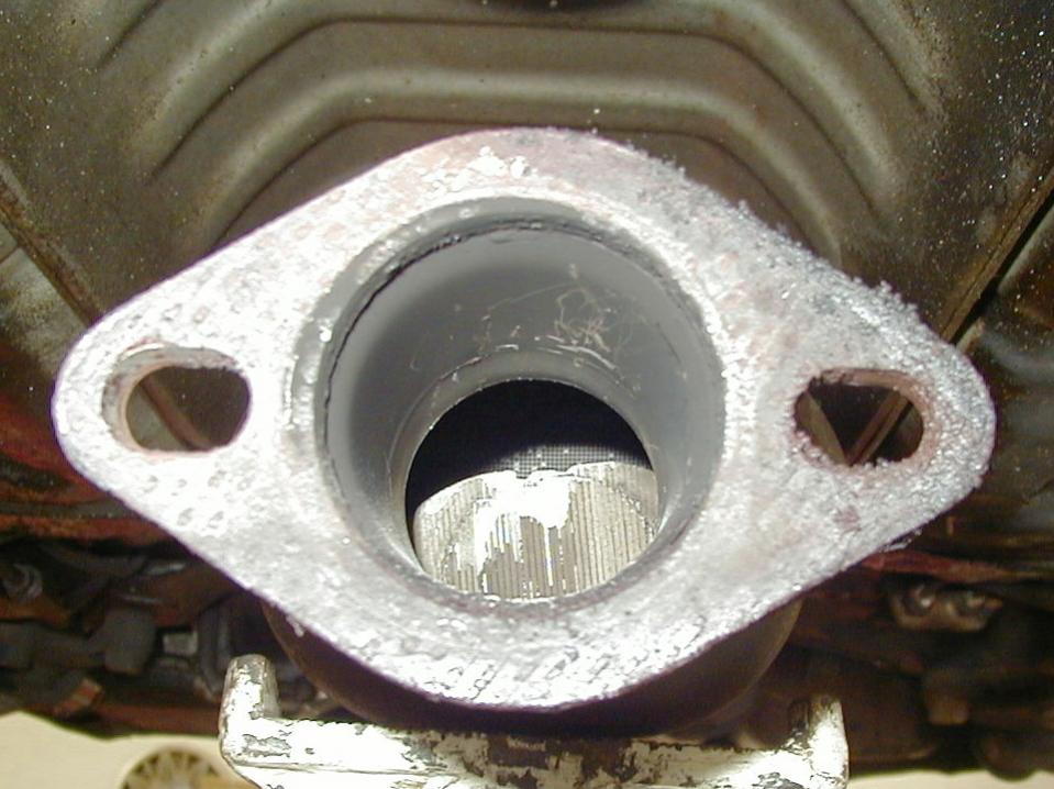

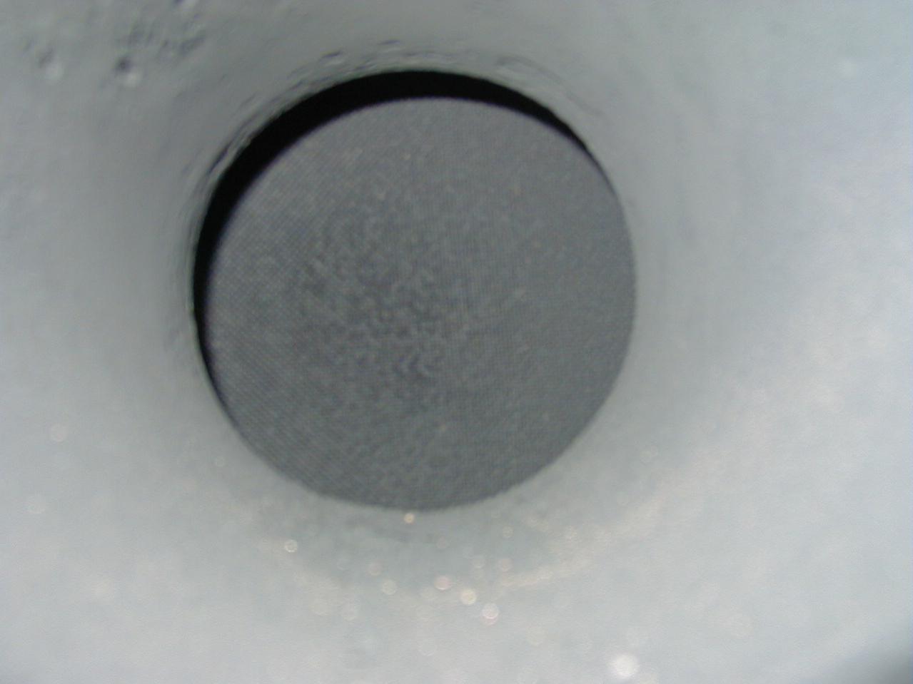

A bad cat can cause significant power loss. The cat has two "beds" which are pieces of ceramic honeycomb coated with minute amounts of precious metals. Each bed is maybe 2 inches thick and has lots of tiny parallel passages that the exhaust flows through. Each passage is too small to push a pin head through.
If you have a misfire condition that causes a lot of unburned fuel to leave the engine the converter, which operates at 600+ degrees F, burns them up. It's too much for the cat to handle, though, so it overheats (like to 1800F) and the ceramic matrix melts. All those tiny passages plug up, effectively constipating the engine.
Most of the time the blockage is just partial so the engine starts and runs but lacks power. Early 80s cadillacs had a big problem with melted cats and some wouldn't start again after you shut them down.
A bad EGR valve can cause the injection system to overfuel, again causing cat meltdown.
Sometimes the ceramic matrix breaks into pieces and moves rearward and rotates. Then it blocks the cat outlet and that will shut the engine off. A rattling noise from under the car is a sure sign that the cat innards have broken up and are moving around in there.
Here are a couple of cat pics:
Attached Thumbnails Would a bad EGR valve or cat converter cause this?-pa130007.jpg   Would a bad EGR valve or cat converter cause this?-badcat.jpg

Yeah, the stuff you posted most recently reinforces the bad cat theory. To test it just loosen the bolts/nuts that secure the exhaust headpipe to the manifolds. Chances are that the engine will start and run.
