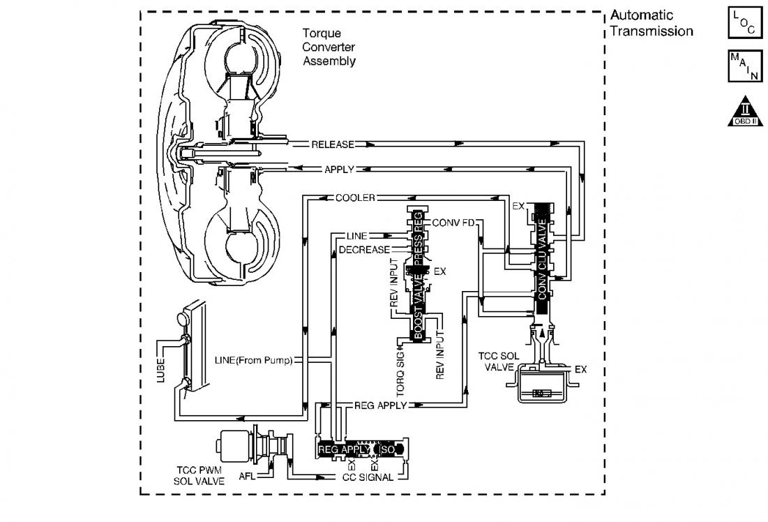

FYI:
Document ID# 194779
1998 Chevrolet/Geo Camaro
DTC P1870 Transmission Component Slipping 3.8L
DTC P1870 Range Reference Thumbnail 4L60-E (see attached picture)

Circuit Description
The Powertrain Control Module (PCM) monitors the difference between engine speed and transmission output speed. In D3 drive range with the TCC engaged, the engine speed should closely match the transmission output speed. In D4 drive range, with the TCC engaged, the TCC slip speed should be -20 to +50 RPM. The table above indicates solenoid states and transmission components that apply, during 4th gear, with the TCC commanded On.
When the PCM detects excessive TCC slip when the TCC should be engaged, then DTC P1870 sets. DTC P1870 is a type B DTC.

This step tests the torque converter for slippage while in a commanded lock-up state.
DTC P1870 Transmission Component Slipping (3.8L, VIN K)
