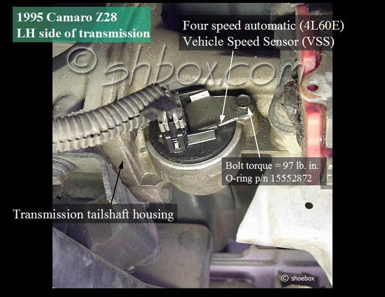

Quote:
Originally Posted by
Everett#2390
The driving gear is on the output shaft of trans.
The DRIVEN gear for speedo/reluctor is shown at the website posted - Vehicle Speed Sensor.
But the VSS doesn't have a driven gear on a 4L60E automatic?
And how do you suggest I go about changing the driving gear without dropping the trans?

that's why you need to check, some have them some do not.

if you have a gear like this on the inside of the sensor then you have gears. if not you have a reluctor. easy to pull sensor to see. one bolt.
craby
No driven gear:

well because its its obd1 the only way to adjust speedo is to have the ecm tuned or adjusted. its not easy to find anyone to do for the 94.
