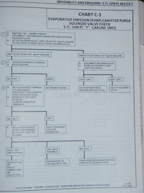

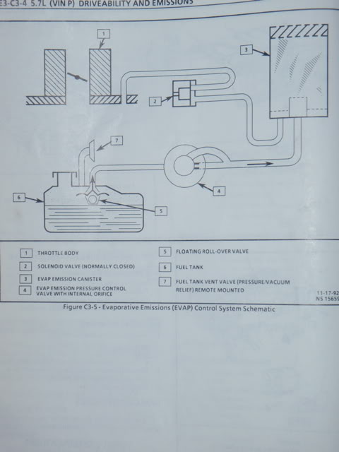

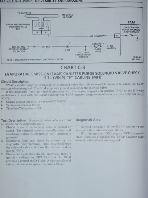

Posts: 22,022
check your gas cap and evap

Old May 5, 2010 | 08:05 PM
BigCat2010's Avatar
Joined: Mar 2010
Posts: 99
From: Quakertown
thanks! I'll be using those tomorrow afternoon to check this stuff out...
