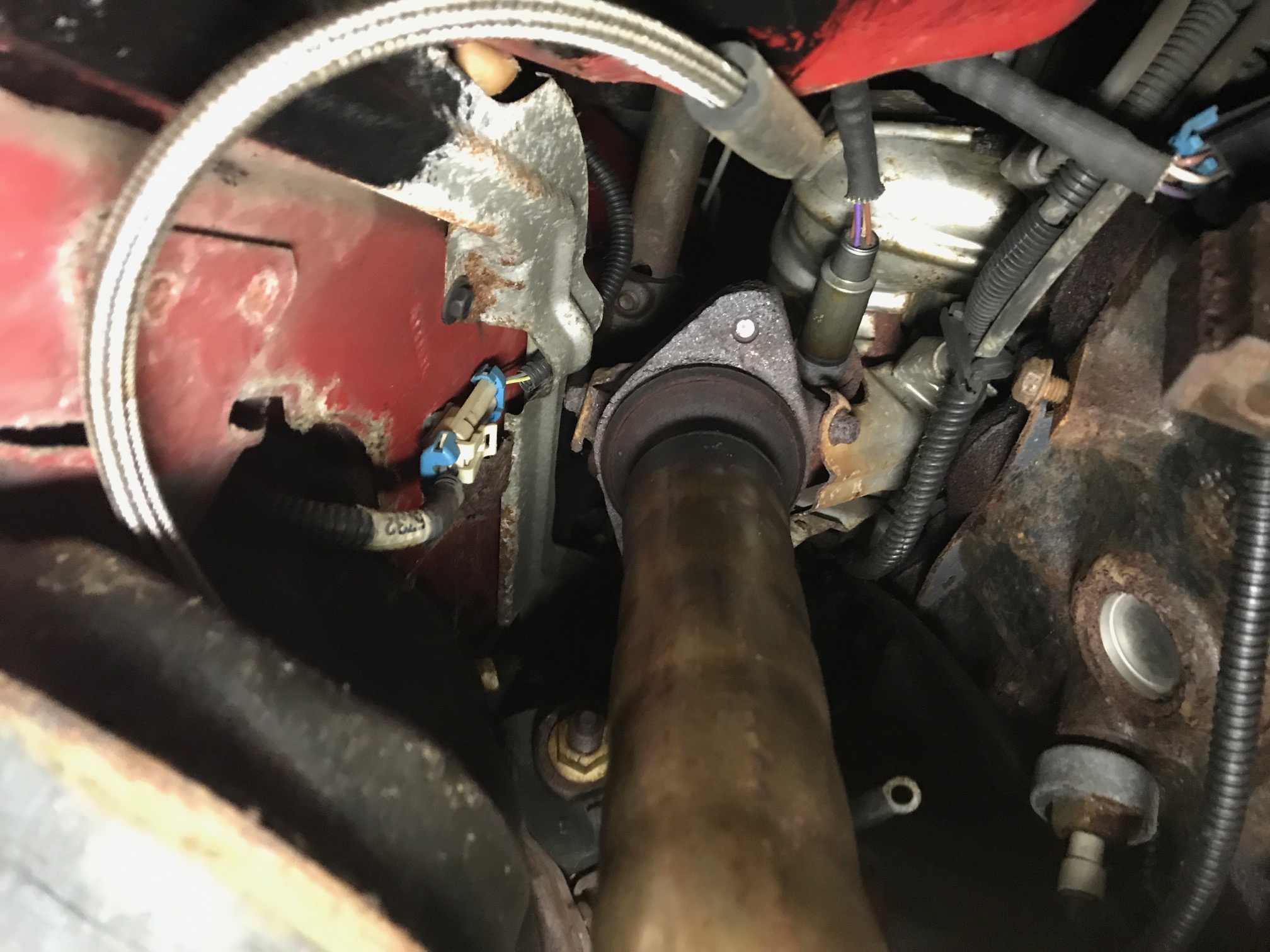

So I finally started this project with my son of replacing the slave cylinder and clutch. we did get the transmission out, which was a ***** because we could not unbolt the cat, and drop the engine a little, so we had to slide the transmission back, unbolt the bellhousing and remove the slave cylinder.
So clutch is in, new fly wheel, getting ready to install the transmission. I figured it may be difficult to put the transmission in the way it came out. So I thought if I removed the exhaust from the manifolds, I could drop the engine a bit with a jack and get a better angle to install the transmission. The bell housing has been reattached and we have the new slave cylinder in. My problem is even after 2 days of soaking, the bolts on the exhaust manifolds where it connects to the manifolds all broke off. That was the straw that broke the camels back. I now have 4 bolts to drill out and re thread.
Another problem is I cannot seem to get the exhaust pip off the manifold on the passenger side. Even though there is no bolt or flange holding it in place. what the hell could be holding it on?
I could use some advice at this point, any help would be appreciated.

Is there something binding the pipe in place? that type of joint should not rust together because every time you put a load on the engine that joint slips a little. Sometime if the exhaust bottomed out or was put together wrong the is a lot of stress in the exhaust pipe.
Do you have a plan on getting those bolts out? Spring loaded center punch. Left hand cobalt jobber drill and good extractor is a good investment. Many times the bolt come out as you are drilling. It is a combination of heat vibration and drill torque.

I pulled on the pipe, I've tapped the pipe with a hammer, I've heated the pipe, it doesn't seem to separate. My plan tomorrow is to get m drill in there and drill out the bolts. Then retap them. it will be a task I'm sure. I looked on the back side and those bolts looked welded in with rust.

pictures please, much better to get idea of whats going on if we can see it. sounds like a bracket/bolt is still on the exhaust manifold or its welded in place by the hangers. yah the exhaust bolts like to break.

check the exhaust for play, the whole exhaust may be jammed up tight to the front and is not letting it out. hangers welded to pipe and body would be another way it would jam
