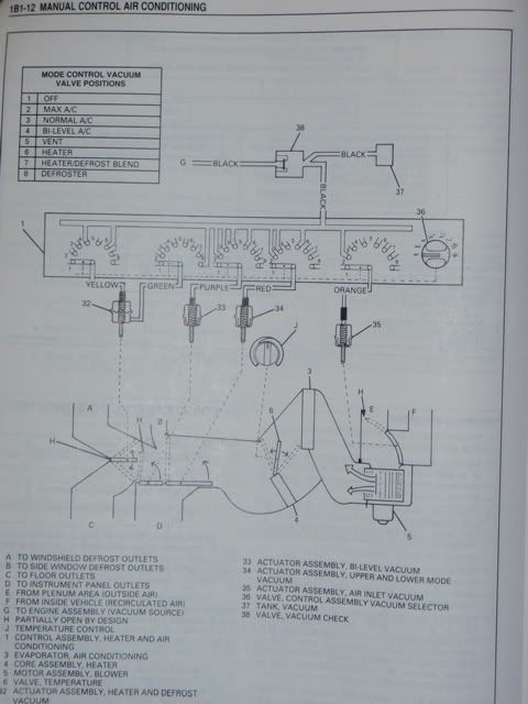

yep its either the cable or the core. see if any of this helps. most times a flush of the core with the garden hose will do it.

Do you take these photos from the manuals yourself?
Old Nov 12, 2010 | 11:21 AM
Posts: 22,023
lol yah im not a good photographer
