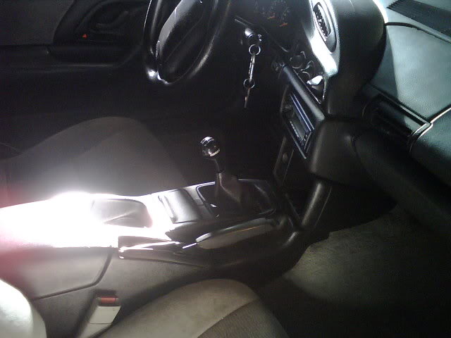

I have the older style Hurst shifter. I got it off ebay in 09. I do not think they still make them. The new design has the round shaft all the way up.
Don't confuse short throw with short shifter. I have a short throw which sit at the same height as stock. It just has a shorter distance to travel when shifting 1st-2nd. The nest step would be at add a shorty shift to the short throw.
Best thing about the after markets is the have built in stops so if shift to hard/fast you slam the stop in the shifter not the shifting rods or the fork.
