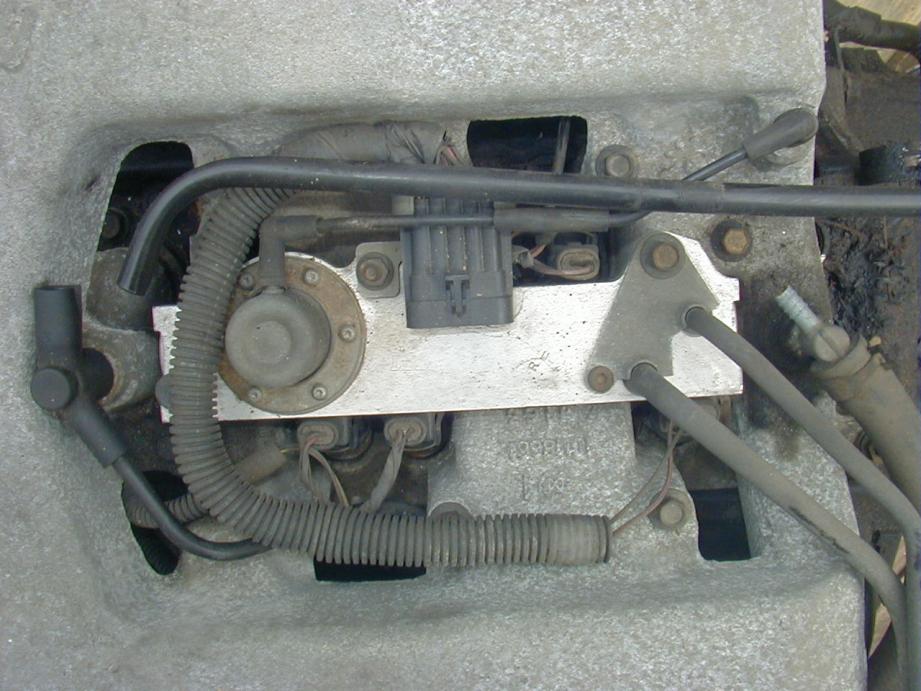

This pic shows all the vacuum ports on the upper intake manifold.
I can see how a mechanic could screw up the one at the front while doing a fuel pressure regulator. That black "T" is kind of thin and easy to split if you look at it funny.
I don't see how he could screw up the one at the very back, though. Time for a new mechanic?
The nipple at the back is the vacuum connection to the body harness; vacuum operates the HVAC system flaps.

I have a 1998 3.8 liter Engine.... My setup doesnt look like that... Do you have a picture of it
